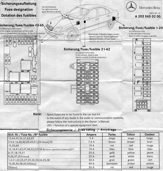

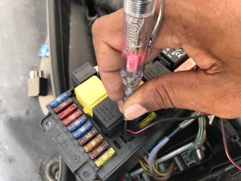

Won't Crank and Start so I checked all the fuses and relays no blown fuses and relays
But I found there is no power on fuse #52 (start enable) 20A fuse located under the hood
Please assist me to solve the problem?

6 years 10 months ago #29530 by jreardon
Replied by jreardon on topic Mercedes Benz C Class C240
imgur.com/a/IQ7pqUD
In the crank position is Fuse 52 hot?
In the crank position are any of the fuses #48, #47,#49 or #46, hot?
Do your wipers work? (fed from fuse #46)

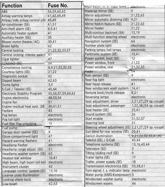

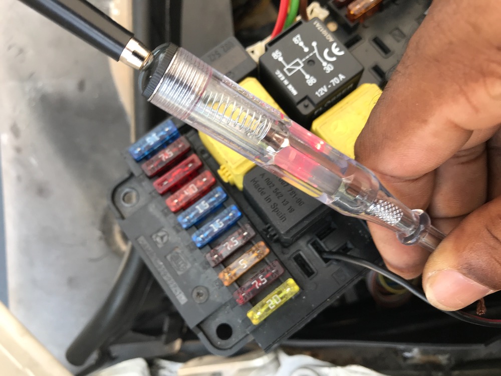

Here is fuses listed
Fuse 52 is Start Enable (no current in positive side pin)
Fuse 48 is Engine Electronics (working have current)
Fuse 47 (working have current)
Fuse 49 (working have current)
Fuse 46 is windscreen wiper it has current but viper is not working
And no fuses are hot
Fuse 58 (transmission electronic) also have no current in positive side pin
*when key is on fan start running

Forgive my poor choice of the word "hot." I should have wrote, do you have power at both sides of the fuse.
Your result that all those fuses have current (Did you mean power? If you measured current that's fine, you can't have current flow without power) suggests to me that the Circuit Opening Relay has control and the relay is functional.

Yes I mean power
But Fuse 52 and 58 had no power on any side and all the other fuses have power on both side , All the relays are checked and working

You swapped the fuse or starter relay? Fuse 52 won't have power on either side because the starter relay coil is not being energized by the SAM module (whatever that is). Either that, or the relay is defective.
Can you feel the starter relay click?
Last edit: 6 years 10 months ago by jreardon.

No click sound from Starter relay and it’s not energized
starter relay positive terminal has no power
But ground terminal is ok
