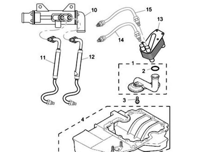

These engines aren't prone to bearing problems, one possibility is the oil pick-up tube in the sump is either drawing air at its' o ring seal or its' mesh filter is gummed up.

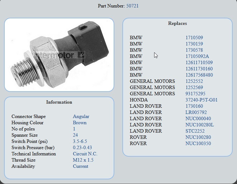

9 years 10 months ago #3871 by Andy.MacFadyen
Replied by Andy.MacFadyen on topic Oil pressure
It looks like the oil pressure switch out of spec

9 years 10 months ago #4014 by Carstuff
Replied by Carstuff on topic Oil pressure
I dropped the pan and the screen was almost clogged . There was some gunk in there. Cleaned the pan and screen and the pressure hasn't improved. Same 10.2psi on guage.
9 years 10 months ago #4022 by Andy.MacFadyen
The switch specification is 3.5 to 6.5 PSI ---- new switch required
