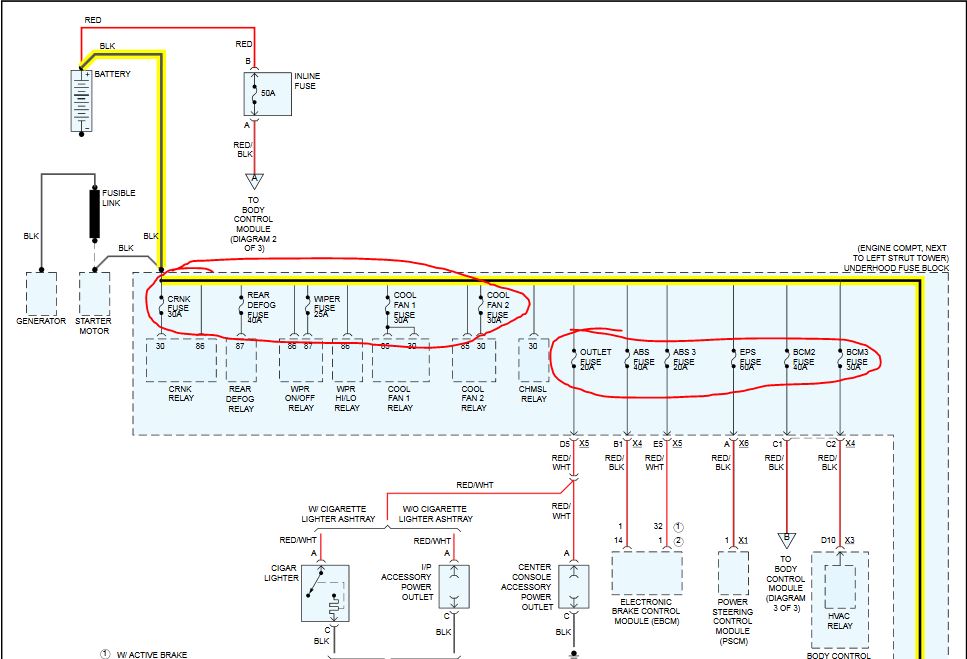

Had A 2009 Cobalt brought in for timing chain and ignition issue.
Replaced Timing chain. Original Key broke off inside ignition so replaced the complete Ignition not just tumbler and programmed new key.
Still have a crank no start tested all relays and fuses have spark have fuel spark does seem weak but main issue I am having trouble with is with my scan tool hooked up to read codes but when I go to live data if i crank the engine i lose power to obd2 port and have to release the key back to on position to reconnect I have checked all relays fuses inside and out and also grounds on engine all seem tight and not broken what can cause a obd2 port to lose power only when cranking engine also tach does not move during cranking so main reason wanting to view live data is to see if rpm is moving any suggestions
ALSO lose power to cig lighter during cranking as well so am I missing looking for bad ground someplace ?

Do you lose power on all of these fuses?
  • erieadams
  • erieadams's Avatar Topic Author
7 years 5 months ago #29449 by erieadams
Replied by erieadams on topic 2009 Cobalt 2.2 Ecotech Crank No start
yes it does wipers rear defrost radio aux outlet
  • erieadams
7 years 5 months ago #29450 by erieadams
yes I lose power to those only in crank position

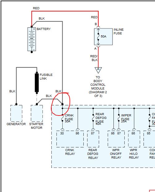

7 years 5 months ago - 7 years 5 months ago #29487 by Chad
Replied by Chad on topic 2009 Cobalt 2.2 Ecotech Crank No start
I would look at this splice, very closely.
Also, with the Negative Lead of your DVOM connected to Battery (-), touch the Red Lead to the Engine block while you are cranking. What voltage do you read? Touch the Red Lead to the Body, while cranking. What voltage to you read?
Last edit: 7 years 5 months ago by Chad.
  • erieadams
7 years 5 months ago #29496 by erieadams
while cranking with no charger voltage drops from 12.5 to 10ish at battery and at post by fuse block I also ran jumper cables from battery to fuse block and to ground on shock tower with no difference where exactly would that splice be you circled
7 years 5 months ago - 7 years 5 months ago #29499 by Chad
Did you read the voltage on the engine block, while cranking. I know this sounds funny. :blink: You wouldn't expect to ready ANY voltage on the engine block. But, If you have a bad engine ground, voltage cannot make it back to the battery. You WILL read voltage on engine block, with a bad engine ground. Same thing goes for the body.
You'll have to follow the cable from the batter (+). I assume it will be very close to, or at, the fuse box. All I can say, for sure, is "Between the fuses and the battery. :huh:

7 years 5 months ago #29504 by Chad
Well, that leaves us at that splice/junction.
7 years 5 months ago #29505 by Chad
Trace the cable FROM the BATTERY and the cable FROM the STARTER. Find where they meet.
