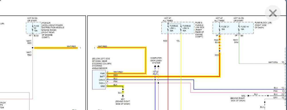

Dear team
Plz advice how to check steering angle sensor
The code is steering sensor angle circut and steering angle senor safe c1163 and c1143
How to check befor calling the angle sensor is bad
Live data show 0°
VDC light is coming on
With code p1856 VDC System in diff lock Control unite
Nissan xterra 2009
Plz how to check the sensore and the wiring
Thanks

Check for good power and ground at the sensor. This diagram shows PINS 2 and 8 should have power. PIN 1 should be ground.

another test you need to do is after you check power and ground. unhook battery check resistance across canh and can l should be close to 60 ohms. if thats good to replace sensor
