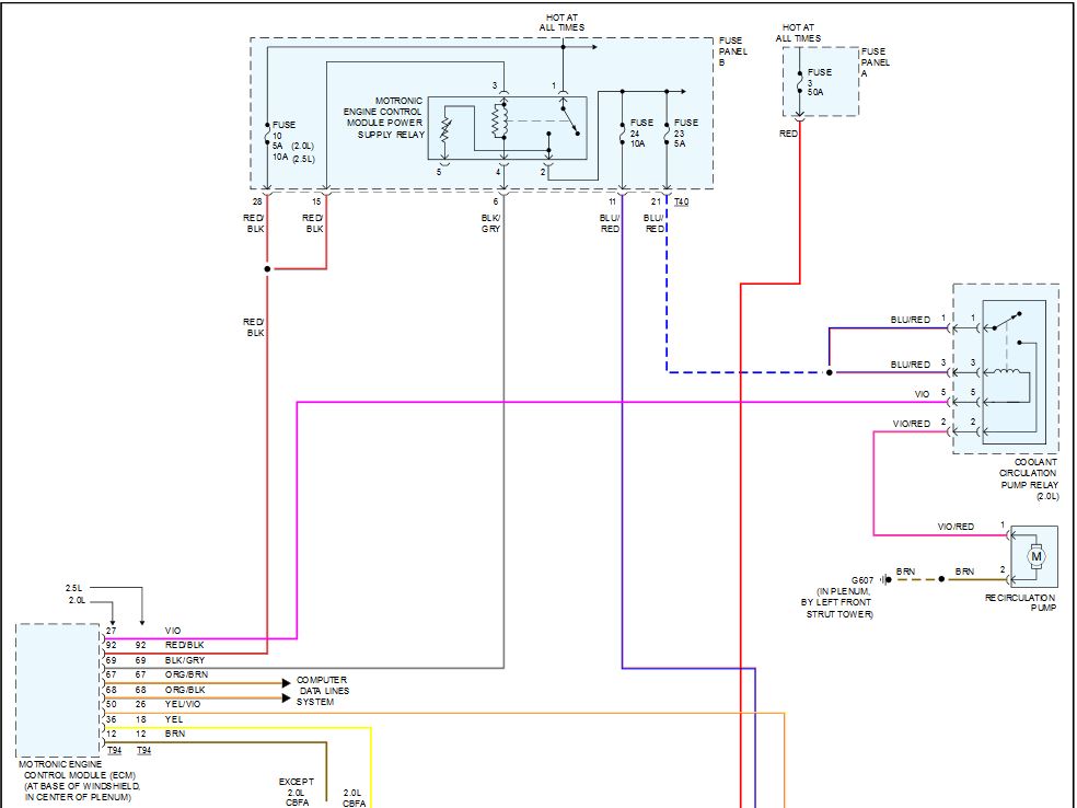

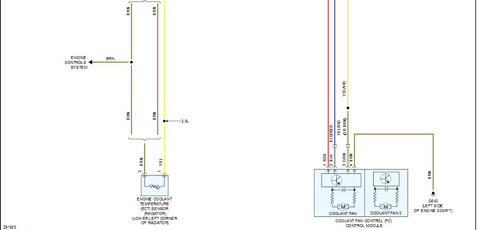

With this code I would check the connection to the cooling fan.
When you say you supplied power to the fan was that both power and ground? or just ground?
According to the wiring diagrams there are 4 wires that run to it.
Yellow/Violet = ECM should
Blue/Red = 10A fuse 24 on panel B which also runs to a relay back to ECM relay
Red = 50A fuse 3 panel A
Check all 3 of the above for voltage using the brown wire as your ground in the 4 pin connector. The Yellow/Violet wire should be checked with the engine warmed up. Then check the above 3 wires with a good known ground.
Brown = ground
Brown = ground

hi sir I may be wrong I looked at code definition if its low all I know is to bring it high(apply voltage) the fact it is not coming on I would monitor ect input and watch for fan to come on at right temp and test driver for control circuit operation sound like something fried your driver
