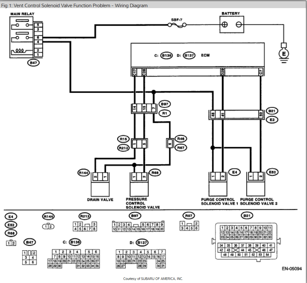

9 years 11 months ago - 9 years 11 months ago #3596 by cheryl hartkorn
does anybody know where the vent valve lives at?? I am not familiar with subarus at all. also a wiring diagram would be nice to thanlks!

9 years 11 months ago #3604 by Chad
Vent Control schematic

9 years 11 months ago #3608 by Noah
pole71 wrote: Vent Control schematic
Thanks!
So, while the code definition is: VENT CONTROL SOLENOID VALVE FUNCTION PROBLEM, the associated diagram and troubleshooting info refers to the drain valve, as pictured in the diagram pole71 posted.
It says to check for other codes, check the drain hose for a blockage and then check the functionality of the drain valve
Do you have any bidirectional control of this solenoid with your scanner?

9 years 11 months ago #3611 by Noah
Well, the drain valve is located on the cannister, so it shouldn't be too hard to test.

9 years 11 months ago #3636 by cheryl hartkorn
Replied by cheryl hartkorn on topic 2007 subara legacy 2.5 liter non turbo p1443
found the drain valve its a part of the canister and non serviceable separate. I put the vehicle in test mode connecting the connector under the dash where it will cycle all the solenoids on the vehicle. had power to the solenoid. but no a control at the solenoid. tested it at the pcm no control replaced pcm from junkyard same result.

9 years 11 months ago #3672 by cheryl hartkorn
connected the connector under the dash it supposedly turns all the solenoids on and off on the car. had no control to the vent valve a.ka. drain valve. checked it at the pcm still nothing. guy runs to get a used pcm from the yard. still didn't have control had a pushed on terminal in the harness barely barely noticeable. he got the wrong pcm it was for an automatic car when we had a manual. so he returned it I fixed the terminal in the harness now have control to the drain valve. it was an auction car
