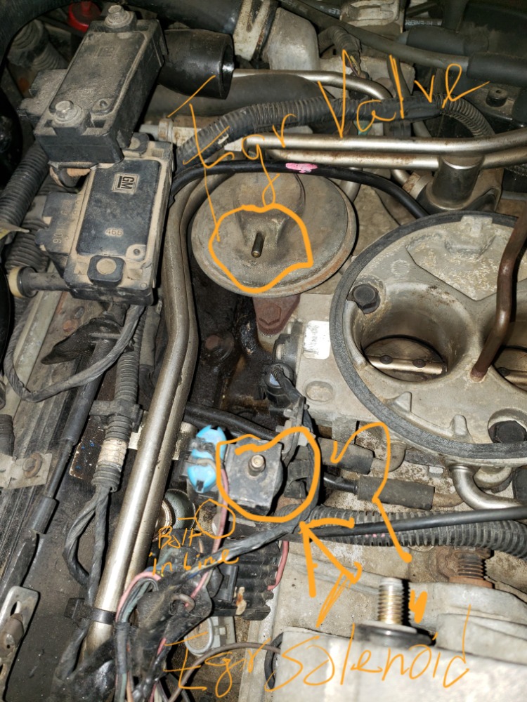

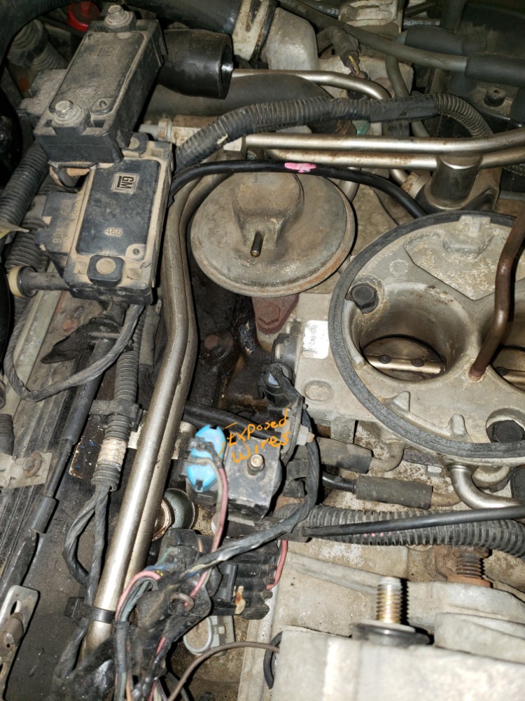

7 years 3 weeks ago #27805 by Dtnel

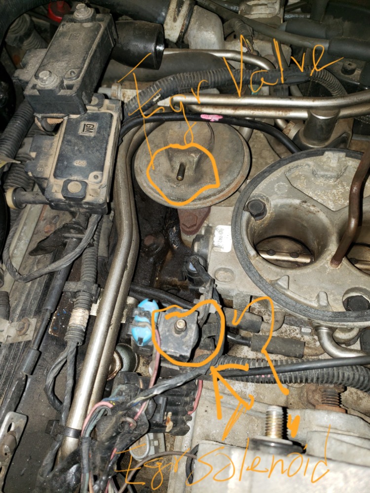

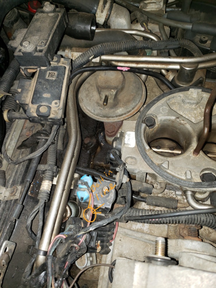

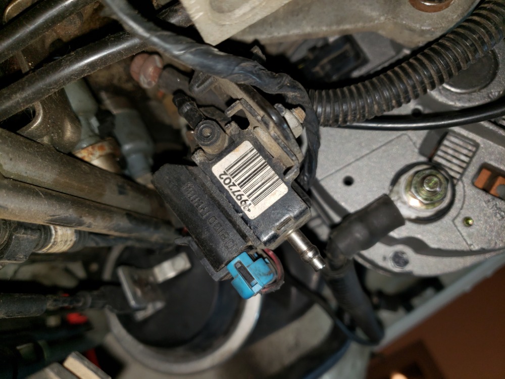

This Deville has the 4.9 Engine, it's not the Northstar engine.
Runs rough the more you accelerate according to my friend who's been driving it as it's his older mother's car a shop put all new injectors in recently but I don't get their reasoning except either $$$ or the parts cannon as I was looking at it less than 5 minutes and noticed the EGR and EGR solenoid appeared to have had a line in the past that went to them, maybe from the solenoid to the valve?
On these engines is there a way to use a vacuum pump to test the EGR valve? I haven't did EGR work thus far but I do have a vacuum pump with gauge, multimeter and labscope. I'm sure there's got to be a way to check the electrical on the solenoid and check the EGR valve test wise and visual inspection?
The guy did say there's a strong odor of gas as well and the higher the speed the more it seems to stumble when it does. I briefly looked at this one a year or so ago but then the vehicle was gone as he got another one to drive but I don't think that'll be the case this time as on his Ford Ranger he cracked the number 3 piston which they tried to tell me he needed a starter replacement on but I found the starter was operating just fine after removing and bench testing it and back on the vehicle as well.
Also there's another line, maybe vacuum type or something that goes 4-5 inches and has a bolt in it and does nowhere.
I will add photos as those are the best evidence. I haven't pulled any codes yet as he was so sure he wanted his alternator replaced and his blower motor that he went and bought the parts and they were there. He was even pissed enough that he took a drill and drilled a 3/16 hole right into the blower motor back side because he was pissed that it quit working. I don't understand some people's logic but this is a special type of person so I just go with the flow at times as I'm just trying to help a friend out and sometimes he realizes that he screwed up we will see once I get the vehicle running again as I change the alternator already and I'm winning to get this blower motor wrapped up. In the meantime while doing the blower motor I noticed these other things I was also doing alternator when I noticed them as well.
Please see the attached pictures and you will see what I am referring to.
Oh, I might want to add I pulled the dipstick for the oil and there's no oil level reading but he does want me to change the oil on it so I'm thinking about pulling the plug for him because I'm curious to see what I will find inside the drain pan. It's kind of like that mystery meat you get at McDonald's or Arby's and you just kind of wonder about.

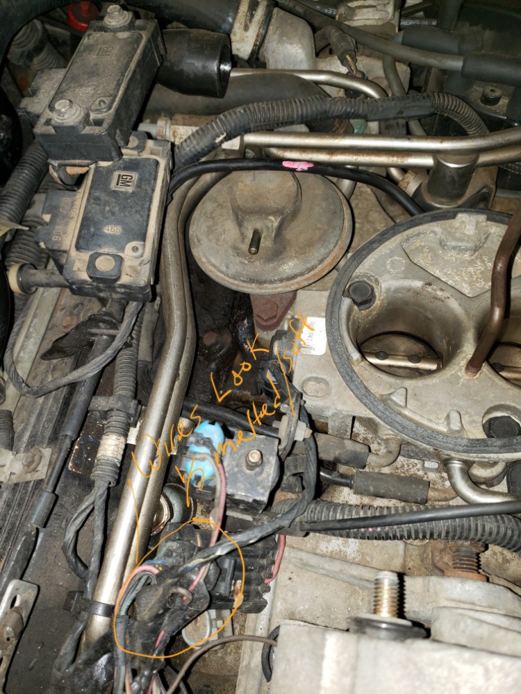

I've also read some of these issues could be related to the TPS - Throttle Position Sensor? IF so does anyone have the GM/Cadillac test procedure.
It's been hit and miss with doing diagnostic stuff lately so if the component tester portion of my scan tool has these testsI need to figure out if I can use the Wireless scan module as the OBD port is in the middle just above the floorboard in the hump.
I do have a 90 degree adapter that can plug in but also when I look the vehicle up it shows that I need the OBD 1 GM powered adapter that you'd normally use for reading from a OBD 1 port and I was worried that if I plug the compact scan module with the 12 volt OBD powered adapter that it could damage the compact scan module?? Don't want to ruin a $1800 scan adapter and snap on tell me I broke it.
I don't have any hard wired scan tools. I only have the Autel TS-608 and the Snap-OnZeus which I'm slowly slowly learning the Zeus when I can but that's hit-and-miss as I have other things going on in life as well and this is more so hobby stuff.
I do have a Pico scope but that's still sitting brand new in the box one and a half years as I never got it out and got it set up as I want to dedicate one laptop to that with a dual boot hard drive that way if I go to t i s web there's no compatibility issues with Windows 7. I'm giving some of that some forethought for setting up the laptop to save further work when I add other things to try such as either a Dongle for drew tech or a J-Box which I'd eventually line to learn as well. Yes I have a lot on my plate they want to learn.
I'm thinking I need to give up coaching softball that way I can focus on little things like this but that will have to wait one to two years as I just committed to this upcoming season and if the girls stay I told them I will Coach one more year and after that I will be done after seven or eight years of coaching.
If anybody has any information the TPS or the above post that would be greatly appreciated and I thank you in advance.
This vehicle has been a pain in the butt and I don't understand why a shop with throw 8 injectors in the vehicle when I'm finding all this other crap wrong with it including a ground from the engine valve cover hold down Bolt 2 the firewall next to the blower motor that they use a household electrical twist connector to join the wires.
I will be pulling that off later as well as I want to make it a good connection but also I don't understand why they did that because when I change the alternator there's a very good ground from the alternator melt to two different areas on the engine and it is in very good shape and intact
7 years 3 weeks ago #27830 by wacoeagle
EGR probably disconnected because its bad., if its leaking air into the engine could be a problem . you can take it off and make a block off plate out of an aluminum can to seal it off. ... those melted looking wires might go to the coolant temp sensor, if the coolant temp sensor thinks the engine is running cold it gives too much fuel!!! look for any vacuum leaks you can find and fix them. a coolant thermostat sticking open can fool the coolant sensor too.
carburetor clean those throttle butter flies.
