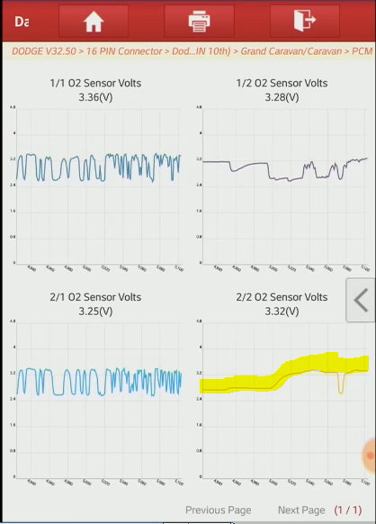

Hi all.
Working on 2014 Dodge Caravan 3.6l flex fuel.
I am trying to verify if anyone seen this and its normal and why?
Randomly one of the downstream o2s will go lean. It has done it while driving or parked and idling.
One smog tech explained it, it was due to different fuel/air mixture. But why don't the upstream o2 sensors show lean?? Another smog tech said it could be the PCM playing with the signals during testing. IF this is true, the PCM must be partially grounding pulling down the signal. The DVM on signal wire matches the scantool.
Trying to make sense of it. Perhaps its why O2 sensor monitor won't set.
I made a video about it.
Thank you in advance.
Last edit: 7 years 7 months ago by Flywheelz.

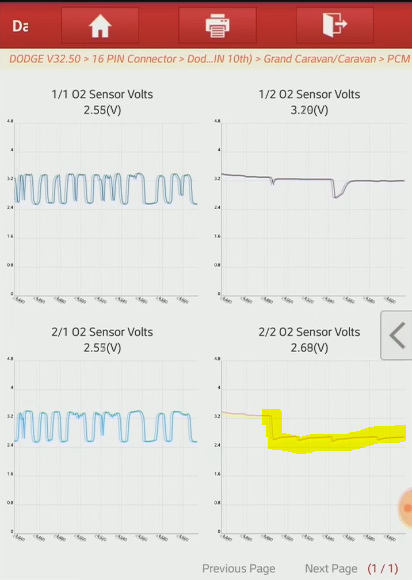

Actually I have seen it do this on both banks. I've even seen both banks go low downstream at the same time. I had a shop smoke test the whole exhaust. I told them to look for a pin size hole around the cats, they didn't find any. Looked at the fuel trims, they are +-5%. Looked at Cams and they are within +-2 degrees of desired. I might be overlooking something.

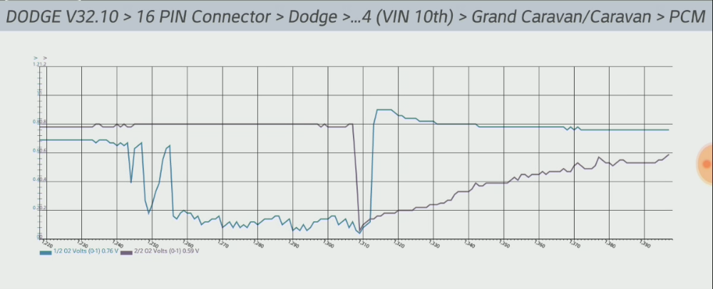

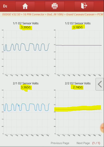

Here are few more captures. Have you seen something like this?
Just got off the highway. Been sitting idling for about 5 mins. Then the B1S2 goes low. I waited about 1 minute and tapped the throttle gently (~1500rpms) and the banks flipped. Now B1S2 went high and B2S2 dropped low. Idled for few more minutes and we can see B2S2 gradually climbed high.

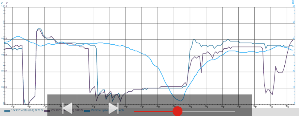

Here I was driving ~40mph, decelled to ~35mph, drove at that speed a little and gently came to a stop. We can see downstream o2s on both banks drop low with slight delay between the two.
Blue trace = Speed
Teal trace = B1S2
Purple trace = B2S2
