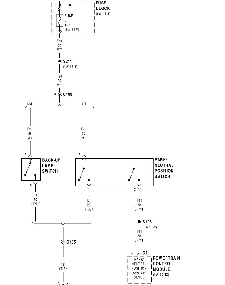

Can anyone help me understand how this relay coil is being grounded?
I think the Park/Neutral switch is a pull-down switch input. The switch provides a ground for the relay coil, while also pulling the voltage down from the PCM?
1998 Dodge Neon.

I see a feed from the fuse box to the park/neutral switch. The switch on the right goes to splice 106 which goes to pcm and relay. So we'd think this is a power feed.
Is there any chance of a page that's missing? Especially on the relay :huh:
Don't get me wrong I understand what you mean.

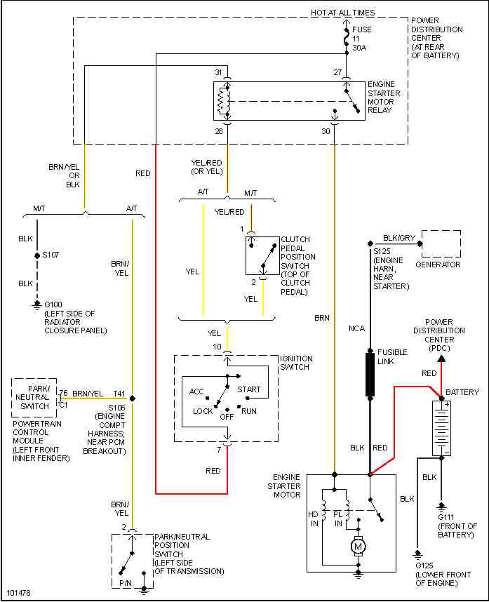

Yeah, that is kinda confusing, huh? I found this version of the diagram, makes things a bit clearer:
The park/neutral switch is definitely the ground in this circuit, but I think the PCM is simply monitoring voltage for it's own purposes. I would be surprised if the PCM was actually providing any voltage in this case, just an output state monitor.

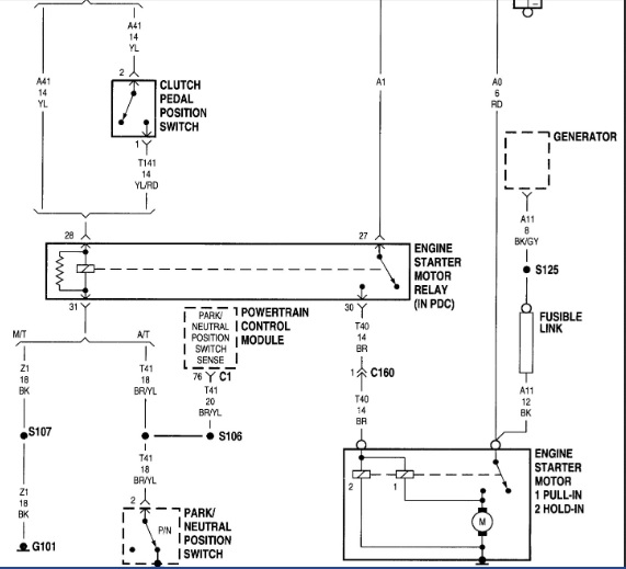

The park/neutral switch grounds the relay and the switch provides an input to the PCM to indicate whether the transmission is in park/neutral, or drive .
this input is used to determine idle speed (varying with geat selection) and ignition timing advance.
the park/neutral switch is also used to cancel vehicle speed control.
here is a better diagram that shows the ground point at the very bottom of the park/neutral switch!
