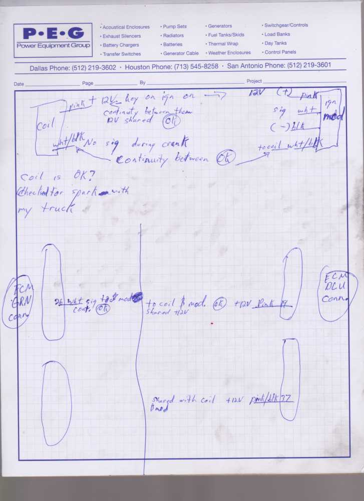

Trying to be a good neighbor and friend, I took on my neighbor's truck in after a few other things that have been done to it and have been unsuccessful. I'll upload my notes since most is explained there but here is an overall picture.
Crank no start with a hard P0315. Came in with new (remanf) ECM and I am trying to do the learning procedure per the ECM company and no good results. Their initial procedure is install ECM, connect battery, crank for a few secs until security light comes on, leave key on for 20 min, turn off for 1 min, crank again until light comes on again, leave key on for another 20min, repeat process 4 to 6 times and in should be ok. Erase any DTC's and done.
Followed the procedure, used my timer app on phone to come back to truck accordingly and did this a few other times. I found another procedure for similar GMC vehicles and it goes like this, crank and security light should come on, leave key on for 11, turn off for 30 sec, key on for another 11min, repeat 5 times, last time key is on the security light should turn off and crank to start. Erase DTC's and you should be good to go. NO good results either.
I called the ECM company; I talked to a technical advisor and he sounded a little upset that I walked away during the 20min count down but yet I think I followed procedure with the stopwatch. He advised, ignore our handout, ignore the 20min and stay with the truck 100% during process. They issued a new ECM because I mentioned the security light will not turn off at all now. He mentioned it went into safe mode and locked itself out. Do their same process but turn key off right after security light turns off, leave off for 30 min, and repeat 4 to 6 times and this should fix it. He mentioned there is a 15 sec window to turn key off after the security light turns off. Did this word per word and no good result.
All this time I am doubting the previous fix and see DTC P0315. I start diagnose and the rest is in my notes. Please advise..
Tools at my disposal to diagnose, average scanner, test light, multimeter, and any hand tool needed for the job. I work out of my garage and mainly do work for all my vehicles and a friend or two. I never take on a repair job for money; I don't like to. I like to keep this as a hobie but this one is really kicking my butt.
Thank You Ahead of time.

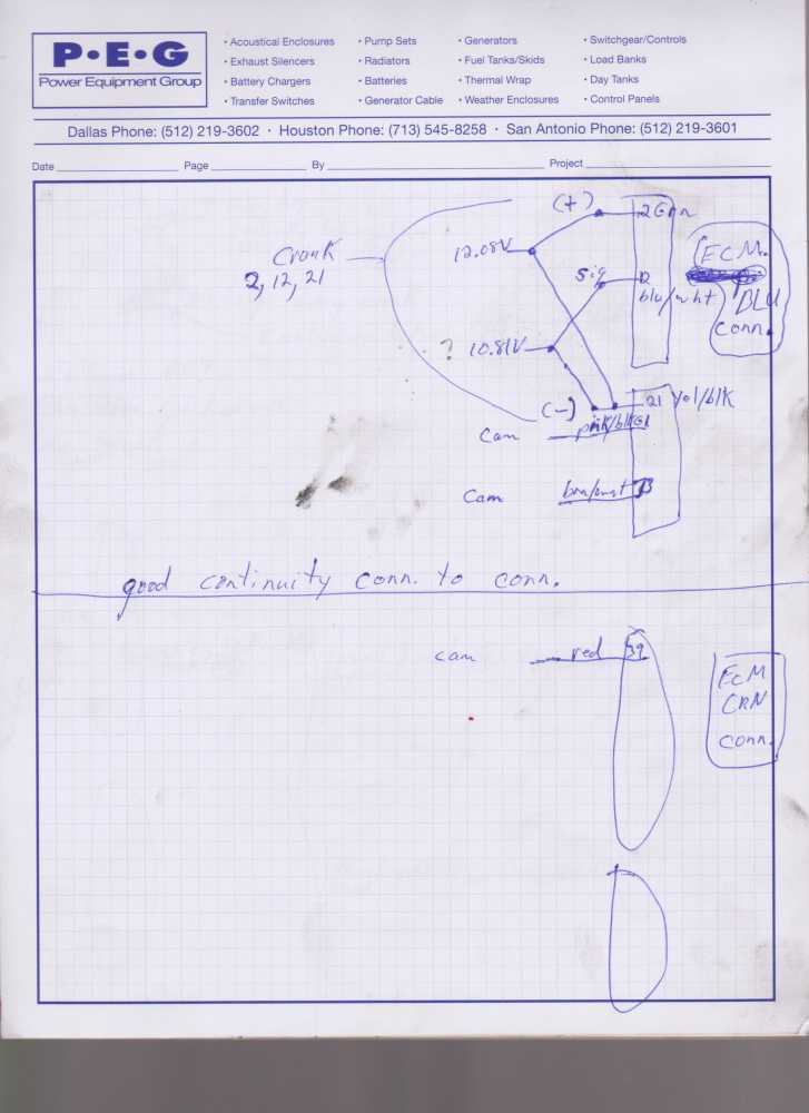

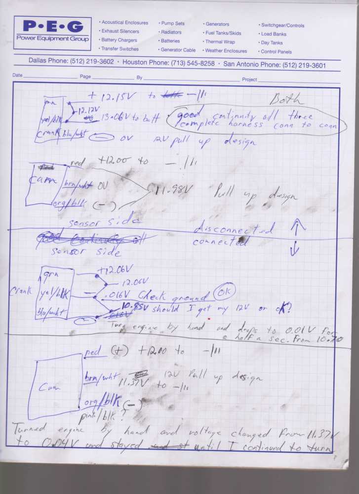

See my results from the CPS. Since I don't have an oscilloscope or I can't graph my outputs, I turn the engine manually and monitor the outputs. I should see voltage drops to 0V three times in 360deg. I do but only for a split second. I know the window is not small. I rotate to the next window and I leave it there to see if the voltage will stay at 0V. It doesn't; it goes back up in a split second. I was curious, so I removed the CPS and at first glance I noticed some rubbing on it. I continue to connect directly to the battery with jumpers to monitor voltage. It works as I think it should; It reads over 12V near metal and 0V as I move it away from metal but only for 5sec or so. It goes back up to 12V.
Is this normal to go back up to 12v even at the window? Do they have a built in switch with a small cap or something to keep it there for a split sec. IF so, was I only reading a split sec with the multimeter because I was helping with the discharge by adding a little more load while pluged in?
I'm concerned about the rubbing though. I fixed this with a few thin shims but I wonder if the crank is loose or maybe it was always like this.
I did check the cam as well and everything seemed good. Big difference is cam would stay at 0V all the time in the window. I tried the bypass as I monitored it to check for any engine reaction and there was none.
Does this model also use the cam to time the engine (ignition) or only CPS?

I understand that the P0315 is worrying, but I'd ignore it for now. You'll be able to complete the crank relearn procedure using a scanner later. That code won't cause a no start. Also, is that the only code you're getting? 'Cause I usually see P1626 Theft Deterrent Start Enable Signal Lost stored when there's an anti-theft concern.
Smart thinking by testing the crank sensor the way you did! I agree, the behavior is strange - the sensor should switch signals and stay switched the entire time it's near ferrous material. BUT, then how is there a reasonable RPM signal on the scanner?

Sorry I did forget to mention I did check my signal wire (white wire). I do have good continuity from module connector to ECM connector. I am not however, getting any signal. I guess it's the theft system keeping it from sparking. I did try to bypass with my test light connected to + and still not spark. Leads me to believe the module is bad, correct?
On the ECM side, it should be pin 26 on the green connector correct? It buzzes OK and no signs of short to ground.
So basically I might just be doing an incorrect relearn procedure.

Does this model rely on the cam sensor for position and/or firing? I think not because I try the bypass and no indication from anything clicking or turning on. Help is much appreciated.
New ECM just does not want to accept and I am also getting a P0351 in my pending DTC list.
