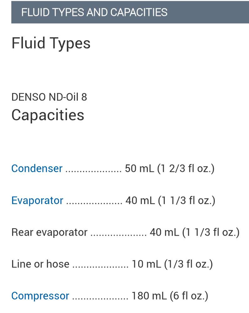

Hey how are you guys doing, I have to remove the ac compressor of a 2007 odyssey, and don’t know how much oil I have to add before recharging the system.

Most of the time, a new compressor comes with a full charge of PAG oil.
According to this chart in service information, the compressor holds 6fl oz of oil.
Hope this helps.
