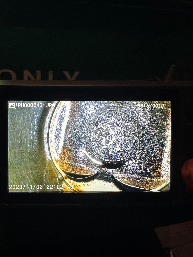

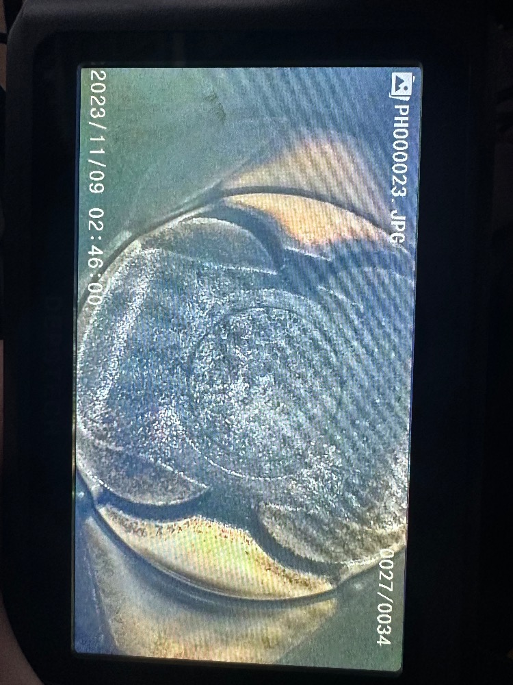

I’ve been dealing with a 2011 Toyota Camry with the 2.5L 4 cylinder. The car has an oil consumption problem - about 1 quart every 500-1000 miles. The car starts and idles perfectly fine.
The car began misfiring severely at 60+ mph with flashing check engine and traction control lights. If you let off the gas, once the light stops flashing, it behaves normally until you get to that 60 MPH mark again. The DTCs returned were P303 and P420. Spark plugs are fairly new, I’ve swapped coil packs to rule them out and just finished replacing injectors. Problem remains on cylinder 3 with new injectors however, now it is misfiring around 75MPH.
Compression test checked out good. All cylinders were at 210 PSI
Completed a leak down test on cylinder 3 and got virtually 0 leak at 100psi. Left cylinder pressurized for about 20 min with no change.
No back pressure on catalytic converters.
dropped exhaust to verify that cats weren’t clogged and noticed that they were actually gutted. Which would explain the P420 code.

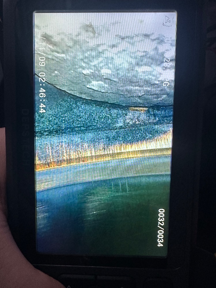

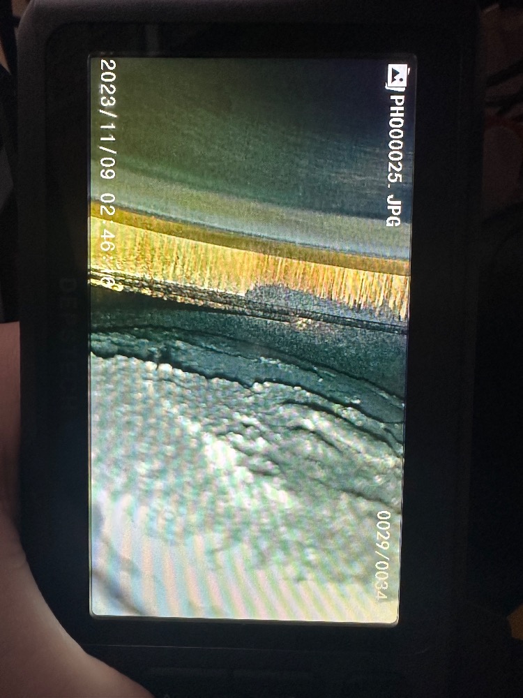

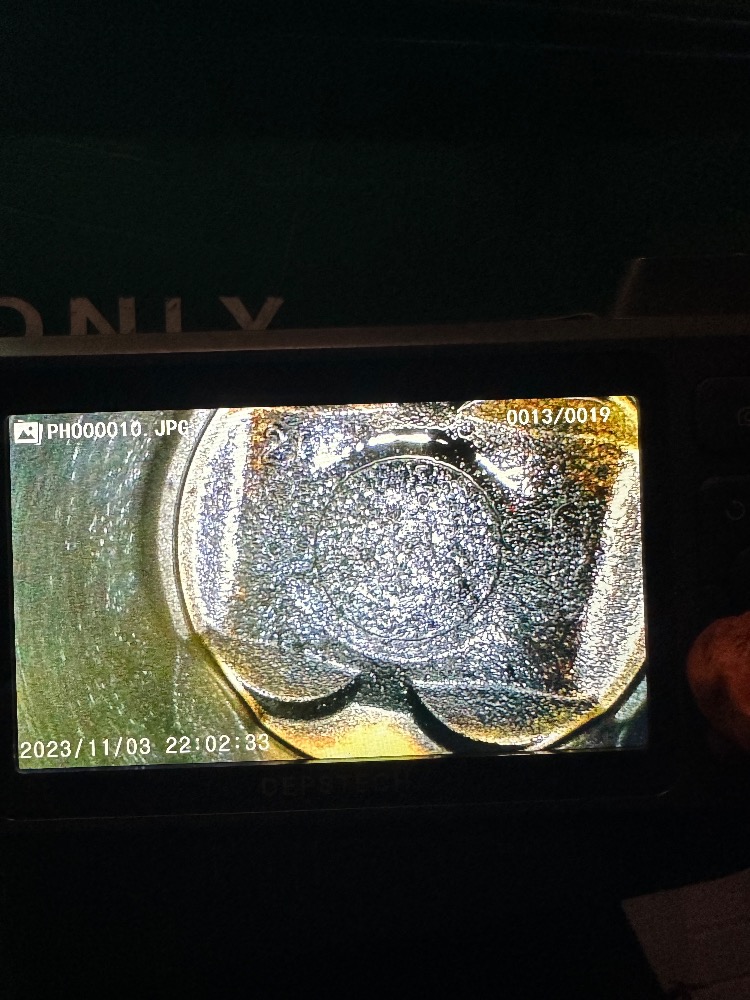

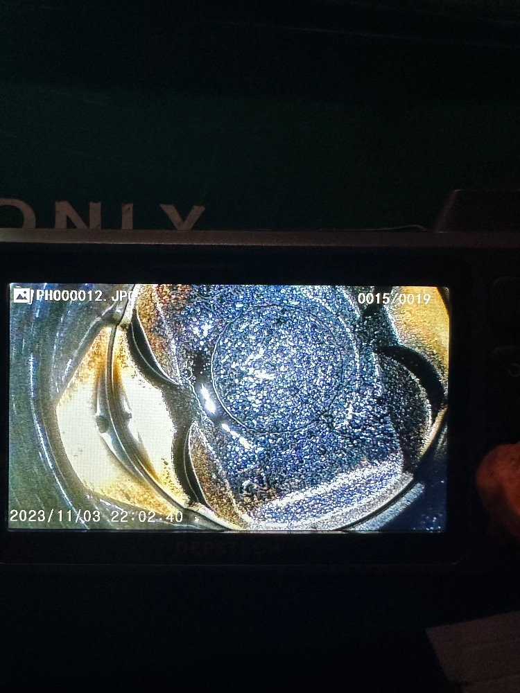

Stuck my borescope down into cylinder 3 and captured some images.
performed smoke tests and have found 0 leaks.
I believe this model has flaps on the intake manifold. Could the flap on cylinder 3 be faulty and cause this misfiring under higher load?
Is it valid to assume the oil consumption is occurring at higher engine loads and getting past the rings, specifically on that one cylinder? It’s there anything else I could possibly check to diagnose this misfire? Any PIDs I should monitor using my scanner or anything I should collect data on with a lab scope?

9 months 4 weeks ago #92500 by Noah
That sure looks to be an awful lot of oil in that cylinder. I imagine the plug must be continuously getting oil fowled.
I have never seen an intake runner issue cause a single cylinder misfire at any load, I am willing to bet the oil consumption is the root of the misfire.

9 months 4 weeks ago #92504 by Tyler
Tend to agree with Noah on the intake runner causing the miss. This particular intake runner setup has been pretty reliable over the years, in my experience. I can't really think of a way to pin that down short of intake removal.
Gonna disagree and say that, while the oil in the cylinder really is excessive, it's not causing the miss. I see these engines burning oil all the time - none of them miss at highway speeds because of it. Plus, your compression and leak down testing results are excellent.
How did the #3 plug look when compared to the others? I know you said the plug is new, but I'd be tempted to move it to another cylinder anyway.

9 months 3 weeks ago - 9 months 3 weeks ago #92506 by Cdume11
Thank you Noah! Thought it was a pretty alarming quantity as well! I will upload an image of the plugs I replaced when I first encountered the misfire. Surprisingly as bad as the were, the misfire was still only on cylinder #3

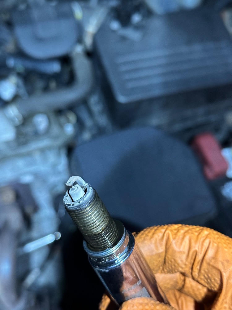

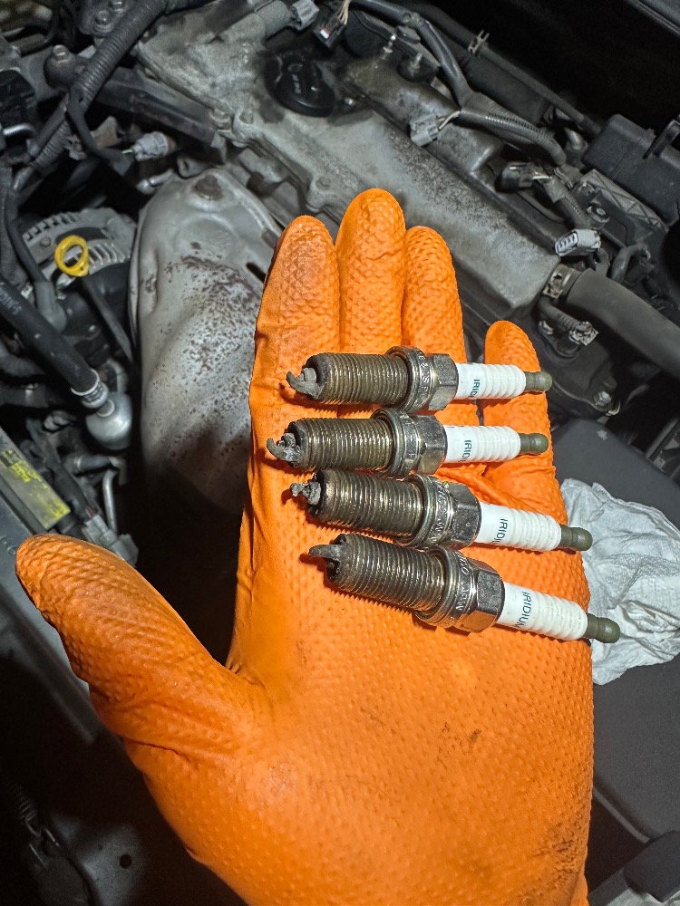

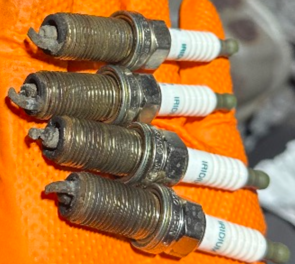

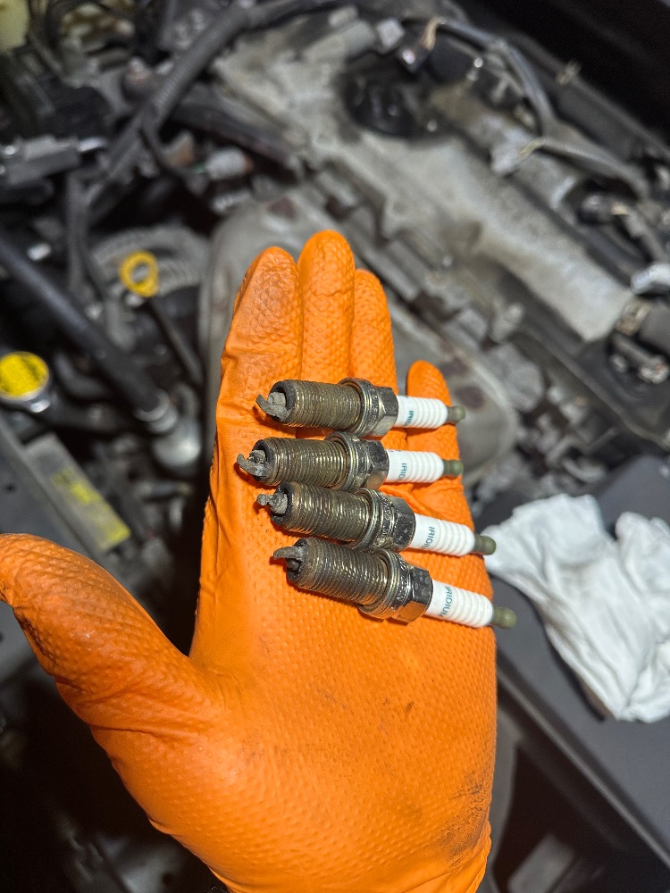

Plugs that were replaced!
9 months 3 weeks ago - 9 months 3 weeks ago #92512 by Tyler
Can we really rule out the excessive oil in the cylinder even though our tests aren't carried out under typical operating conditions when traveling at that 75 MPH mark?
Nope! Can't rule it out. Just haven't run into a Toyota that breathes enough oil to directly cause a miss. Yet.
Whoa! Those are crusty. Is the top plug missing the center electrode?
I know you're concerned about the #3 cylinder, but it really looks like all four are consuming oil.
When the misfire begins, there is a shaking/vibration felt immediately while the CEL flashes. I can't say I disagree or agree with a single cylinder miss, how would that differ from multiple cylinders missing?
OK that's good enough. I mostly just wanted to make sure that the ECM wasn't flagging ghost misfires.

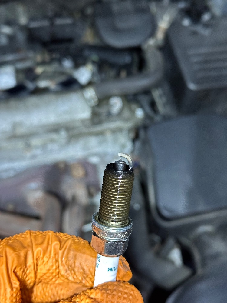

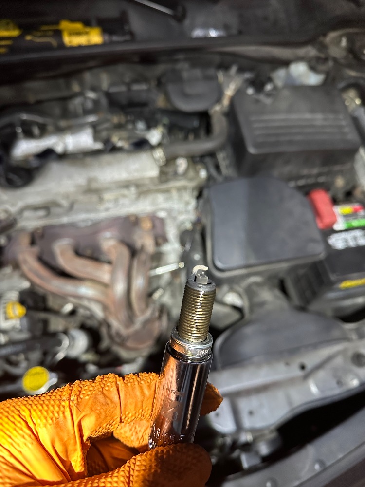

yeah they were all pretty crusty I was surprised it was able to run as good as it did with those in there. Electrode may or may not have been missing. They were so bad I didn’t even mess with them.
There is definitely oil consumption in all cylinders. I’m just trying to figure out if 3 is the worst of the bunch and thus causing the miss.

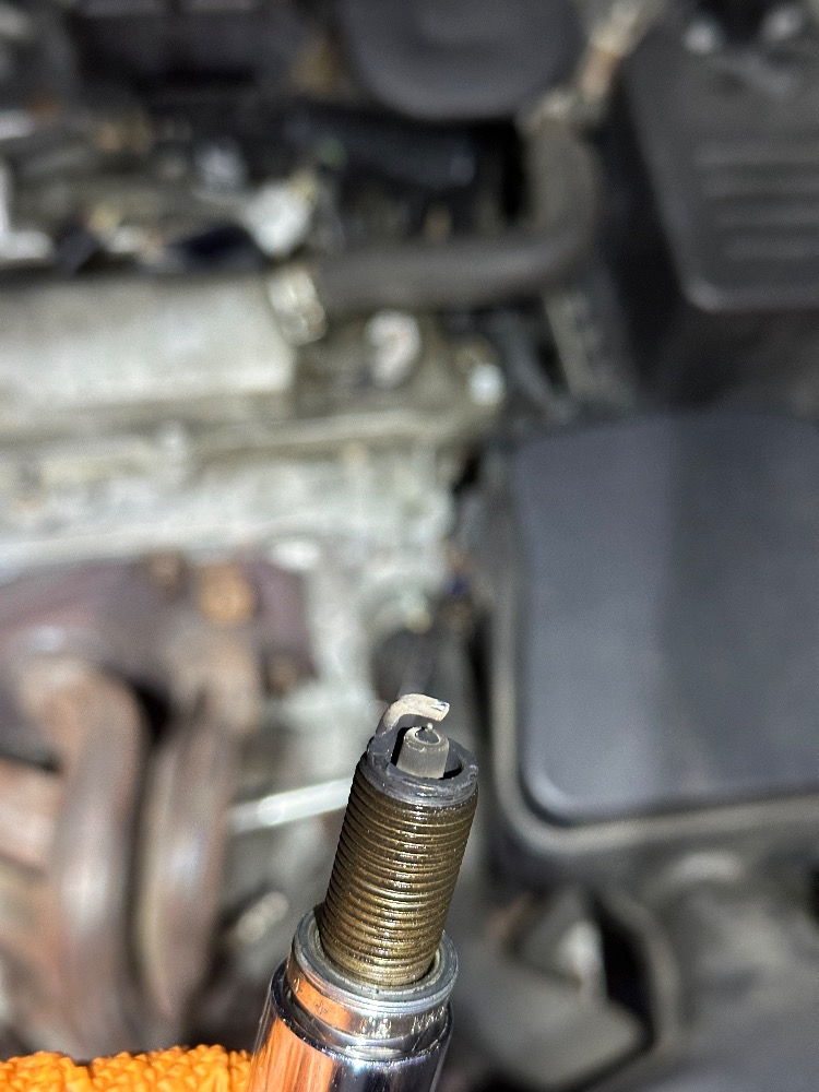

Sorry for answering everything all together. Fairly new to the forum, still haven’t figured out how to respond to individual sections of posts lol here is the current state of plug #3 (inside spark plug socket) and plug #2 (held by hand)

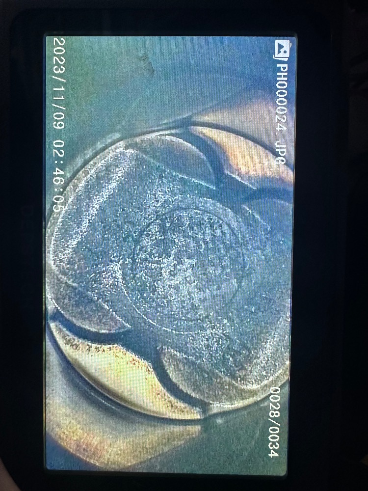

9 months 3 weeks ago #92517 by Cdume11

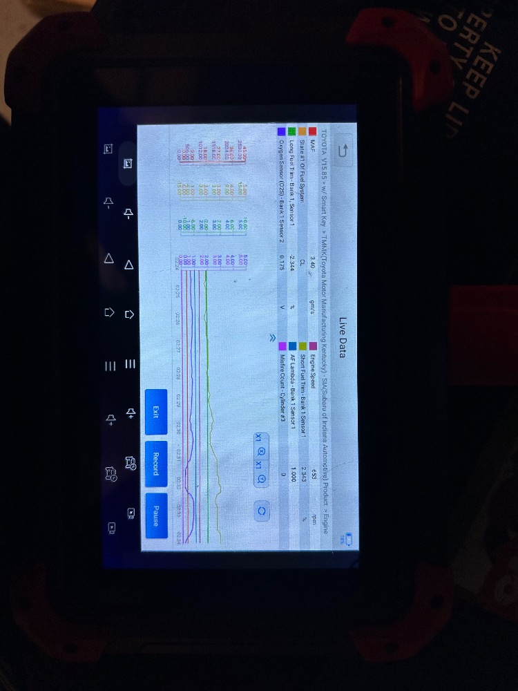

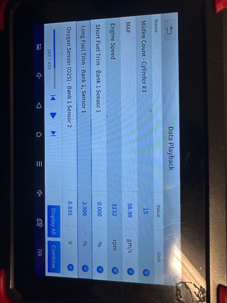

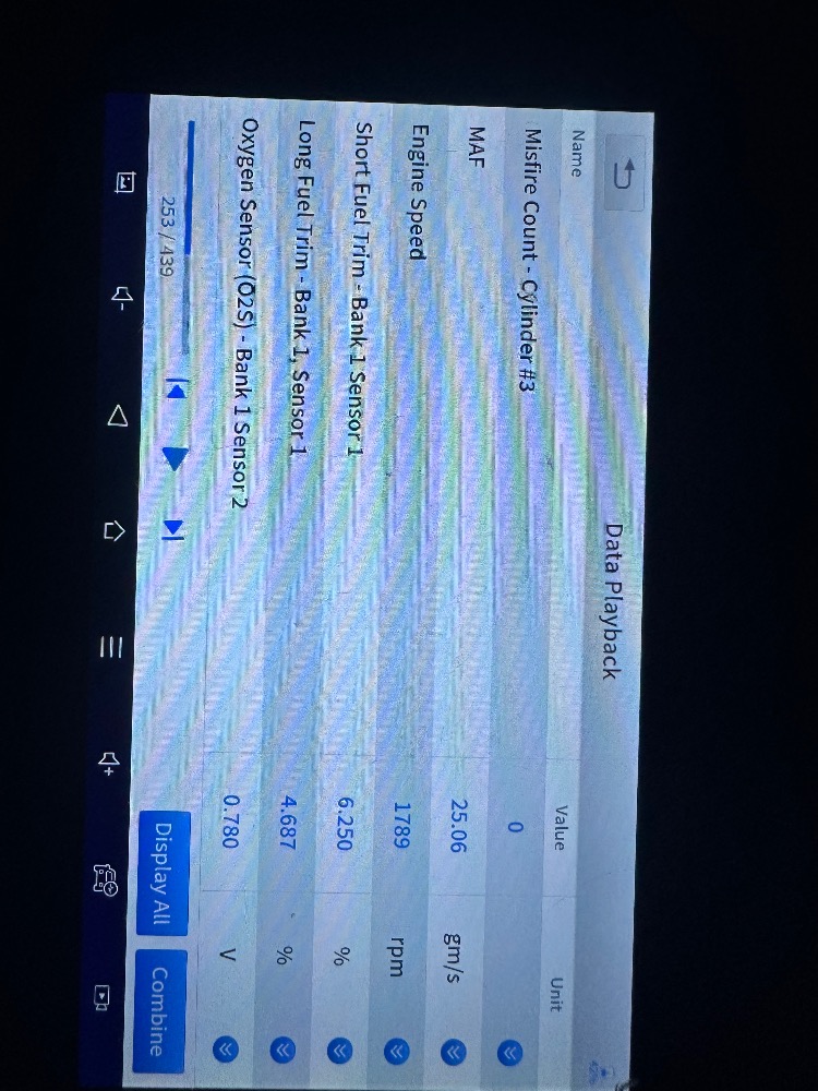

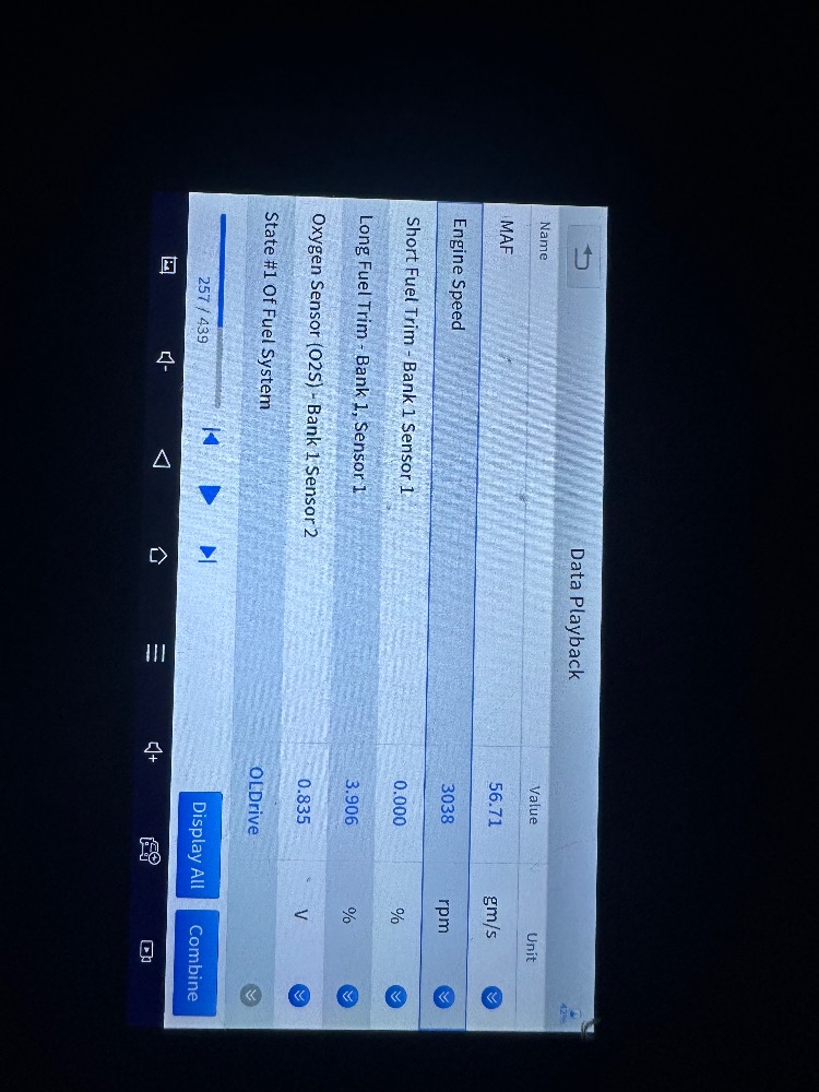

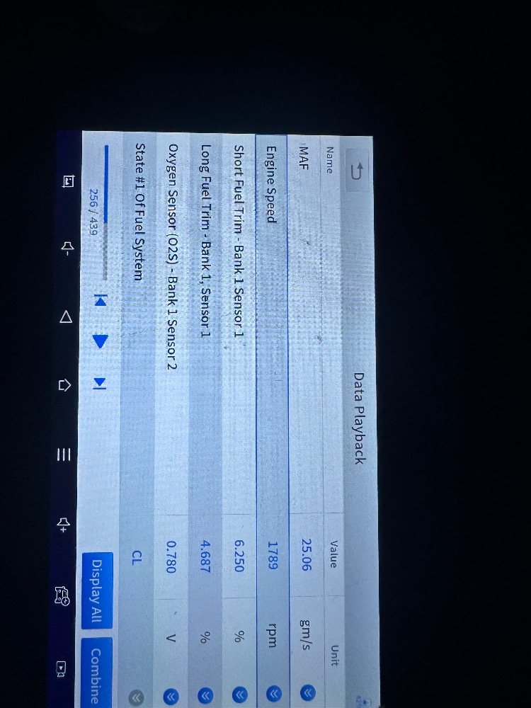

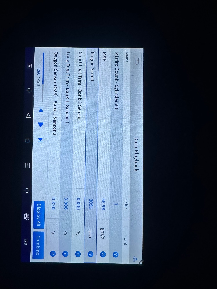

Finally went out on the highway last night and surprisingly, the misfire and flashing CEL only occurred once. Pulled over, cleared codes and drove on. Only the P420 lit up the CEL (not flashing though) about 4 miles down the road (remember, front catalytic converter is gutted). Cleared that code  and the car drove smoothly the rest of the way home. Weird, before replacing injectors, the misfire would begin immediately upon hitting the 60MPH mark.
I will be attaching screen grabs of the some PIDS I recorded while idling and then leading up to the misfire. I also snapped more pictures of the spark plug and the cylinder following the drive. Let me know what you guys think! Correct me if I am wrong but I don't see anything wrong with fuel trims.

9 months 3 weeks ago #92518 by Cdume11
Data idling and leading up to misfire

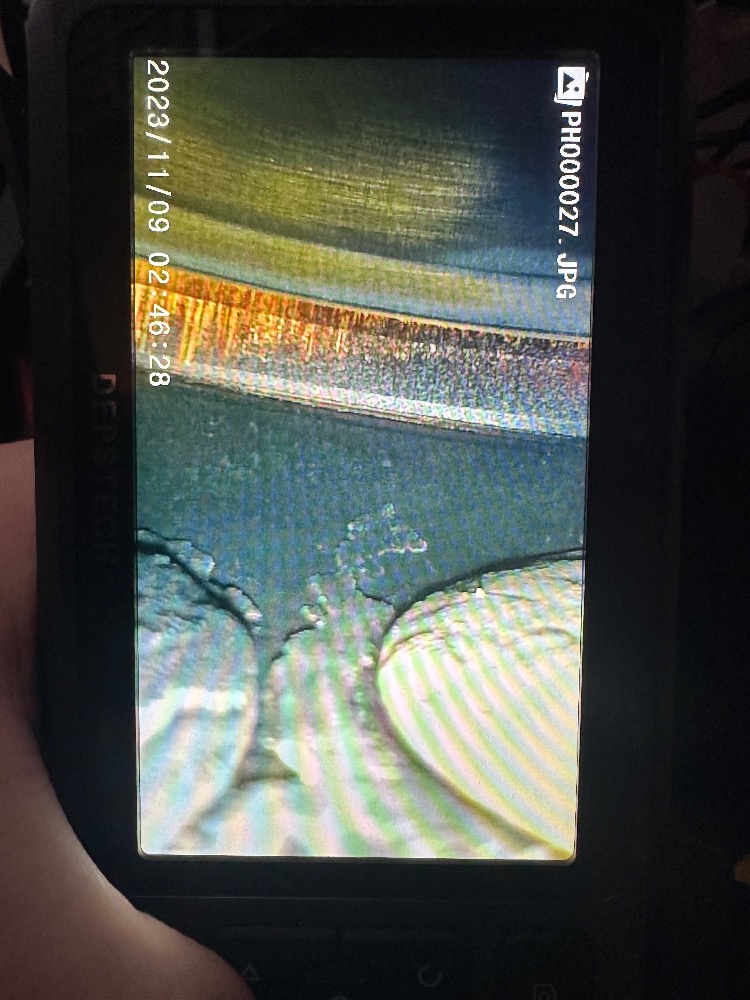

9 months 3 weeks ago #92519 by Cdume11
Post drive spark plug and cylinder
  • Cdume11

9 months 3 weeks ago #92523 by Cdume11
Any thoughts on these screen grabs?

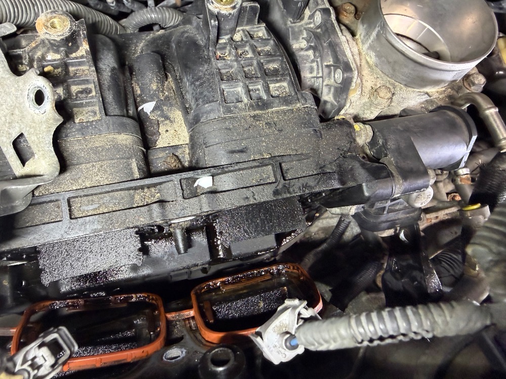

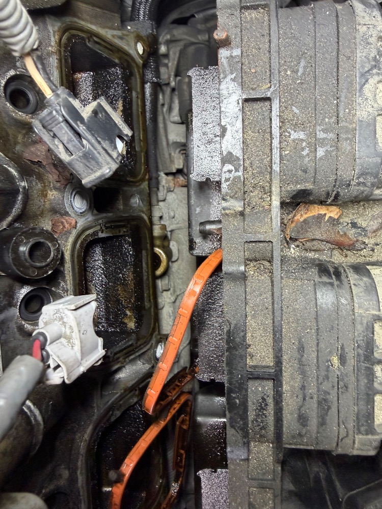

9 months 2 weeks ago #92537 by Cdume11
Got the intake manifold off last night to inspect the pcv valve. Here are some pictures. Fair amount of oil in there
