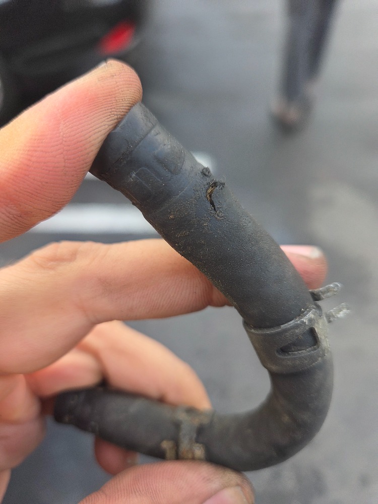

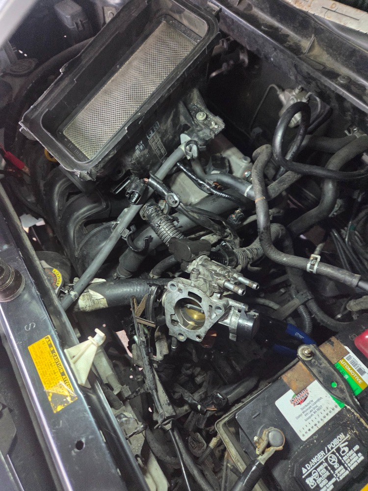

All right, this is my first time posting here. I posted on a YouTube video and I was sent here, anyways, I've been working on a 2005 scion XB with the 1NZ-FE engine 1.5 liter, I think it has a vacuum leak thay i cannot find, these are the symptoms, the car misfires on cylinder 3 and 4 , and sometimes in 2, only when you snap the throttle really fast. It also misfires when you press the brake pedal repeatedly, at first I thought it was a faulty brake booster. Because if I clamp the hose that goes from the intake manifold to the brake booster the misfires disappear when snapping the throttle or gas pedal, i replaced the brake booster with and new one and I still have this same issue. I put a smoke machine in the system and I dont see any leaks. I also use the water bottle trick and brake clean to find vacuum leaks and nothing. Any tips or advice will be appreciated to diagnose this car properly, on scan data I have short trim of about 0 % to 2% and in long fuel trim is have negative 18% if that helps.
Maybe my issue isn't a vacuum leak.
I'm lost as of today. It has also new sparkplugs. I cleaned the throttle body and replaced a coolant hose that goes from the idle control valve , because it had a small rip, I replaced the throttle body gasket and intake manifold gasket. Even tho they look fine. I haven't started the car yet. But I have a feeling that I will be having the same issue. Forgot to mention the car drives totally fine when driving normally , it doesn't have any codes, but if I start snapping on the throttle or brake pedal , I will totally get a random misfires codes on cylinder 4 and 3

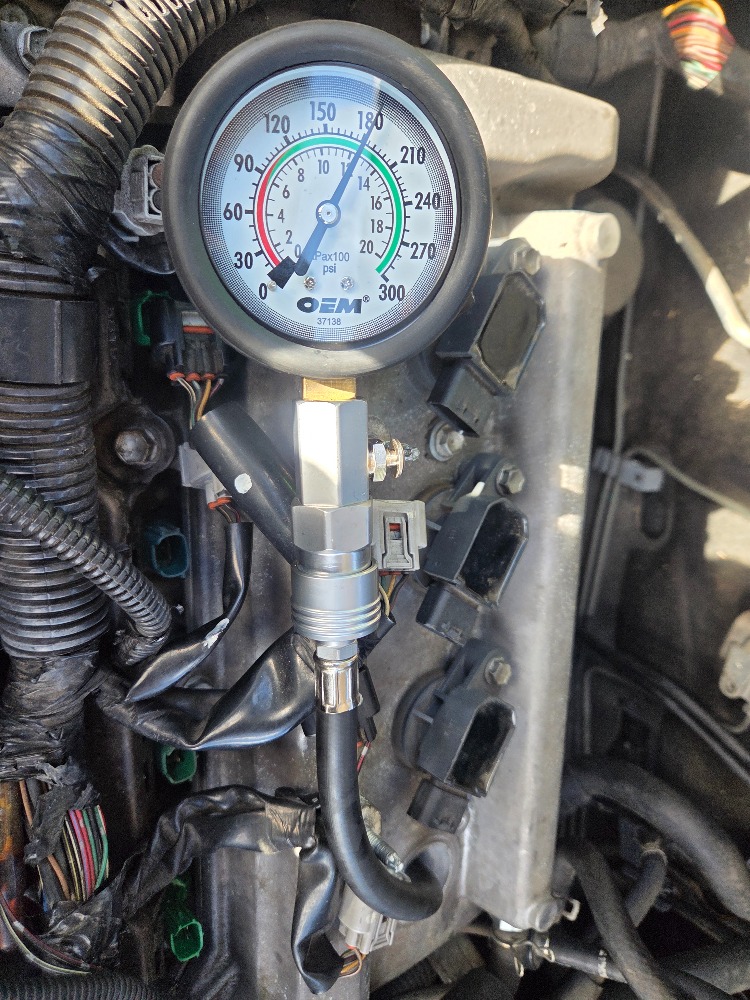

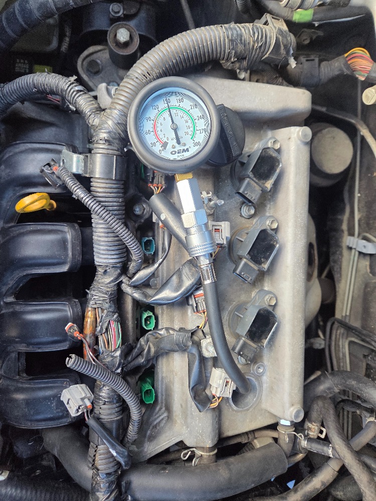

I finally found the root cause yesterday, I want to thank Noah for suggesting a cylinder compression test, I found low compression on cylinder 4!! I assumed the compression was right because i did perform a compression test 6 months ago on this car, lesson learned, never assume just test and gather data. Cylinder 1 ,2 and 3 , have a good compression of 180 psi, while Cylinder 4 has a compression of 156 psi! Thats the minimum allowed for this engine. But the difference between the rest of the cylinders is too much. I put a spoon of oil at the faulty cylinder and compression jumped to 180psi, which confirms piston rings are the culprit. Thank you guys for your replies and help. I appreciated it. 🙏

Here is a couple pictures of cylinder #4 compression test before and after adding a spoon of oil in the cylinder.
10 months 5 days ago #92489
Replied by Noah on topic Vacuum leak? Help and tips need it to pin point the issue.
It could be cylinder wash from lack of combustion. I would take Tyler's advice and swap that injector for another one before condemning the engine just yet.
Also, is it just be or is there one odd ball blue injector in cylinder 2 and green injectors in 1, 3 & 4?
