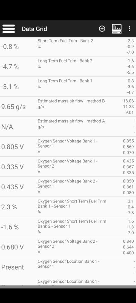

I have a 5.7 vortec truck. All original 189,000 miles. Down to stock radio. I have replaced...
GM cap and rotor
Full tune up and 41-993 plugs
New MPFI Delphi injectors and Delphi FPR
Had a coolant leak on backside of intake, new metal backed gasket set and thermostat and new belts/hoses.
New distributor, with OEM cam sensor put in metal distributor.
New crank sensor, GM genuine
Fuel pump (GM Genuine) and fuel filter
New coil, tried new ICM but went back with OEM one when nothing changed
New O2 sensors (NGK)
No cats installed. And fuel mileage is still good and plugs are not wet.
Temp sensor reads ambient at startup, then 195 at OT.
New Delphi MAF updated design. New MAP as well
When you start it up it almost sounds choppy then straightens out. Then when you go into store and come out you can turn it over and it will chop around then die. Then try again it will come around and stabilize......no codes other than a P1351 if I'm remembering correctly. High ICM circuit. Just not a smooth startup. I have a bi directional LAUNCH scanner. I'm not sharp with it. But I can read it. Short term fuel trims are close to 0, and long term sometimes reach -7.........I have done a pressured smoke test on PCV valve and no leaks. As well as brake booster.
I'm at a loss. I watch scanner Danner all the time and I got a monthly subscription hoping some smart mechanics will help me out. Truck looks too great to be sounding like it does when it's starting up

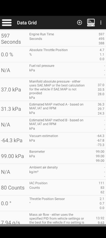

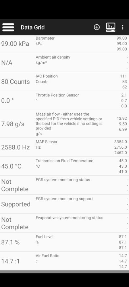

And I set the Cam offset as well when I did the distributor. Set to TDC using a old cap with a hole drilled in it. Then set Cam offset at 1k and tightened down old style clamp.

9 months 5 days ago #92099
by 70monte
Replied by 70monte on topic 1998 Chevy Silverado K1500 choppy cold/warm startup
Your MAF readings seem high for a hot idle. It should be closer to 5.7 g/s. I would install the original one and see what your reading is.
