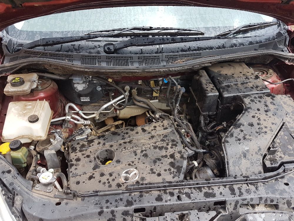

I was watching one of your videos about the mazda imobilizer and ECU testing. I follwed all steps but everything seems to be ok i got the 5v reference and 12v on the thermister the key unlocks the doors but the imobiliser wont go off it wont crank the car had a minor accident which broke the right engine mounting battery in key fob is new, car battery is new aswell. The car is a Mazda 5 2008 model please find attached picture of the engine i am in Africa couldnt find anyone who can help. The nearest mazda dealer here is 200km away and i can afford to tow it to a dealer near me I sincerely hope you can give me some help

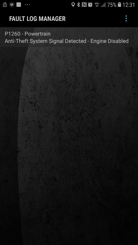

Thanks will look into that i borrowed a bluetooth obd scarner and it came up with P1260 engine disabled attaching videos

This code means, the PCM have received a Signal from the Immobiliser (or the PCM have no communication with the Immobiliser) ---> the car is not allowed to start. Do you use all original components (Modules) for this car? Your Key is original? If not, Change all components to original.
Next step: Read the Immobilizer Codes with a good tool and look what this module says.
Are the Airbags being open at this accident? If yes, maybe there's a Crash registered that don't allow the car to start.
Conclusion: You Need a good code-scanner and post a full scan log here.
