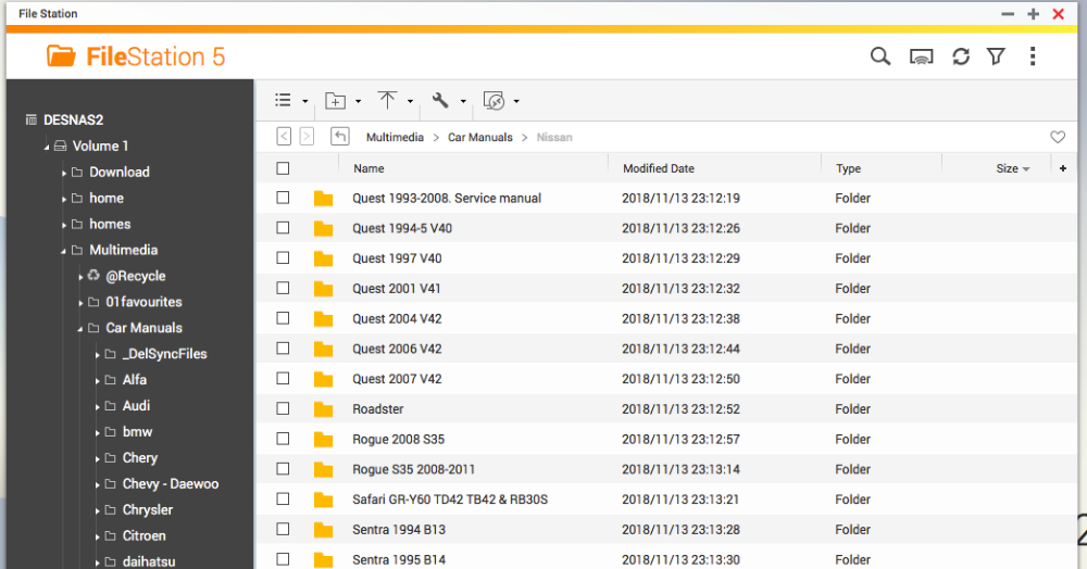

I just checked and I have manuals and diagrams for the Nissan Quest but the engine management file itself is 16 meg and the file limit here
is 5 meg. If you need it make contact and I can arrange for a file transfer.

Just saw this, but yes those manuals and diagrams would be great to have. Could you send through email?

- Desmond6004
7 years 9 months ago #25972
by Desmond6004
Replied by Desmond6004 on topic 2004 Nissan Quest. Engine doesn't start.
I've just sent you the "Engine Control" pdf. Check your email
