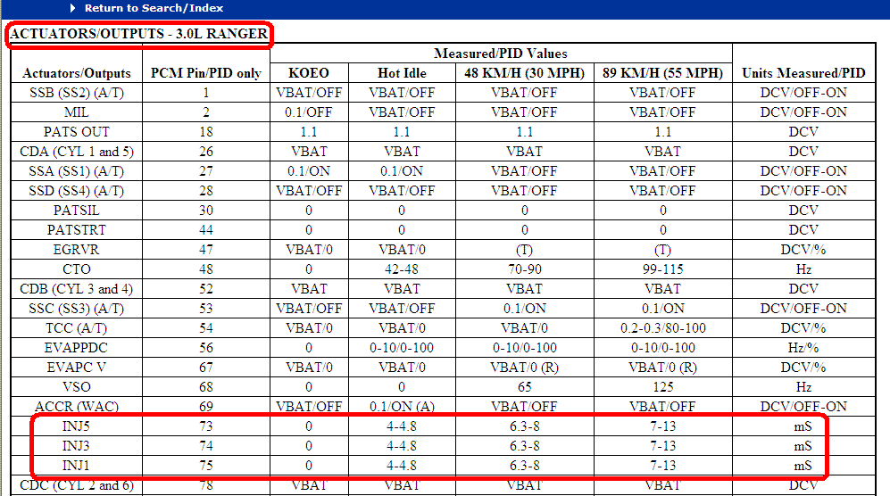

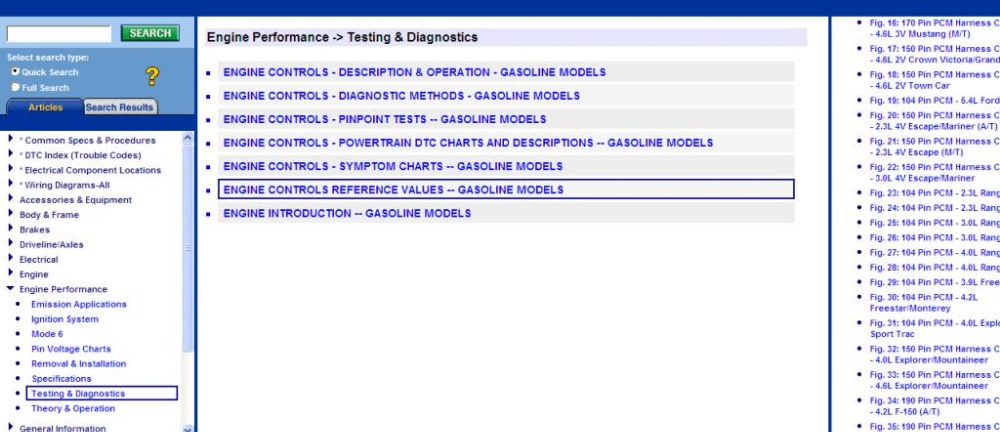

7 years 10 months ago #25822 by Noah
Juergen, where did you gather that information?
  • juergen.scholl
  • juergen.scholl's Avatar
  • Active partschanger
7 years 10 months ago - 7 years 10 months ago #25823 by juergen.scholl
Noah wrote: Juergen, where did you gather that information?
Noah,
this is plain old MOD5, main menu=> engine performance=> testing and diagnostics=>engiben controls reference values.
Ford does an amazing job on input/output information, though it seems to be overlooked quite often.
The same information is given in Aldata as.well. The newer online versions of both , Mitchell and Alldata, do feature the same information.
With your snap on scantool you can find similar information within the troubleshooter section. Somewhere in that menu you can choose one specific PID at the time and the scan toll will show you the actual value versus standard value. HTH.
Last edit: 7 years 10 months ago by juergen.scholl.
