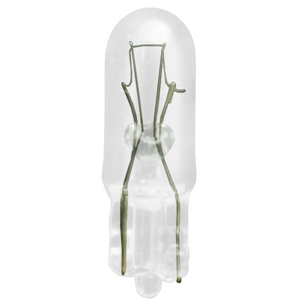

But, if you want to quickly check injector pulse so you can cross it off your list, you could make a homemade noid light using a 194 style automotive bulb. Steal it from your tag light, then put it back when you are done.
Just unwind the leads away from the glass base, and plug it into the disconnected two-pin injector connector.
You can watch the flash and see if it is being fired, you can even compare one to another and make sure its flashing for the same length of time.

Rev Scott wrote: But, if you want to quickly check injector pulse so you can cross it off your list, you could make a homemade noid light using a 194 style automotive bulb. Steal it from your tag light, then put it back when you are done.
Lol, I've employed that tactic :)
7 years 10 months ago #25809 by Tyler
Replied by Tyler on topic 2003 Corolla p0302
Now that's some resourceful thinking right there. B)
