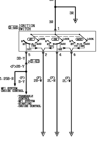

No offense meant here, but I think it's interesting that the short went away when you disconnected the ignition switch and started testing. Any chance that the blue/yellow wire was rubbing ground somewhere on the column beforehand?
EDIT: Diagram incoming

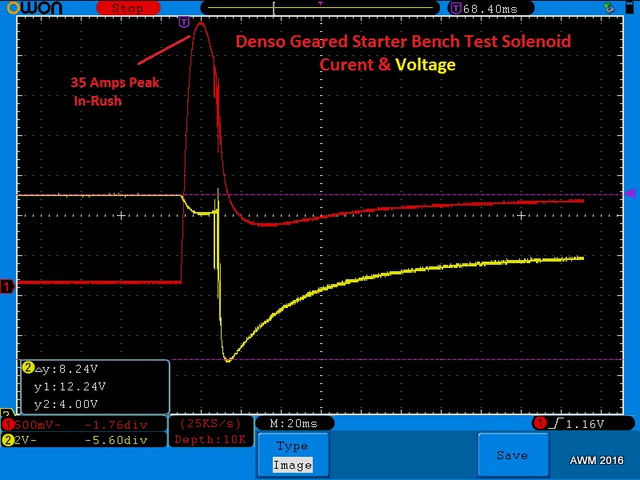

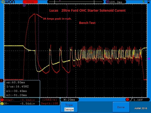

A huge spike in the starter solenoid coil current is normal I did some off car testing a few months back on 3 different starter motors and a spare solenoid coil and was really surprise at just how high the spike was about 35 amp for 2ms, then it falls back to about 10amps.
The same goes for the fuel pump, spike at key on then fall back as soon as the pump motor starts to run --- but the spikes would not normall overlap ie. first the pump spike then stater solenoid spike..

Than ks for all your input, folks! So what I'm gathering from the info provided by Tyler and Andy is that the amp spikes I'm seeing when powering each of those ignition switch outputs is likely NOT concerning and so it is likely that it isn't something in any of those circuits that's blowing the fuse.
Am I correct, then, to assume that the short is likely occuring, as Tyler suggests, somewhere near the harness connector at the ignition switch OR is it possible that there could be a short INTERNAL to the ignition switch itself?
Is my diagnostic technique here sound? Primarily, that if powering each of the output wires with a powerprobe and watching that amperage never jumps to an crazy level on any of them clears any of those circuits as potentials?
