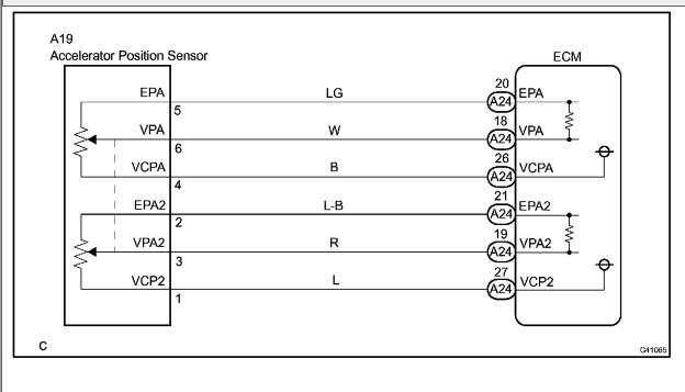

7 years 11 months ago #25032 by Richie1
Hi my name is Rich, I have a '05 Toyota Avalon with 232K miles. Had issues with stuttering and jerking when going from stop. Car will not go over 50mph. OBD2 code showed a P2127. Back probed the wires leading into the throttle body, all but one checked out properly. VPA2 wire showed a constant 2.03V. Never moved on WOT. VPA1 was .73V at idle. Had the computer looked at and wasn't the issue. Question: If the constant V on the second signal wire is higher (my research indicated it should read .73-.96V) than normal, and the ECU was looked at and the issue is still there, would the Power Supply Unit Module supply that 2.03V to the TPS?

Lets do some Voltage checks with the sensor unplugged.KOEO.
What is the Voltage on EPA ?
What is the Voltage on VPA ?
What is the Voltage on VCPA ?
Do the same checks for EPA2, VPA2, and VCPA2
I just want to verify your 5v ref circuits and the signal wire(s) voltage levels.
But to answer your question it looks like your VPA2 is stuck at 2.03v. The reference for this circuit is 5volts. These are hall-effect style potentiometers, so I'm thinking your your sensor is pulling your reference voltage to 2.03v./ or the reference voltage is low, but the no change in voltage does suggest a bad sensor.
In a nutshell, I want to verify your reference voltage EPA2 is 5volts, and whether your signal voltage VPA2 is high or low unplugged, as compared to the EPA1 and VPA1 circuit.
If the circuit is pull-down on the signal(s) voltage and both references EPA1,2 are 5volts, you more than likely have a bad sensor. Circuit integrity checks would need to be performed next.
