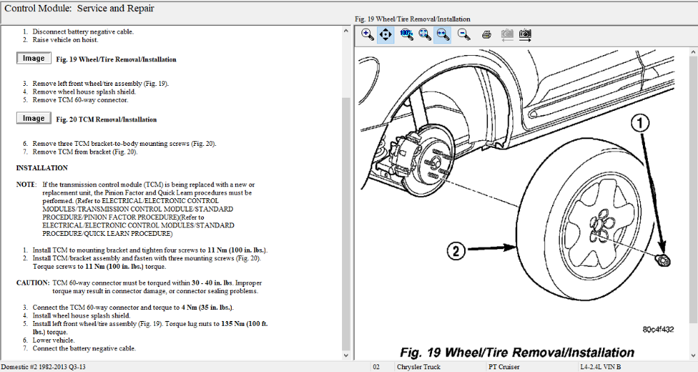

According to AllData, you are required to perform a Pinion Factor( for the speedometer) and a Quick TCM Re-Learn. Not quite sure if the Vantage can do that.

Thanks for responding . I have an Apollo scanner. It has the capability to do the relearn. But the relearn wont run if there are codes in the TCM.
