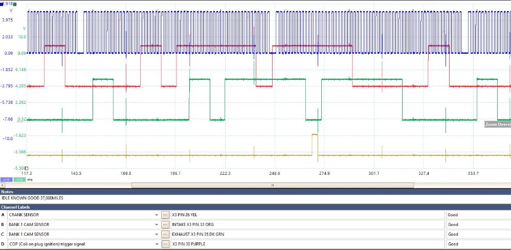

Hey guys looking for a known good bank 1 cam crank wave forum for a 2010 gm 3.6L
7 years 11 months ago #24346 by Ben
Replied by Ben on topic Re:Cam/crank waveform 3.6 Acadia
I have 1 coming in tomorrow with a 3.6 gdi I can grab 1 from if no one has 1
7 years 11 months ago #24366 by bruce.oliver
Replied by bruce.oliver on topic Cam/crank waveform 3.6 Acadia
This is a 2012. The pico file was to big to upload
