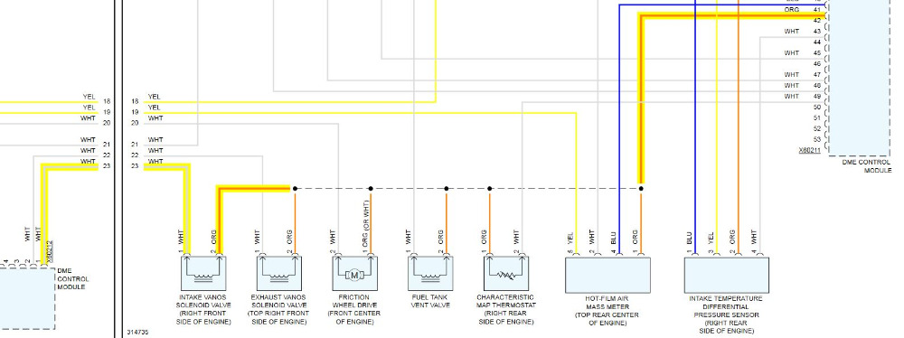

8 years 2 months ago #22626 by Chad
287D = p0012

8 years 2 months ago #22628 by robert.lesaca
Replied by robert.lesaca on topic 2009 MiniCooper Clubman 1.6L (Model R55, N12)
Thanks for the diagram. It looks like the solenoid is powerside. I remember a video by Paul, I believe a Subaru VTEC. The owner has decided to leave the car with me. I will view that video and take it from there. I guess I have to scope both CKP/CMP for relationship as well check timing too. I will give an update on how it goes, with fingers crossed.

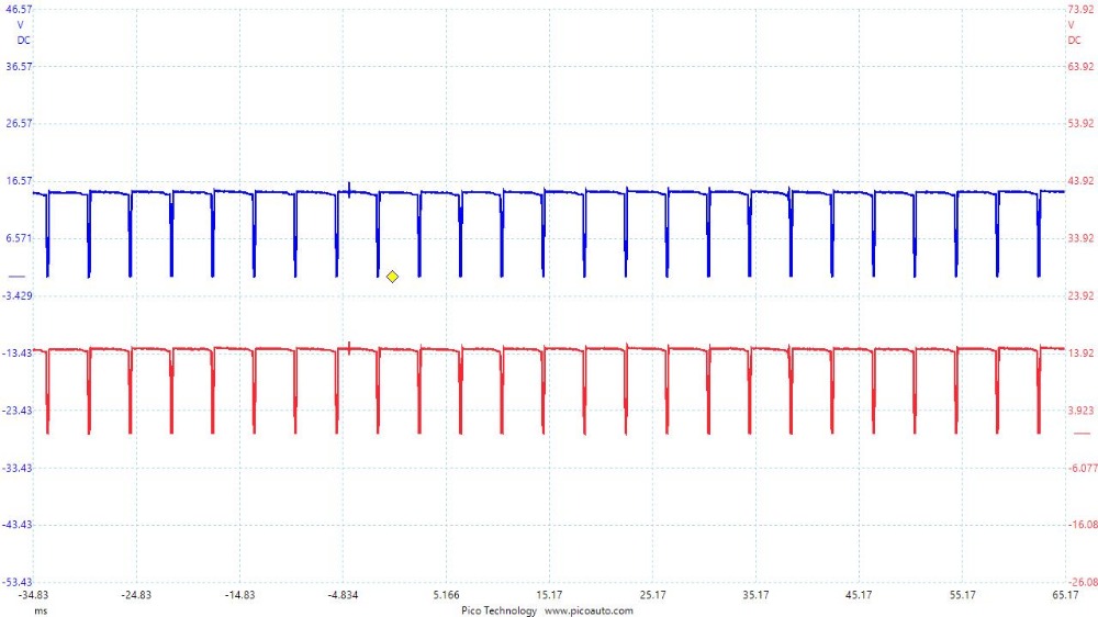

This the waveform I just did...i cannot find a similar waveform anywhere. So Im presuming this is a good waveform.

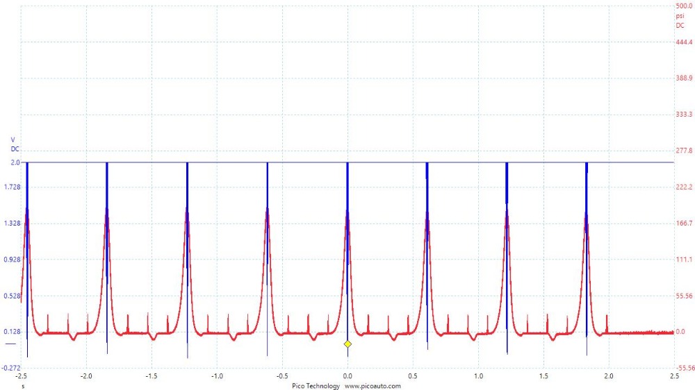

8 years 2 months ago #22742 by robert.lesaca

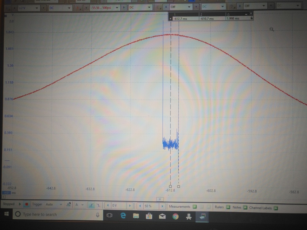

These are the waveform I got for the #1 in-cylinder compression and coil signal...at a glance, TDC is occuring before spark event (per computation abut 2.3 degrees of crankshaft rotation per sec). I dont know of the vehicles exact timing in degress but per Paul it should occur close to zero degrees, if not zero).

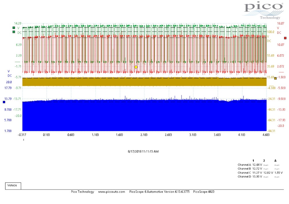

8 years 2 months ago #22743 by robert.lesaca

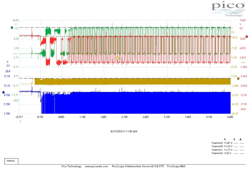

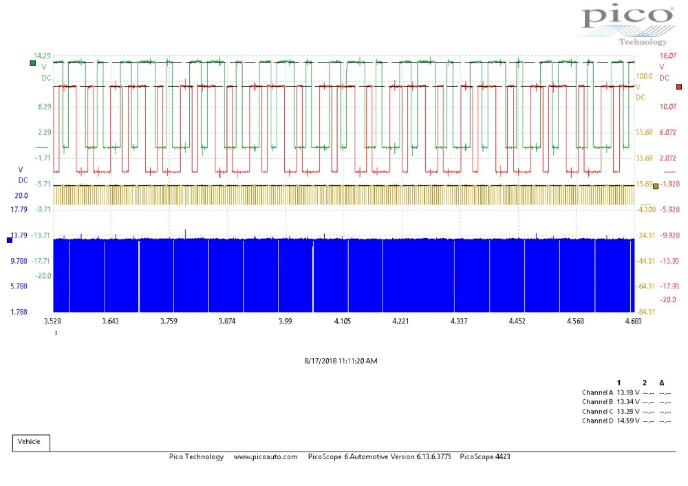

Likewise, here are the Intake and Exhaust VANOS waveform. I noticed that there was no change in frequency when revving up the engine.
Starting from a cold engine, as soon as RPM drops from 1100 RPM to about 1000, engine would experience a "hiccup" and set a fault code of 287D (PO012) - Intake Vanos solenoid actuator problem. The Intake Vanos solenoid was changed before hand, but as mentioned frequency does not change despite rev up.

8 years 2 months ago - 8 years 2 months ago #22750 by robert.lesaca
at the moment these are all the remaining waveforms I have and the corrresponding changes in Voltage including the point, at 3.68 secs, frame 2, where the engine would "hiccup" momentarily setting PO0012/287D

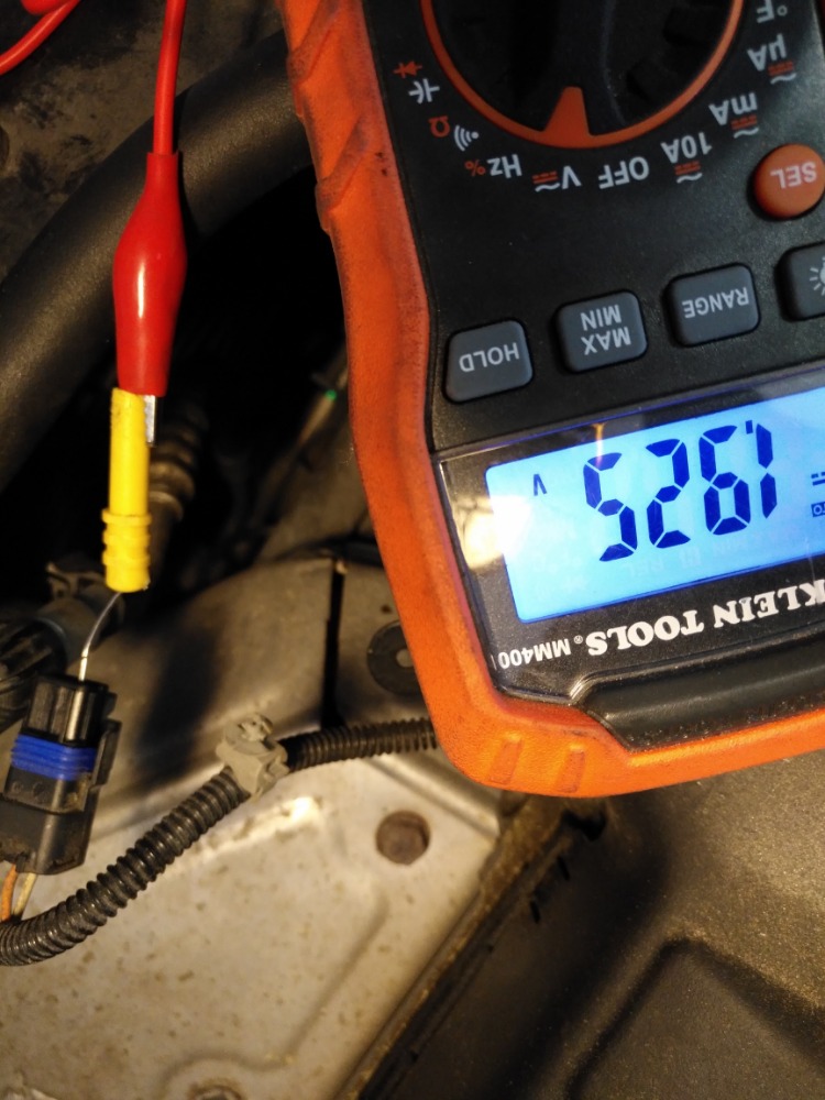

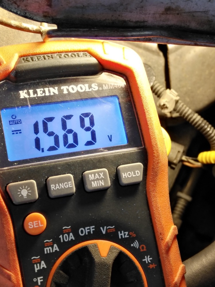

KOEO, the exhaust VANOS solenoid control wire showed 1.56 V plugged-in; and 1.93 unplugged, other wire read 0V plugged-in.
the intake VANOS control wire (which I was not able to save) i remember exhibited the same voltage reading, plugged-in and unplugged...
