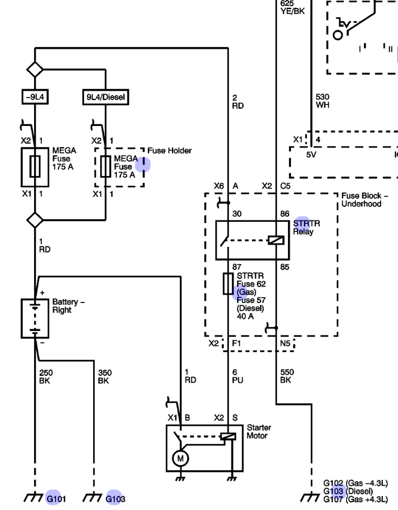

My 08 Sierra 4.3L recently came down with a No Crank/No Start. A mechanic buddy said it was a bad battery, it wasn’t, then said bad mega fuse, it wasn’t, and then bad fuse box, and again, it wasn’t. I’m not purchasing anymore parts until I’m 100% sure It’s needed! With my test light I tested the starter relay and I’m not getting power to it. Where should I go from here? Anti theft, Park/Neut Switch or ignition Switch? I’m limited to a test light and Multi meter with different probes and clips etc. Any and all help is greatly appreciated!!! Thanks from Central PA and Go Pens!!

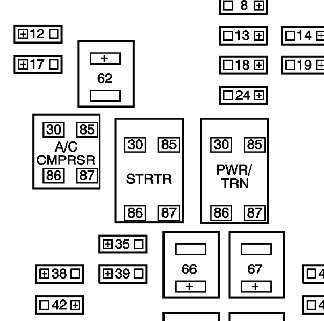

Let's be clear about no power to the starter relay. I attached a numbered terminal view of the starter relay pins in the underhood fuse box:
Key on, starter relay removed. Test light connected to B-, lightly probe all four starter relay terminals. Use a T-pin or thin piece of metal to get down to the terminal if you have to, but don't spread the terminals in the process. Only probe one terminal at a time. Which terminals light up?
Key on, test light to B+, touch all four again. Which terminals light up?
I attached the starter relay diagram for future reference, but it really isn't important at this point. Let us know which terminals light up, and we can go further.

7 months 1 week ago - 7 months 1 week ago #85878 by 70monte
Replied by 70monte on topic No Crank No start on my 08 Sierra
By looking at the wiring diagram above, you should have power on pin 30 and 86. Pin 87 seems to power up fuse 62 that goes to the starter. Pin 85 should be a ground. It doesn't make sense if your test light is hooked to battery + that pins 30 and 86 would light the test light. That is backwards on how it should be.

Do you have battery voltage or does the test light illuminate on pin 86 when the key is in the start/crank position?( Test light or voltmeter lead connected to ground) That will tell us if you are missing inputs.

When key is on and light was hooked to B- #87 lit up and when hooked to B + #30 and #86 both lit up.
I don't mean any offense when I say this, but that's completely opposite of what it should be.
Is it possible that you were looking at the pins upside down? Because it'd make way more sense that terminal #30 lit up with the test light to B-, and #87 and #85 lit up with the test light to B+. That'd show good power from the battery at #30, continuity through the starter solenoid and fuse through #87 and control ground through #85.
All that leaves is #86. Test light to B-, probe the one pin that didn't do anything the first time around. Have someone else turn the key to Crank. What does the light do?

7 months 2 days ago #87261 by Tkturns816
Replied by Tkturns816 on topic No Crank No start on my 08 Sierra
The relay was upside down thus the numbers being switched… you’re correct 30 lit up on B- 87/85 on B+.
Nothing happened when 86 on B- and cranked.
