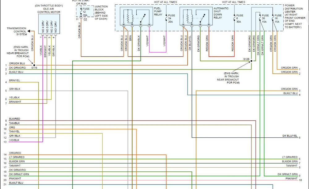

I have a 01 jeep grand Cherokee limited 4.7 no start I have no power to 15amp injector fuse I have replaced fuel pump & filter, camshaft also could it be the crankshaft sensor? It's been down a month I'm so frustrated with it please help.

Hey Toddster! See page eight of the attached diagram. It's got the fuel injector fuse and other info we'll need.
So fuse 26 NEVER gets power? Even during cranking? If that's the case, the next thing I'd want to know is if the ignition coils are the same way.
If you never get power to the coils AND the injectors, then your next stop is the ASD relay. If fuse 26 never gets power, but the coils do, then you're looking at an open/high resistance between the ASD relay and fuse 26.

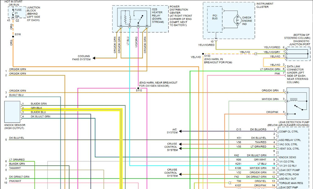

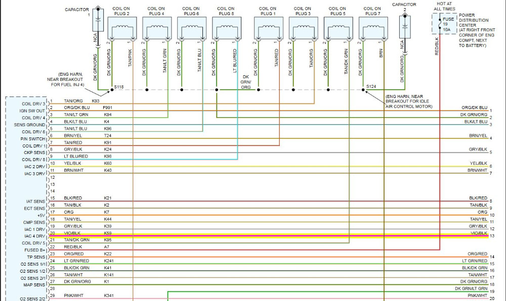

8 years 2 months ago - 8 years 2 months ago #22218
There was no attachment. Fuse 26 is at the top of the second page of these 3 pages. Fuel injectors are at the bottom of the first page. The high-lighted circuits are accidental.
Replied by Chad on topic No start 01 jeep 4.7
Tyler wrote: See page eight of the attached diagram. It's got the fuel injector fuse and other info we'll need.

The Mitchell diagram also shows that fuse #16 should be dead if the ASD relay is inoperative, so that'd be another worthwhile check.
