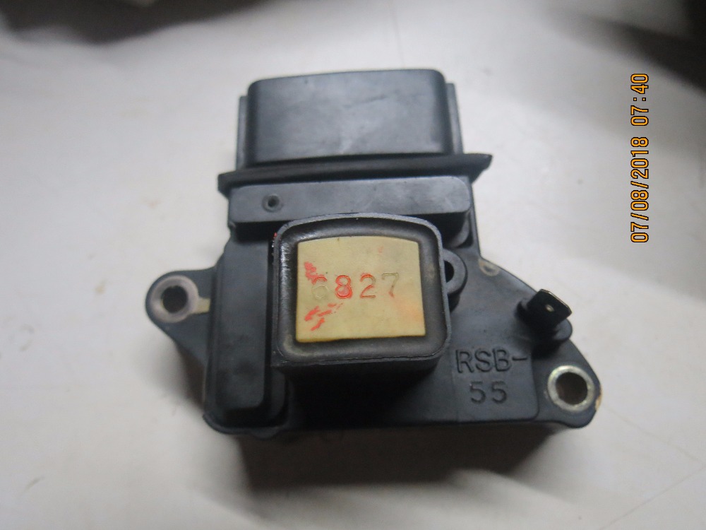

Good day, guys you have distributor wiring diagram?
2 wire - power feed
- RPM
and the other is 6 wires, i dont know what it is
6 wire - ?
i have a photo's Thank you Guys More Power SCANNERDANNER

Dont know terminal is which but you have 4 for camshaft position sensor(2 grounds, 1 power and 1 signal it looks like) 4 wires for spark control (1 power and 1 ground for the primary coil transistor and then 1 power wire straight to the coil primary winding and 1 wire going into an external resistor)

is this correct? i have crank, no start,
i removed injector assembly and watch my fire event all 4 injetor fire the same its not fire 1-3-4-2 is it Good?
i have spark but, sometimes lack of spark. i dont know the optical sensor is BAD.
i already check my wiring.
here what i have. i dont know how test inputs to distributor .
i have 5 wire on my distributor. and 2 wire
this is my INPUTS?
- black/white - ? (i have 2v readings when i rotate rotor)
- white/black - ? (i have noting )
CAMSHAFT SENSOR
- blue - 5v SIGNAL pull-down design
- white/red - 12v
- blak - ground
POWER FEED And RPM
- Black/red - 12v Power feed
- green - RPM
thank you guys i have photo's below
