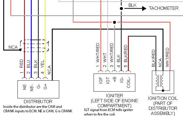

On my 1995 Camry 2.2, yesterday it rained really hard and i hit a few heavy puddles and after that the car just died and it cranked but wouldn't start.
I got the car towed home and after a few hrs the car started but it was running rough. I checked for spark there was hardly any spark coming out of the wires on all 4 cylinders. I checked for spark at the ign coil tower and theres no spark at all. There is power on the positive side of the coil and there is power at the 2 wire connector. I checked the power and ground at the igniter and it's good.
I have my original distributor and coil, which I know is good. I put back the original distributor and still there's no spark at all coming from the coil? I have a spare igniter and i tried it and still no spark at the tower. Any ideas why I'm not getting any spark? I dont know what direction to go from here

The fact that you have weak spark rules out ECM control issues. I would focus on the IGNITION COIL or wires connected to the IGNITION COIL (see diagram).
Take the DISTRIBUTOR and ECM out of the picture. Unplug the wire labeled NCA (see attachment) from the distributor and give it a good 1 inch air gap to ground.
Key on, and see if you have power at the white IGT wire on the IGNITER. If you have power there, connect test light to ground and touch the IGT wire. If you have no power there, connect test light to BATTERY and touch the IGT wire.
This will fire the IGNITION COIL. If the wire labelled NCA coming from the IGNITION COIL has weak spark then it's the coil.

On the igniter white wire I checked for power key on and test light didn't light. Switched the test light to B+ and I'm able to fire the coil. A good gap of spark is coming out. So then the igniter, the pcm and wiring, inputs and the distributor is all good. So then the coil is at fault?
Last edit: 7 years 10 months ago by gnx547.
7 years 10 months ago - 7 years 10 months ago #21562 by JustJuan
Replied by JustJuan on topic No spark at the ign coil tower on Camry 2.2
If you have good spark jumping the gap out of the IGNITION COIL, then you have proved that the IGNITER is good, and the IGNITION COIL is good. I am also going to assume the ECM is good from what you wrote previously but let's test that as well just to be sure.
Same instructions I gave before, only don't touch the IGT white wire. Let the ECM provide power on the IGT wire by cranking the car over and watching for spark. You should see good spark, good jumping and cracking until you stop cranking.

If no spark from COIL, then ECM or input problem (which I don't think it is since you wrote previously car ran rough, so the same inputs are also controlling injector pulse).
Okay this: if no spark from COIL while cranking, put test light to ground and leave it touching the IGT wire. The test light should pulse. If not pulsing, then it's a ECM or wire from the ECM issue.

Some thoughts....
To me it`s almost next to impossible to figure that you would have a spark - even a weak one - at the plug terminal of the wire while not having a spark at the coil . But then again, I haven“t seen it all....
Additionally to the proposals of JustJuan you might want to check for cam and crank sensor signals from the pick up coils in the dizzy going to the pcm, just in case there was no IGT signal while cranking.
If good cam/crank signals are present and not even one initial IGT signal shows up move to power and grounds of the ecu before condeming it.
If there was only one or a couple of IGT signals during cranking then check the IGF wire for a short to ground/lower than normal resistance or an open.

I found a bad ign wire on the distributor cap. The coil also had a small crack. I did crank it over I've got spark on the coil. I got new plugs, wires, cap, rotor, coil. I got all the new parts in and i do have spark coming out of the ign wire. Not a big spark gap as I thought it would be but much better than before.
