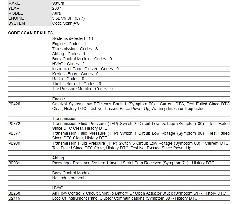

10 years 2 weeks ago - 10 years 2 weeks ago #2761 by Tyler
rn8849 wrote: But, I would really like to know what is meant by, "Test Failed Since DTC Clear, Test Not Passed Since Power Up" in that list of codes, specifically, which power up? Since I reconnected the battery? The last key cycle? Some monitor it runs?
Ah yeah, that's a feature of GM's. They add those sub-descriptions to their trouble codes, expanding on what we know of as 'history' and 'current' DTCs.
Here's an example of a Saturn Vue I looked at last week:
The P0420 in the Engine module is both a Current and History code. The 'Test Not Passed Since Power Up' means it hasn't passed this key cycle. 'Test Failed Since DTC Clear' always sounded always sounded needlessly self-explanatory to me :huh:
The transmission codes, on the other hand, are History only. Note the U2116 in the HVAC module - the code is there, but no communication issue exists.
