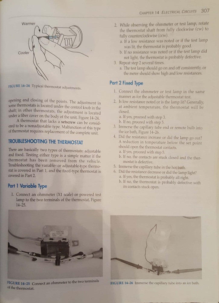

Does anyone know how to test an A/C thermostat, not a thermistor but a thermostat?
Thanks
7 years 11 months ago #21051 by nathan.carpenter
Replied by nathan.carpenter on topic How to test an A/C thermostat?
I read on a Mitchell page about putting it in a glass of ice water and taking measurements, if I come across the page again I'll let u know specifics
7 years 11 months ago #21063 by CurrentDraw
Replied by CurrentDraw on topic How to test an A/C thermostat?
Hope this helps
