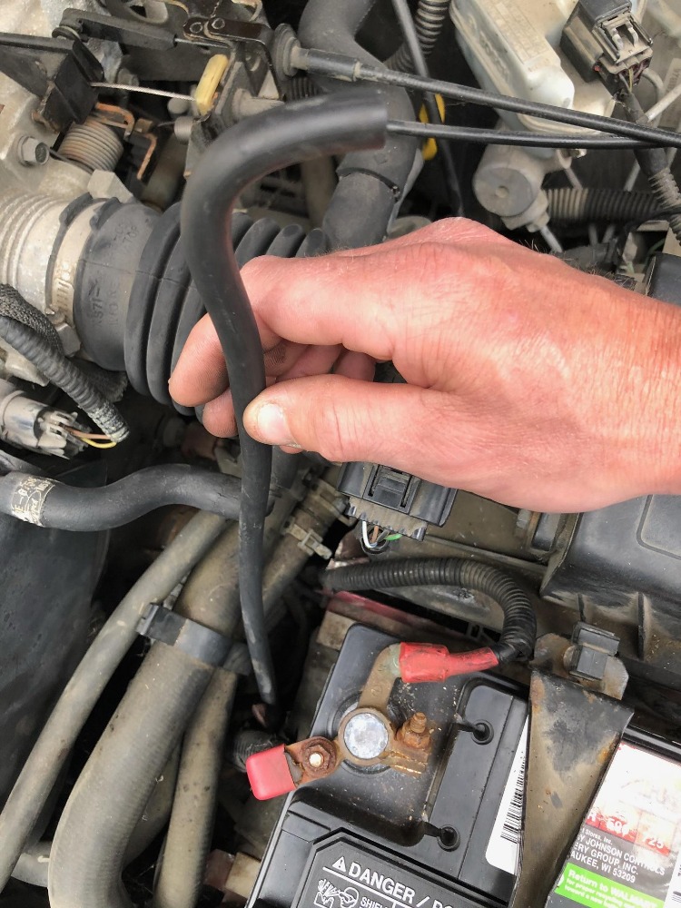

Does anyone know where this vacuum hose goes?
8 years 5 months ago #20681 by Matts Auto
Replied by Matts Auto on topic 02 Mercury cougar 2.5
Looks like brake booster
8 years 5 months ago #20713 by bruce.oliver
Replied by bruce.oliver on topic 02 Mercury cougar 2.5
Where does the other end go? Looks like the trans vent hose to me
  • Willscohy
  • Willscohy's Avatar Topic Author
8 years 5 months ago #20714 by Willscohy
Replied by Willscohy on topic 02 Mercury cougar 2.5
I was just thinking that. Does it plug into something?
8 years 5 months ago #20723 by Noah
Replied by Noah on topic 02 Mercury cougar 2.5
I was thinking trans vent as well. No vacuum with the engine running?
They're usually just clipped up somewhere they won't let water in the trans, not plugged into anything.
