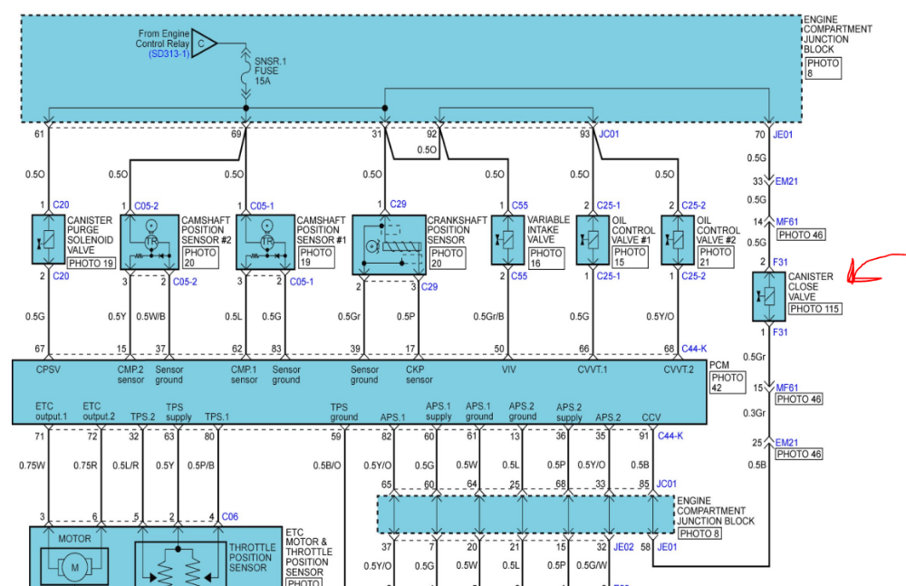

8 years 6 months ago #20099 by MarekM
I want to confirm if the vent solenoid is bad. I disconnected the connector and read 12.6V and 4.3V from the two female terminals on the connector. 12.6 must be the power feed, why is there 4.3V on the control circuit? I plugged the connector back in, back probed the control circuit, and it read .1V I stopped testing because I was confused by the 4.3V reading. Could anyone explain that for me? Wiring diagram below.
8 years 6 months ago #20101 by cj1
"I plugged the connector back in, back probed the control circuit, and it read .1V "
Control circuit measured to ground should have 12v (vent normally open mode)
If 0v then suspect vent solenoid coil is open.
Verify ohm resistance of solenoid.

8 years 6 months ago #20104 by cj1
Best to jumper 12v direct to solenoid.
Added resistance of your test light in circuit may be limiting current to solenoid coil.
Note: since the solenoid isn't electrically open you should have 12v on the control going to the PCM. If you read 0v then wiring or PCM is grounding voltage.
