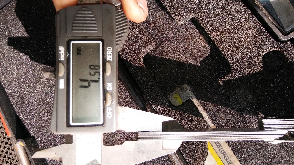

I got this maxima with a jumped chain question is does this piston hit the valves when off time. Question # 2 I don't have a leak down tester I just put air straight from the compressor. I set the 2,4,6 on top dead center and on all 3 i have air coming out of the intake does this confirm that the valves are bent?

2-4-6 is the front bank? You can pull the valve cover and eyeball the shim buckets on the valves. If there's a noticeable gap between the bucket and the cam lobe, they're bent. If not, maybe consider a stuck VVT actuator?

Tyler so you are saying to check the valve gap and if i have a difference from the specs they are bent?

Eh, you can check against spec if you want. But most of the time, when I've found bent valves this way, the bent ones are obvious. :lol: As in, you're looking for .011" and you find 1/4".

8 years 6 months ago - 8 years 6 months ago #19618
by gilbert
Replied by gilbert on topic 06 nissan maxima timing chain
Last edit: 8 years 6 months ago by gilbert. Reason: Misspelled word
8 years 6 months ago #19640
Replied by Tyler on topic 06 nissan maxima timing chain
NICE. :ohmy: :silly: Those intake valves musta been wide open when the pistons came up. Were all the valves on bank two this way?

Hey Tyler only the intake valves seem to be bent on bank 2.
