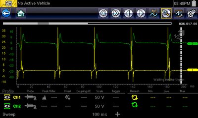

10 years 3 months ago - 10 years 3 months ago #300 by Tyler
Replied by Tyler on topic 1997 Honda Accord No Start
Alright, got some info for OldSchool (and anyone else following along).

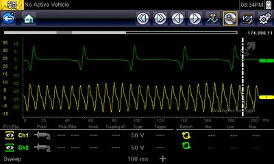

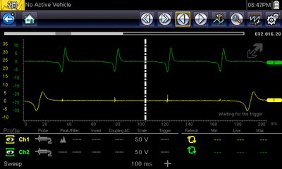

Got some known good waveforms of this setup, mostly for my own information. First up is the TDC sensor in green, and the CMP (in the distributor) in yellow.
Then we have the TDC sensor in green, and the CKP sensor in yellow.
I also wanted to get an idea of how the TDC sensor plays into timing, so I also grabbed a shot of the TDC sensor with an ignition pickup on the coil.
I don't think it's chance that the coil fires every time the TDC pulse occurs. I'm still somewhat confused how your Accord has spark, 'cause I'm not sure how the PCM can figure timing based on the CKP and CMP alone.
Anyway, onto the bypass test! If you haven't already watched it, that GM ignition module test is great stuff. Another video about a Saturn no start (with a bad crank sensor) is also worth watching:

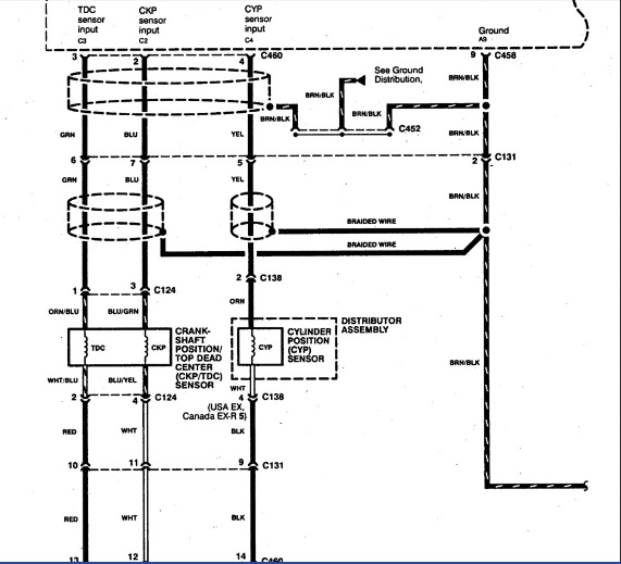

Referring back to the diagram on the first page, you'll want to backprobe the orange/blue wire (sewing T-pins are perfect for this). Turn the key on, leave it there, and hook your test light up to B+. Rapidly tap the test light tip on the backprobe while listening for the injectors to fire, or maybe even spark.
If this doesn't work, don't panic. It may be that the engine computer needs the other two signals at the same time to fire the injectors, so have someone crank the engine over while you're tapping the test light on the backprobe.
Getting the injectors to fire in either case tells us that the computer CAN fire the injectors, and that it was missing the input that you're supplying with the bypass test. Let us know how it goes, or if you have more questions!
Last edit: 10 years 3 months ago by Tyler.

I'm very frustrated with this vehicle. And I've been searching for answers and found many interesting (sometimes wild) online thoughts about the honda accord. For example: one guy on youtube says that if the car doesn't start right away that the computer senses low oil pressure and turns off the fuel pump and the injectors. I don't believe that, but.... I've seen lots of crazier things in my life. At this point, I'm not surprised by anything people do..
I put VERY little faith in anything posted in online enthusiast forums. Obviously the same doesn't apply on THIS forum, but some of the advice people are giving and taking as gospel out there is scary.
I didn't feel confident in the injector pulse test that I performed using my test light. So I tried this on a friends vehicle - and I disconnected an injector (and I heard the engine start to struggle - so I know that it was injecting fuel) - and the test light didn't come on. Ever. I tried this on a couple more. Same results. Could there be something different about my test light that makes it not work with this test?
Depending on the on the car, some will disable a fuel injector when a misfire is detected to protect the catalytic converter. I could see this happening especially if you connected the noid light with the engine running. The way around this that I know of, is to connect the noid light, then start the car, and check for one or a couple flashes of the light. Generally, the PCM won't disable the injector on initial start up, so you should see some activity at first even if the computer is shutting it down strategically.
Anyhow, I'll stop there. And if I violated any rules by my rant. I apologize.
No apology necessary.
10 years 3 months ago #354 by Tyler
Hey OldSchool, no worries about getting back to us at all! Always happy to see members posting when they can.
You're right to calla BS on the whole low-oil-pressure-no-start thing, total crap. That whole myth comes from older Chevy designs with the oil pressure switch tied into the fuel pump circuit, but for redundancy instead of fail-safe purposes. That .5 to 1000 ohm spec... I just... I don't even know what to say, lol.
About your injection pulse test, I think you had to have gotten SOMETHING right, 'cause you noted that you had power at the injectors previously. Having power at the injectors AND fuel pressure also proves out both sides of the PGM-FI main relay.
Simple test or not, it's still tough to have confidence in the results until you've done the test a few times. Great idea to try it on another vehicle, by the way! There should be nothing wrong with your test light that will change the results, other than a problem with the light itself.
If you feel like revisiting the injection pulse test, here's another video that describes everything in more detail. The problem with the vehicle in the video is different from yours, but the methods are the same.
Don't feel bad about the rant, sir! It's all still true :-( If you do end up taking this to a shop, I completely understand. We're still happy to assist if you want to take the diagnosis further!
