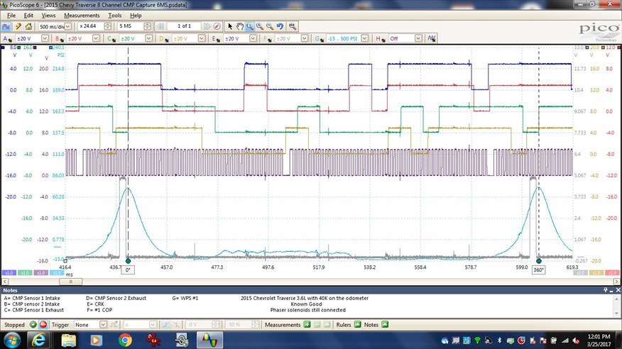

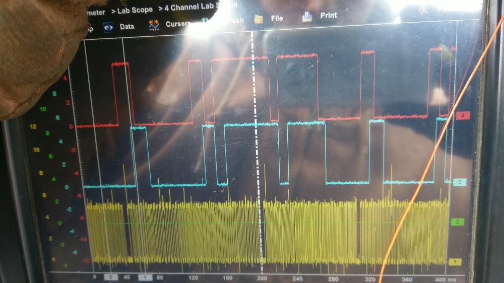

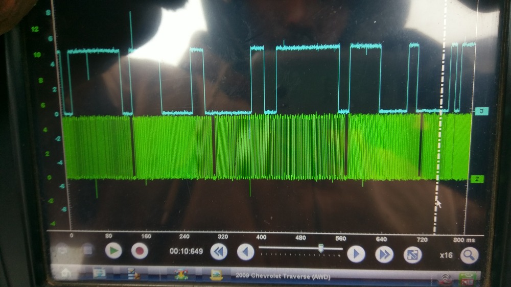

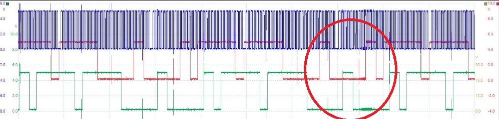

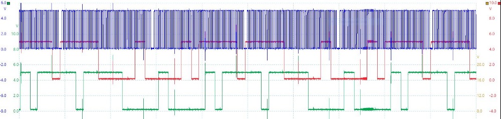

How close is close enough? was created by jsvets2326
Check out these Cam crank correlations and let me know if you think timing is off they are real close but how close do they have to be, I have no codes set for Cam crank. The Pico scope captures (white background) are known goods but from different years 2010, and 2015, the verus is 2009 which may have stretched chain just barely, this is Chevy traverse with 3.6l gdi LLT. The one verus capture with the crank and only one blue Cam signal that is the intake Cam signal. Let me know if you have any questions of what your looking at.

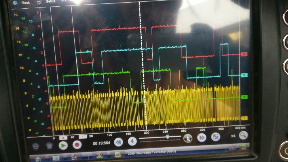

Replied by jsvets2326 on topic How close is close enough?
The last pic with verus crank and two Cam signals red and blue they are both exhuast
This is from the 2015
