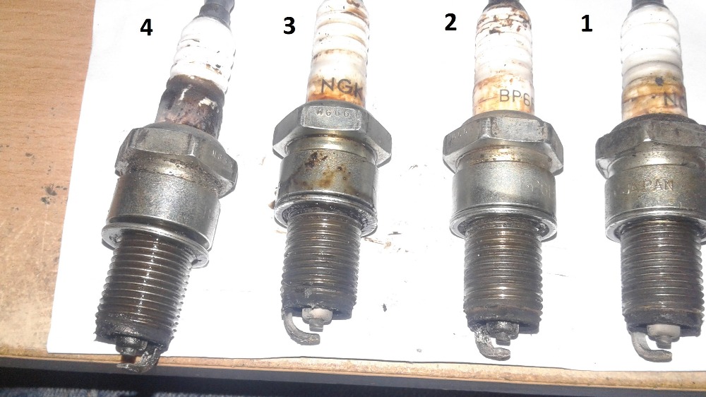

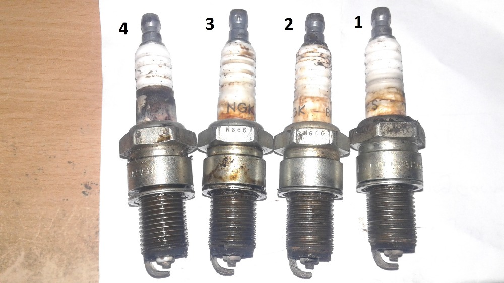

1989 Mitsubishi Lancer LB5H41 with 1.5 litre, 4G15 I4 8v SOHC CARB engine.
4 has a failed seal also why is the ceramic on the electrode so clean. coolant?
I see oil fouling on some of the plugs too. maybe coming from jet valve seals.
