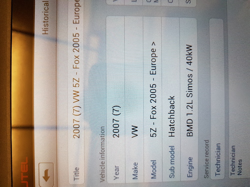

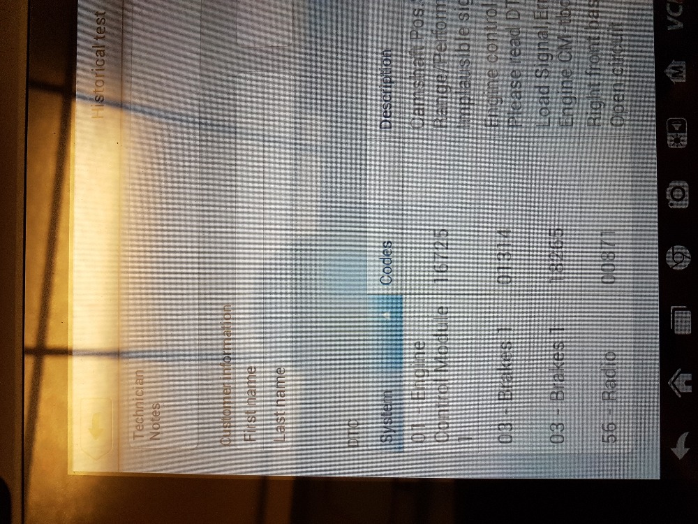

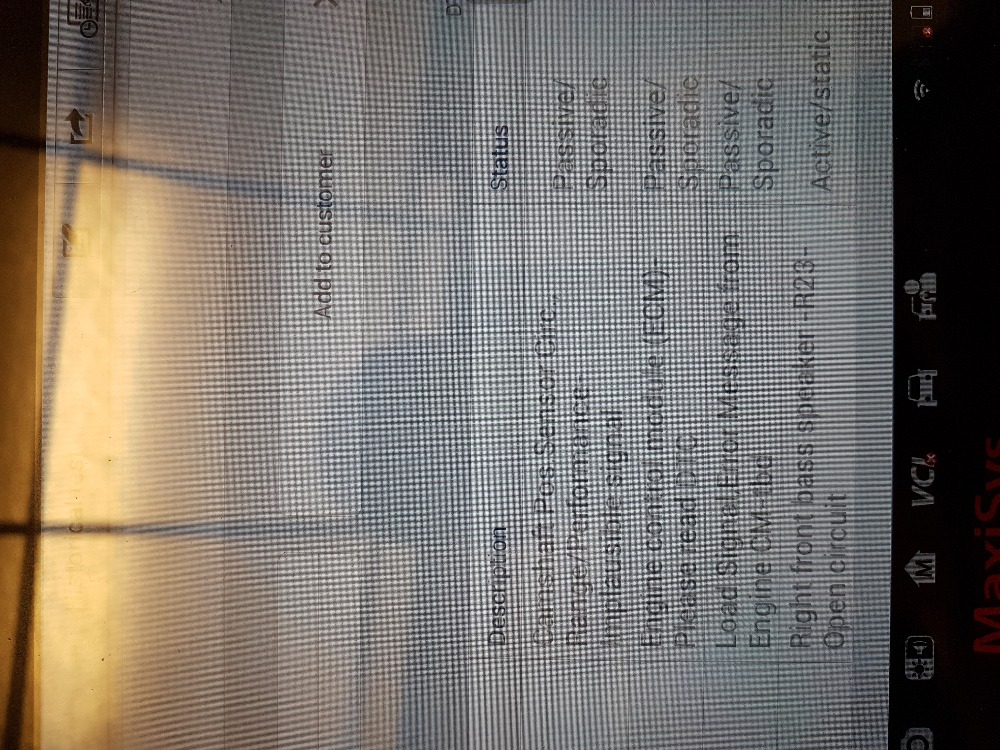

Its a VW fox iv attached a few pics of the faults and the vehicle model, ignore the speaker fault thats all sorted but theres the cam fault as initially described and also random other faults which dont make sense

Hi shooter, thanks for the reply, yh its is reading 2.5 at the cmp backprobed. Ill check the signal at the ecu. The make and model is a VW fox 1.2 56plate engine code BMD.

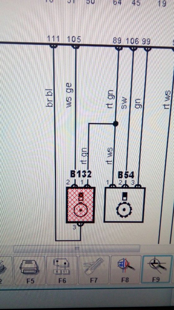

So with the key on sensor unplugged the signal wire reads 5v at the cmp backprobed. Also here is a wiring diagram of this ciruit, the cmp is the one in red and the crank is the one on the right.
Last edit: 8 years 7 months ago by sam12301.
