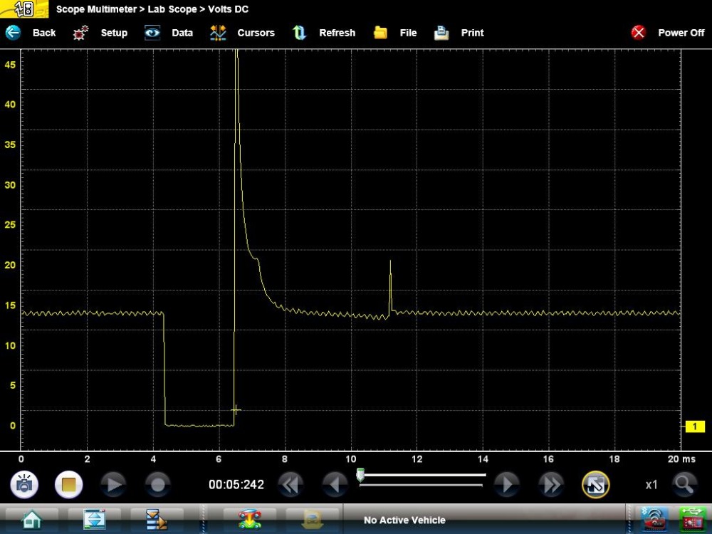

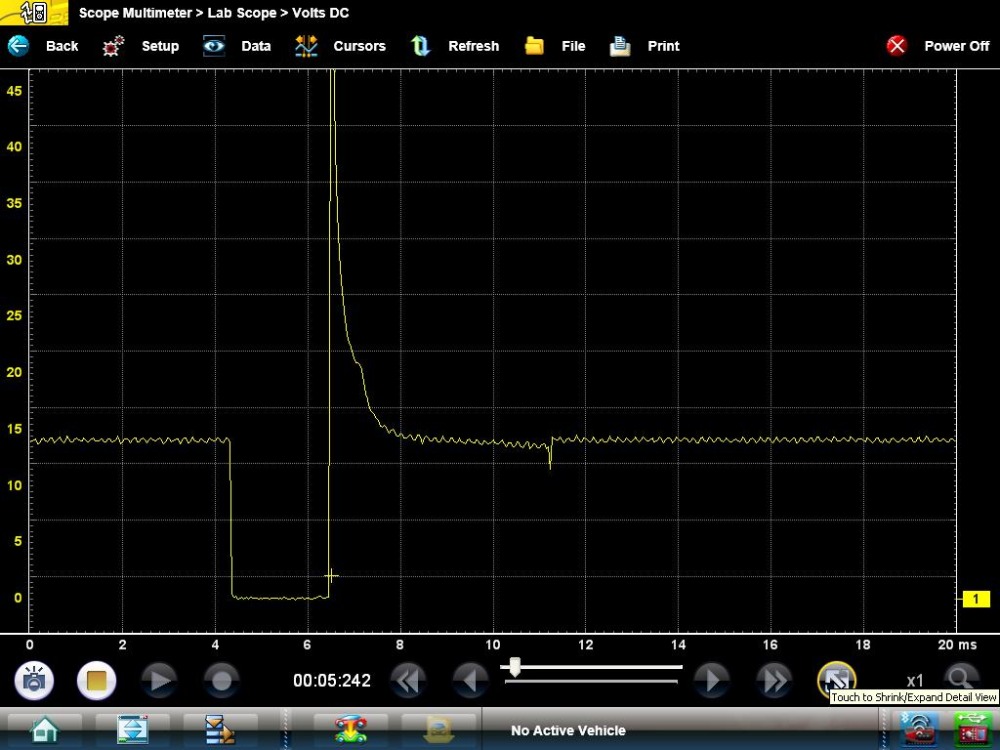

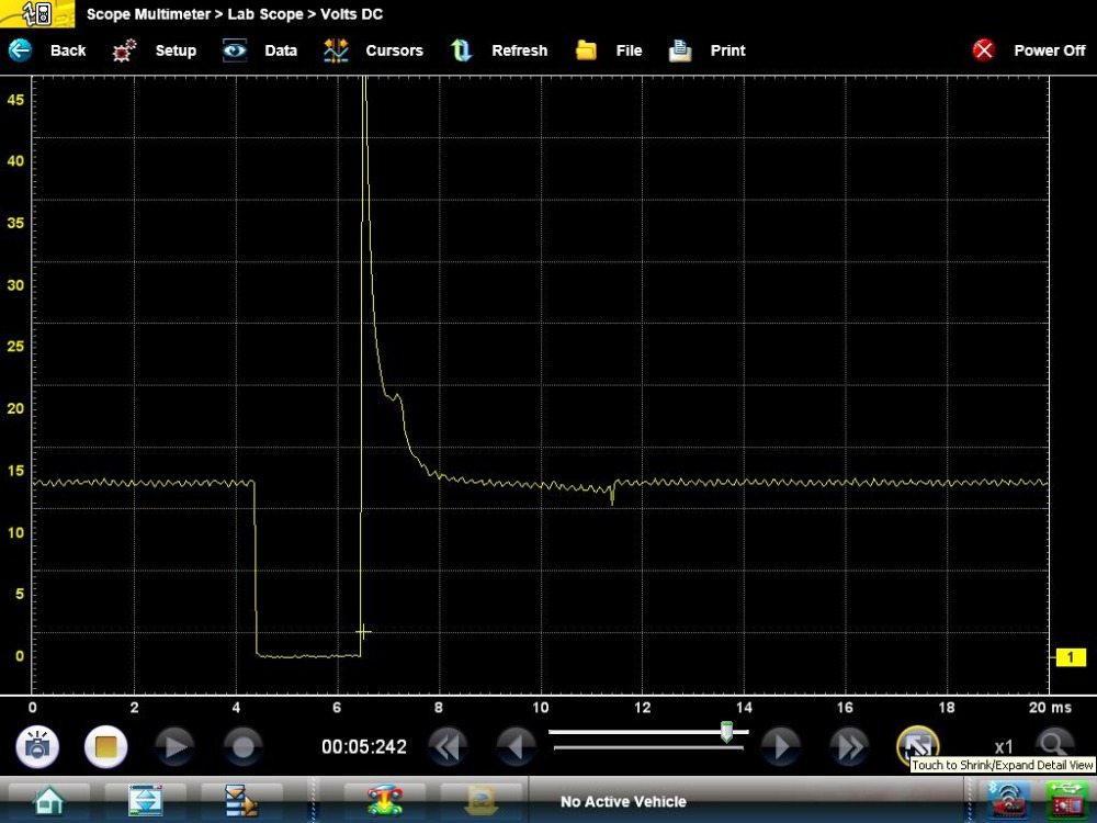

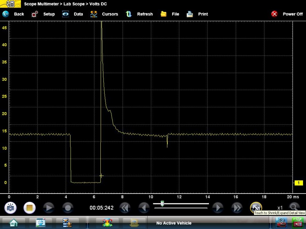

I am working on our 2006 Toyota Prius. I has been having an intermittent cylinder 3 misfire when the engine is cold, losing fuel economy and diluting the oil with gas. The compression ranges from 115 psi to 135 psi. Plugs are new. Attached are snapshots of the fuel injector waveforms from my verus. Do they look good? I"m Not experienced with injector waveform yet.

The injector waveform itself looks good, IMO. If you're working on an injector diagnosis, you could try swapping it to another cylinder and rechecking after a cold start. While you're there, I'd suggest pulling the plug and borescoping the cylinder before starting. It's not unheard of for head gaskets to fail on these, leaking coolant into the cylinder.
