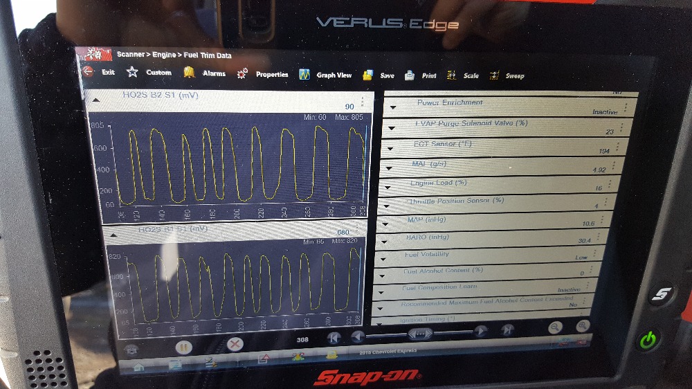

Vehicle came back in today for emissions, they ran it and it got a rejection from testing for insufficient monitors not being set.
Evap monitor has finally set on the car. O2 and HTR are still not ready.
It can pass state emission with at least 1 monitor not being set.
Airflow was showing 5-6 g/s in idle. I compared to a 2015 Express with same 4.8L and it seemed to be about the same.

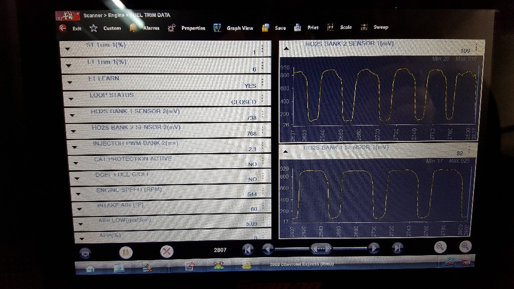

Last visit I used the Autel to graph out the primary O2's and it looked okay. Today I ended up using the Verus and I did not like the primary wave forms. Now I can see why the mode 6 rich to lean switch time parameter is not happy. It is taking way to long to switch from rich to lean and vice versa. Let me know what you guys think. B1 S1 is the new sensor but seems worse than B2 S1.
Thanks for the video link, I will go over it today.
The second picture is of a known good vehicle 2015 Chevy Express 4.8L
