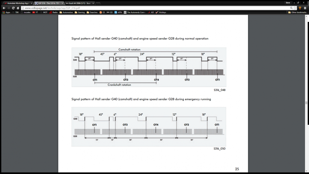

Hi everyone.
Does anyone have a known good cam/crank waveform for a 2.0 diesel Audi A4. Might be same a 2.0 for VW?
Thanks
Thanks

10 years 1 month ago #1819
by Doc
Replied by Doc on topic Audi A4 2006
Hi Mark, do you have an engine code?
Cheers
Cheers

- Doc
- Sharing the little I know
- Posts: 58
- Thank you received: 12
10 years 1 month ago - 10 years 1 month ago #1822
by Doc
Last edit: 10 years 1 month ago by Doc. Reason: added hyperlink

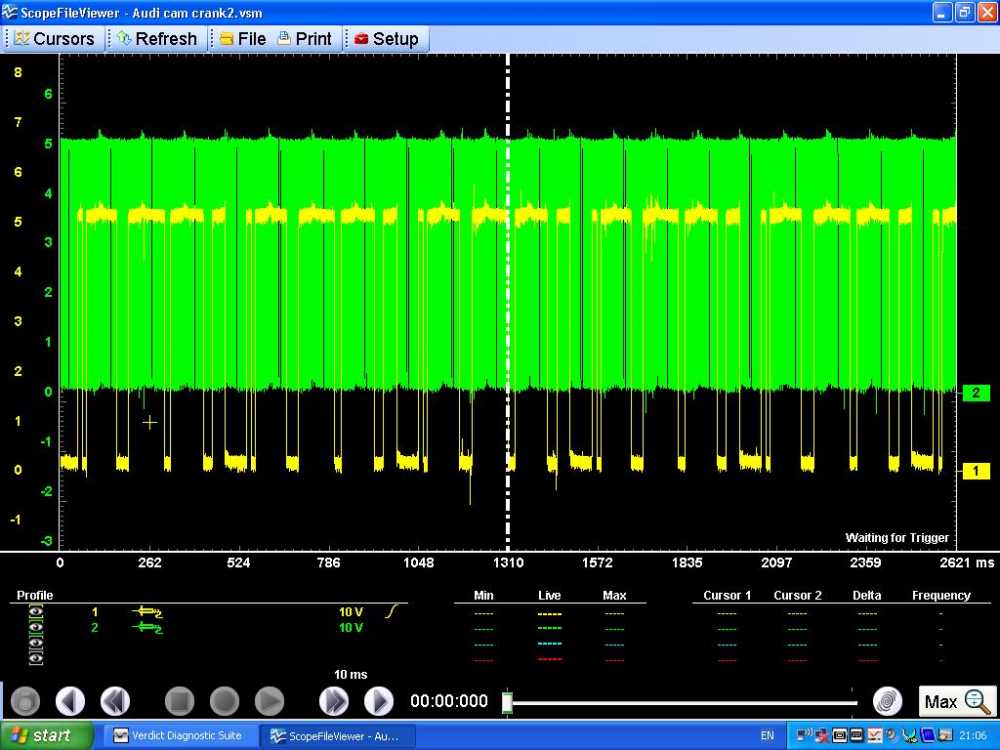

- Markm6164
- Posts: 10
10 years 1 month ago #1826
by Markm6164
Replied by Markm6164 on topic Audi A4 2006

10 years 1 month ago #1836
by Doc

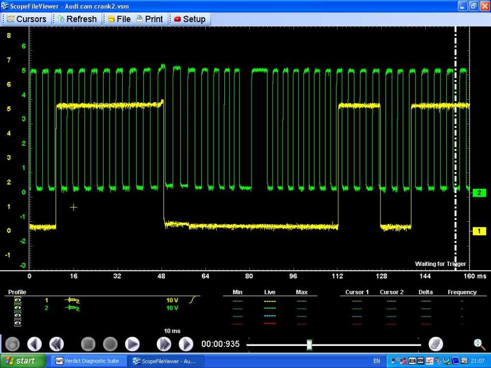

- Markm6164
- Posts: 10
10 years 1 month ago #1837
by Markm6164
Thank you Doc for posting this waveform.
