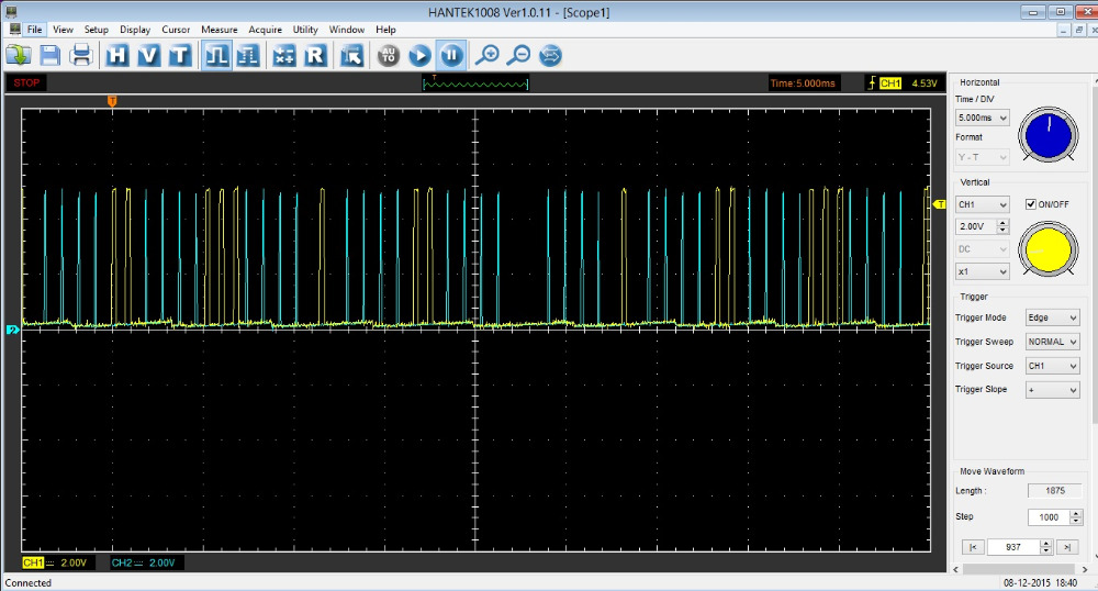

I have this 3.3 L Chrysler that intermittently cuts out. Happens very rarely and only when coming to a stop. I've tried to duplicate the fault by wiggling the wiring harness of cmp and ckp sensors but no luck so far. I noticed the van fails only when the engine is stone cold. When temperature rises fault disappears.
Here is the interesting part.

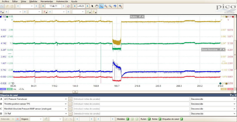

When I scoped the ckp and cmp I found a high voltage at ckp signal wire.
IMG 1.
When I unplugged the ckp sensor the signal voltage returned to 5 V.

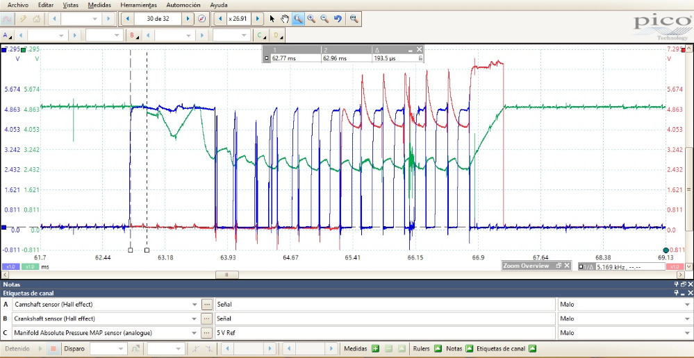

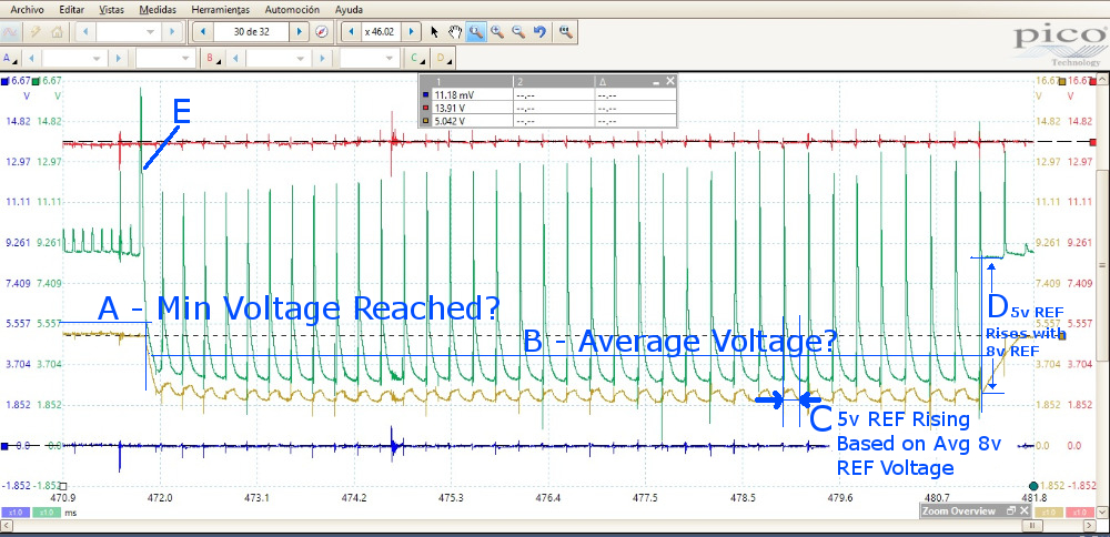

Then I scoped both sensors the moment the van stalled and found this.
IMG 2.
Both sensors where dropping almost at the same time so I figured the 5V or 8V ref circuit had to be involved.

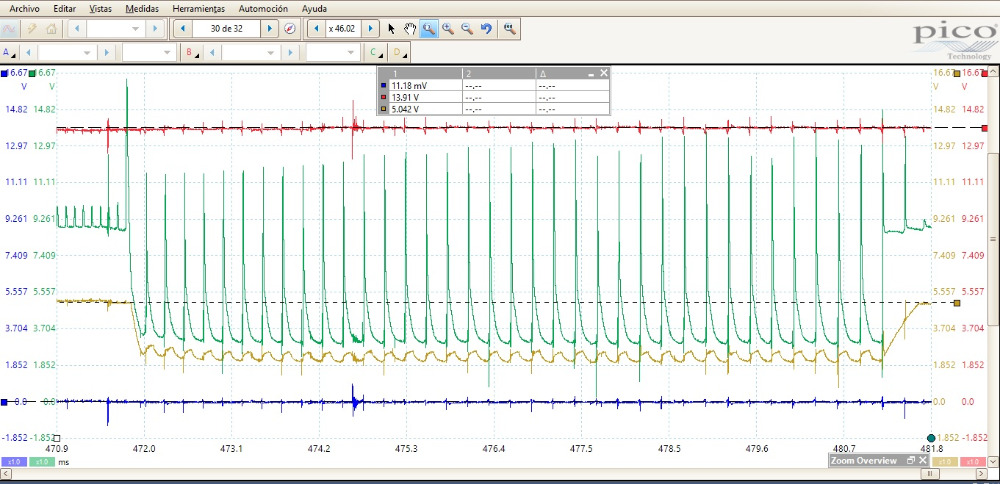

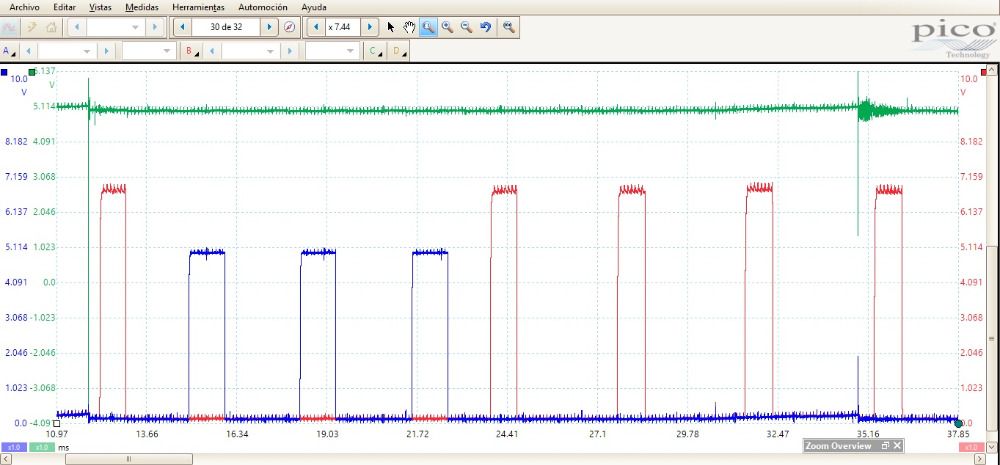

I then repeated the capture when the van stalled this time with the 5 V ref in channel C measured at the MAP sensor.
IMG 3.
The 5 v ref circuit had 2.5 V drop that caused the stall. When the vehicle stalled the MIL started flashing maybe this is a clue?

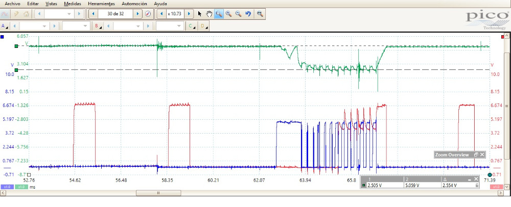

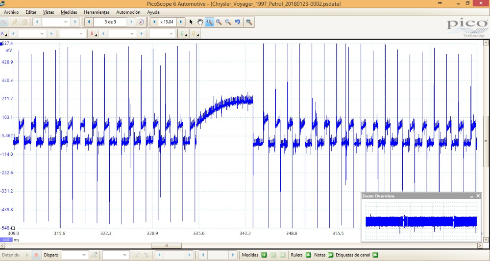

Following the 5V ref fault I scoped the signal from all the sensors that share the 5 V ref externally. The MAP, TPS, and A/C pressure sensor. This is the capture when the engine stalled.
IMG 4.
The A/C pressure sensor acted not as expected so I unplugged it and hoped that somehow fixed the problem… but stall continued. At this point my mind is everywhere.

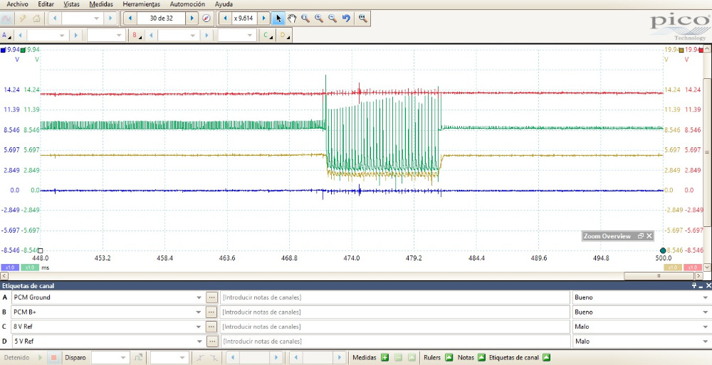

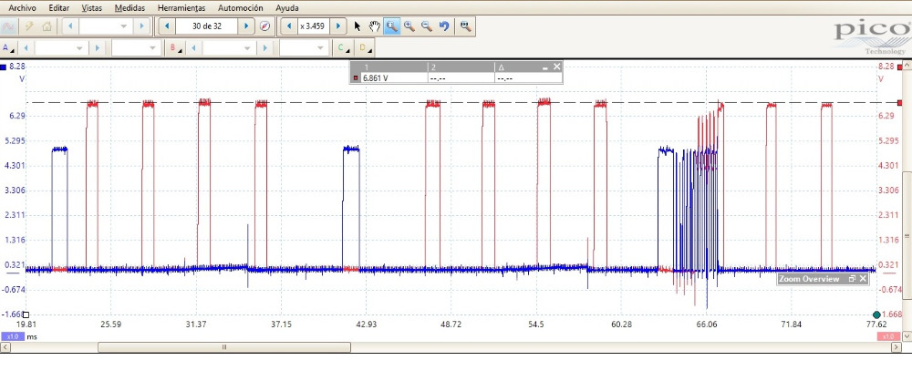

The last capture is from the PCM power, a ground, the 5 V ref and 8 V feed to cmp and ckp. This capture is when the engine stalled.
IMG 5.
Something is clearly wrong with this readings but I can’t find a way to blame the PCM.
And I can’t understand why in a circuit where only 5 V should be seen, I see 7 V with the sensor plugged in.

IMG 1
Yellow Channel : CKP signal
Pink Channel: CMP signal
IMG 2
Blue channel: CMP signal
Red channel: CKP signal
IMG 3
Green channel: 5V ref (measured at MAP connector)
IMG 4
Blue channel: A/C pressure sensor signal
Red channel: TPS sensor signal
Green channel: MAP signal
Yellow channel: 5V ref (measured at A/C pressure sensor connector)
IMG 5
Blue channel: PCM ground
Red channel: PCM B+
Green channel: 8 V
Yellow channel: 5 V ref
(all measured at PCM connector)

What is interesting is both the 8v ref and 5v ref are being pulled down at the same time. I would assume these are both completely different circuits in the PCM and would expect one or the other to fault, but not both. The 8v ref is extremely noisy before it craps out too and it doesn't just get pulled down, I see it spike to batt voltage and switch up and down a lot.
I am not too concerned with a bad ground to the sensors as all the signals are being pulled to ground but it seems they do rest around 800mv at the ground level?
What I am concerned with is the 8v ref is not reaching 8v at any time in the ckp/cmp signals and the CKP And CMP signals have different signal voltages when they are both supplied the same 8v ref in the first image below.
Im curious if inside the PCM, if the 8v and 5v ref are from the same feed circuit and connected in such a way where if one ref was shorted out it would effect the other.
I threw a cursor to measure V of ckp and cmp signals when pulled to ground and it reads 137 mV. A bit high you are right. Is this where you see a high ground voltage?
What I am seeing, and let me know if you see this too in the picture below, I am seeing the 5v (green) being pulled down at the same time the CMP Signal spikes up to 5v and then both have a similar pattern till the issue goes away. We both know that the CMP and CKP are supposed to have 8v refs, not 5v refs. Maybe something is shorted. I also see the CKP (red) signal has some odd anomalies when the even t is not occurring. At the tops of the rise, you see shark fines, almost like the voltage is getting pulled back down, maybe the 8v source is not strong enough to bring the signals to 8v, either due to a fault in the ref wire or a fault in the signal wire.
This is a zoomed view of the event. The CMP signal (blue) goes to 5 V then the 5 V ref (green) fails some micro seconds later.
I also went back to the buffer to take a closer look at the ckp signal (red) and you have a good point! it's very different from the top of the cmp signal (blue) rise. I also found some weird noise on 5 V ref (green). Is this noise ignition related?

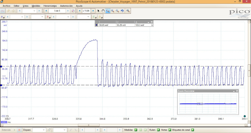

Years ago I did a known good capture of this vehicle ckp-cmp sync.
Both CKP (blue) and CMP (yellow) have 5 V signals being pulled down by the sensor. Thats why I think that in my new captures the 7 V signal from the CKP (red) is bad while the 5 V signal from the CMP (blue) is good.
My understanding of the ckp and cmp sensor circuit for this vehicle is like this and correct me if im wrong.
Both CMP and CKP sensors share a 8V feed, a ground and both have pull-down designs. So the PCM feeds 5 V to the signal wires which are grounded by the sensors to make the square wave. When the CKP sensor (red) is plugged it produces a 7 V square wave but when its unplugged the voltage in the signal wire returns to 5 V. How can this happen? and also why the shark teeth noise? I agree with you it should be a short to power of some sort.

8 years 9 months ago #17111 by graywave
Replied by graywave on topic 5V ref problem with 1997 Dodge Caravan 3.3L
With your zoomed in image of that problem area I can easily see that the B+ feed was not pulled down to 8v like I thought it was. So that gets rid of some confusion there.
I do need to look at some reference material. I just learned something new in your thread and that is older Chryslers seems to use 2 separate reference voltages for the crank and cam sensor. 8v feed to the sensors, but a 5v signal supply to the sensor as the pull down. I got mislead by the material I was reading and did have some confusion when you mentioned it was a 5v pull down. With that said, I need to do some research before giving some more advice.
Regardless though, I don't like the 8v ref being pulled up to system voltage. I did watch a video from Mr. Danner and he had mentioned since the VSS is supplied with the same 8v ref, apparently it has a history of shorting the 8v ref out and disabling the vehicle. I don't exactly see that in your pictures, but I do see the 8v ref being pulled to around 2.5v. Maybe that is the regulator grounding the reference to try and bring the voltage back down and it is just a circular effect. In the wiring diagrams I have, I see the "Output Shaft Speed Sensor OSSS" leading to the TCM which then sends a VSS Signal to the PCM. The OSSS has a power and ground. The power I am guessing is 8v?
I'll post again soon but this is where knowing PCM internal circuit design would really be beneficial. I have a theory but that is all it is and I"ll edit your picture so you can understand what im talking about more. I am really hoping someone with more electrical engineering background can chime in and correct me if I am way off in left field. Maybe I am thinking to much here too and making it more complicated than it has to be. My theory is, that the 5v REF is regulated off of the 8v REF. Meaning, if the 8v REF is shorted to power (regardless of how or where) and the regulator see this, grounds the circuit or does what it needs to in order to bring the circuit back down to 8v, is it possible it can bring it to far below 8v and will then drop the 5v REF??

I found the following pins.
PIN 6: B+ FROM ASD RELAY (DKGRN/ORG)
PIN 10: Ground (BLK/TAN)
PIN 20: B+ START/RUN (WHT/BLK)
PIN 46: B+ (RED/WHT)
PIN 50: GROUND (BLK/TAN)
I missed those pins! Thank you for pointing that out.
I tried to capture the event 2 days in a row but the vehicle now won´t stall.
I saw normal voltage readings at pin 6, 20, and 46. (Battery voltage)
PCM Grounds at pins 10, 50 and sensor ground pin 43 all under 33 mV.
All readings at normal engine operation.
I also checked for opens and shorts between 8Vref and 5Vref, 8Vref and ground, 8Vref and B+, 5Vref and ground, 5Vref and B+ and even 8Vref with all other pins on PCM.
I did test with all sensors, TCM and PCM unplugged.
All wiring tests good.
CKP and CMP were replaced about a week ago in an attempt to fix the stall issue and the 7V CKP signal.
I think the high ckp signal voltage is related to the noise in 8V ref circuit... but why it’s not affecting the cmp signal??

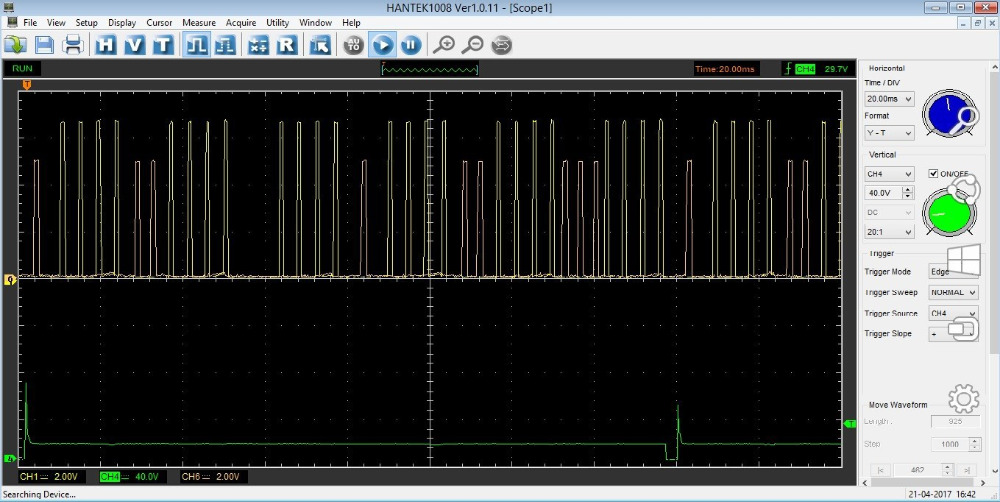

About the VS Signal ok, so I see it comes from the OSS sensor. This sensor is a two wire variable reluctance sensor ??? or a magneto resistive sensor?
This is a capture of the OSS sensor signal with negative lead on battery ground. I’m not very familiar with this type of signal
If the sensor is a VRS how is the 8Vref involved if those sensors produce voltage?
  • graywave
  • graywave's Avatar
8 years 9 months ago - 8 years 9 months ago #17222 by graywave
Looking at AllData, the OSS (output speed sensor) does appear to be a VR sensor and therefore doesn't need the 8v ref. You can check though, you should have ground on one side and I think 0v on the other as your signal wire. Just for reference I'm curious if you have any voltage on the signal wire? Though that signal looks VERY dirty and doesn't look right. VR signal should be a wave signal I would think. The middle of that looks closer to what I would expect. That could be possibly a bad ground on your scope? Maybe ground the scope through any sensor ground. I'm not trying to say the OSS is a culprit, I'm learning the system from a very far stand point. Maybe the circuit Paul was talking about was from a vehicle with a slightly different circuit.
So, I don't have any other suggesting at the moment. I know bad powers or grounds can cause some really crazy stuff to happen especially intermittent problems. Could a bad PCM ground cause the 8v regulator to malfunction? In my mind, absolutely. Could a bad power cause a 8v regulator to malfunction, I think it could. The spike surges we were seeing might have been caused by a bad ground or power, allowing the regulator to be switched on and off rapidly. This is where my knowledge on circuit design starts to send me sideways. Now why didn't we see the same thing happen with the 5v voltage? I can't explain that completely but I'll expand my theory below
I did some reading and watching of videos about voltage regulators. If they use a 3 pin linear voltage regulator, Pin 1 as INPUT Unregulated Voltage, Pin 2 as GROUND and pin 3 as REGULATED OUTPUT (may not be that order), then if the regulator looses its ground, the regulator may not be able to measure the difference in voltage correctly and might allow system voltage (unregulated voltage) to pass through. Without a ground, there is I guess, bias current that may bounce within the regulator which could cause the up and down spikes we saw? I would think something like that though would be more of an oscillation like in a ignition coil at the end of spark. Again don't quote me on that but this is my light understanding. Now going from 13.5v to 8v is more efficient than going from 13.5v to 5v. So using a linear voltage regulator on the 8v regulated output might be more efficient at creating the 5v REF circuit as there is less of a voltage drop. This would make sense seeing the the waveform below as linear voltage regulators have a minimum working voltage and explain it as linear drop out voltage. The 5v regulators I have seen online have a 2v drop out voltage meaning the regulator needs at least 7v to work properly. Those same 2v drop out regulators may be able to handle lower voltages and stay running properly. I am sure the documented drop out voltage even has an error tolerance. Now in the image below, you can see that its possible, if the circuit is designed how I think, that the drop out voltage of the 5v regulator could be less or maybe we just don't see enough detail to get an accurate representation of where the 5v started to drop at in comparison to the minimum 8v ref voltage reached.
So could a bad ground be the culprit? I think so. Could a bad power feed cause an internal relay or some sort of ground control device to deactivate and cause an internal ground problem to the regulator and cause the same issue? I think so. If we had a bad, low power feed to the regulator, you would see the output regulated voltage become unregulated and continue to drop to a certain point. If we lost the power feed, we would also loose the regulated voltage output. See how I am thinking of a ground issue?
I'll list what I don't like and hopefully this will be some food for thought in terms of direction. If I think of anything I'll let you know.
1. 8v REF Signal rising to system voltage during the event (Finger Pointed Here)
2. 7v Crank signal on a 5v signal wire. Disconnecting crank sensor allows voltage to return to 5v. I would check continuity between the signal pin and power feed pin on the crank sensor. I don't think there should be any continuity. Maybe even disconnect the crank sensor, manually apply power and ground to ground and power pin and see if you measure a voltage output on the signal pin. Just wondering if there is in fact voltage leaking (Could become a problem but "may" not be the culprit)
3. 5v REF dropping at same time 8v REF wigs out. (Thinking an effect of the 8v REF problem)

Try AC Coupling the scope and measure the 8v REF circuit. I wonder if that noise could be AC voltage. Any AC voltage will be added on top of the constant DC voltage. Though i would expect to see that ripple everywhere on the system
If anyone else out there has some idea or if I had given some misinformation, please by all means correct me.

Possible user error? ? Ground loops? ? As your dealing with VR sensors make sure not to hook up to bòth wires of one sensor while you're using more than one channel....use one common ground for all channels.
8 years 9 months ago #17276 by Eliud
juergen.scholl wrote: Possible user error? ? Ground loops? ? As your dealing with VR sensors make sure not to hook up to bòth wires of one sensor while you're using more than one channel....use one common ground for all channels.
I was using only channel A. Negative lead to battery ground and positive lead to TCM connector pin 14 output speed signal.
This is the same capture with a 1 khz low pass filter. Is this a bad capture? Is I said before I'm not very familiar with VRS signals.
A 1kHz low pass filter is too much? I'm not very familiar with those features.

Looking at that waveform now that it's cleaned up, I would still try to grab another capture with a better ground. This will contradict what I said earlier but all the short AC ramps is what I would expect and what I am used to seeing from VR sensors. It should be very similar to most wheel speed sensors that use VR sensors. So that large ramp in the middle, I think earlier I was confusing this with a graphing meter. That large ramp from my experience, shouldn't be there if this comes straight from the sensor.
I don't know if that was just a fluke or associated with the problem you are having, but more repetition would be good in that capture. More time base to see if that ramp occurs more often. More curiosity than anything, I don't think this is the direction to go for the diagnosis but I see a possible problem, so it should be investigated to see where it leads.
Mr. Danner has a video regarding this type of sensor used as a wheel speed sensor
Another quick little video
Last edit: 8 years 9 months ago by graywave.
