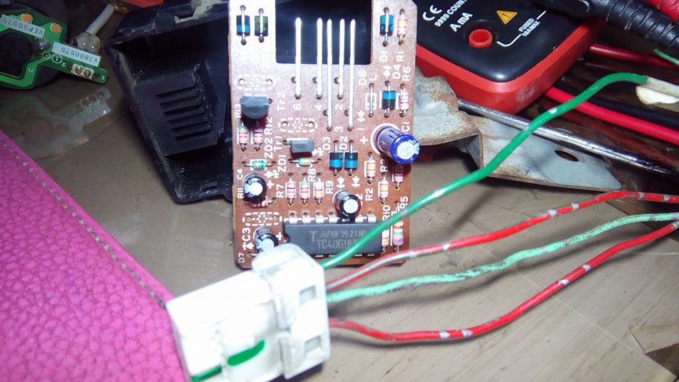

Good Day Guys, Im Carl i need your help about my repair shop
i have nissan sentra speedometer problem, and i dont know how to wire speed sensor its "2 wire " i belive VRS type ?
correct me if im wrong, SPEED SENSOR>module>instrument cluster?
or speed sensor>direct to instrument cluster?

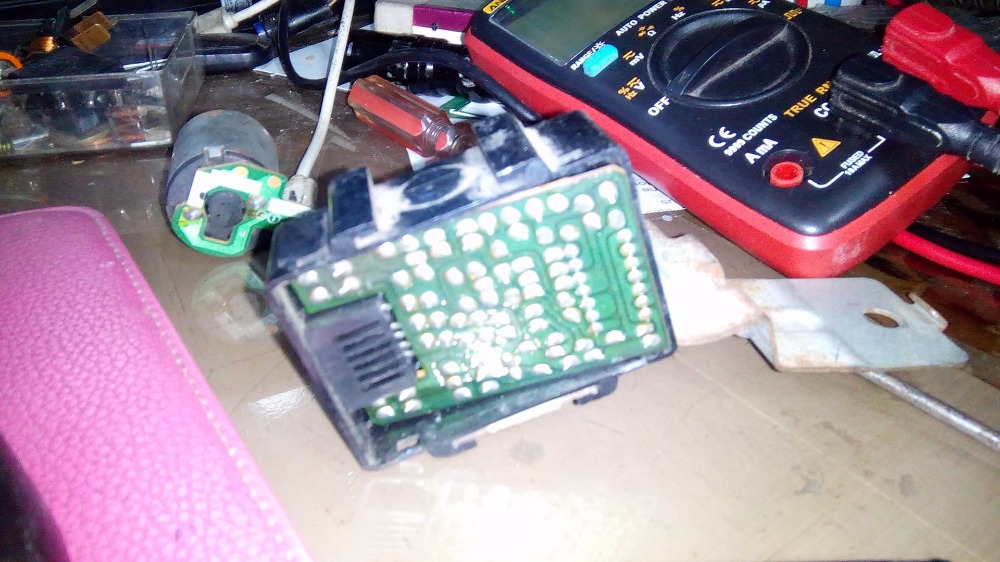

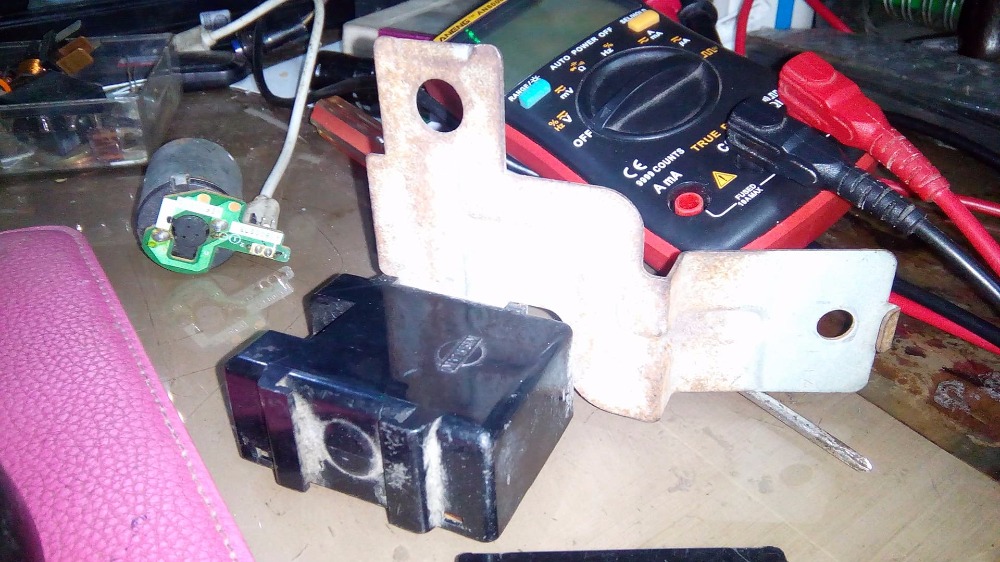

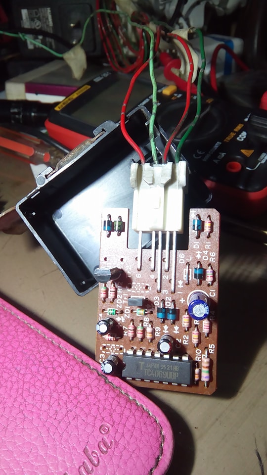

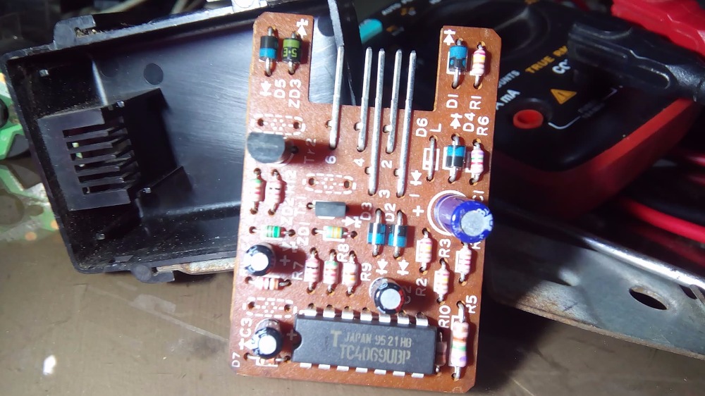

here are the module im not sure is this the module to speed sensor > module >instrument cluster
- 4 wires
- small red wire
- small light/green wire
- small red/green wire
- small green wire
guys i need your help please i wait for your reply More Power ScannerDanner GodBless
Thank You More Power Again.

Hello MOD, Thank you for you reply, my sentra is "carbureted" and its not ECM .
my speed sensor is located on the transmission
