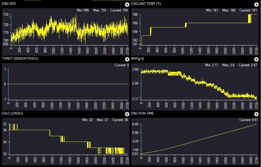

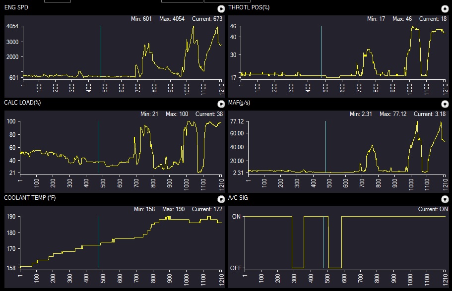

So I ended up going through my records, looking for a US market Toyota with the same engine to compare to. Turns out, they don't sell the
3ZR-FE
in the States
Then I got annoyed at all the cool engines we don't get over here, but that's a different thread.
The closest I could find to that engine a 2.4L out of a Camry. Turns out, with the AC on, it actually did have a 38% Calc Load at idle. Higher than I expected :huh:
Also found a 1.8L 2ZR out of a Corolla. Similarly high-ish Load at idle, AC off.
Cyrus, do you recall which (if any) accessories were on when you saw the 50% Load?
