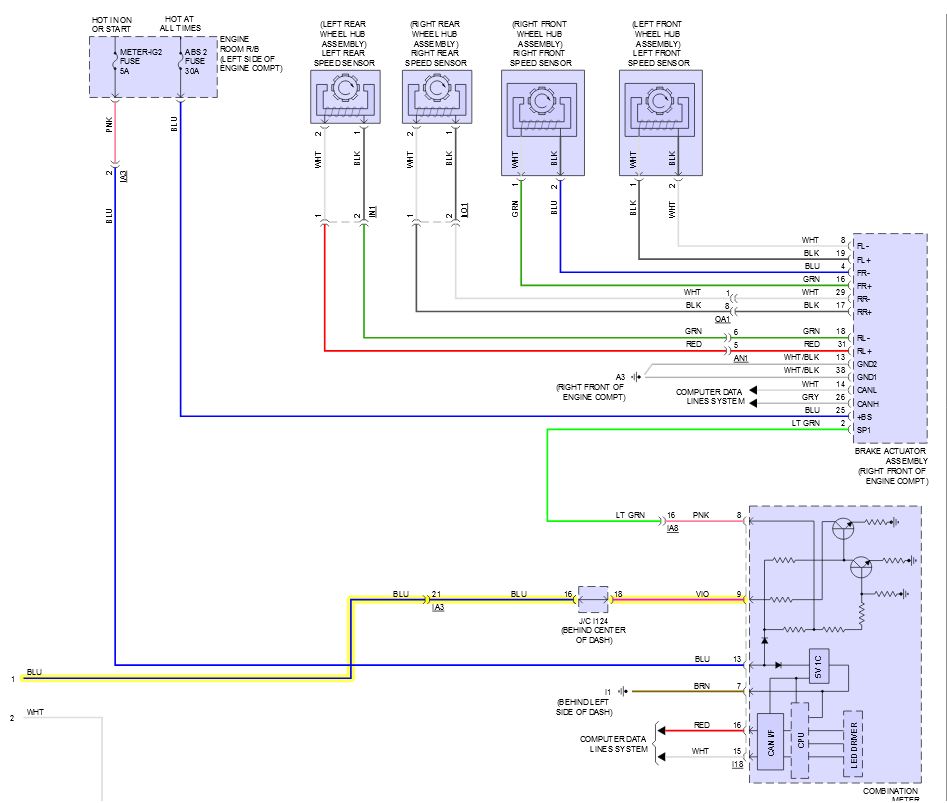

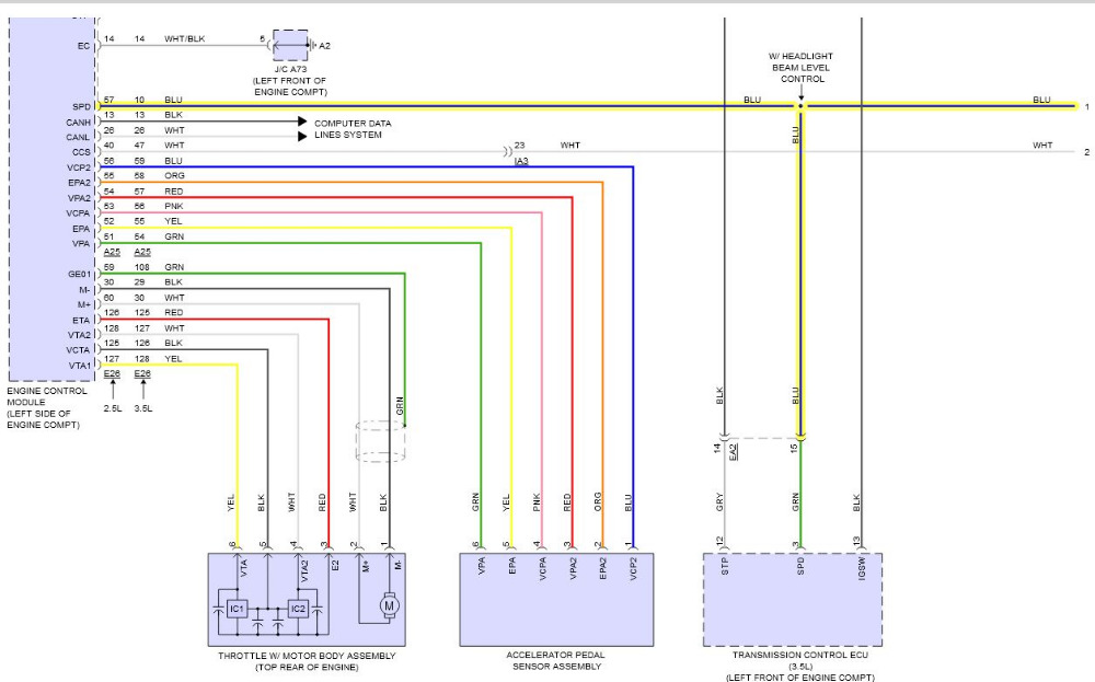

Dears,
I am currently diagnosing a toyota camry 2012 2.5L engine. The speedomter isnot working. I used activation test on Gscan2, it is working.
I know this meter must receive signal from vss but I dont know the location.
Any help to fix this issue?
Thank you in advance

I could be wrong, but it looks like Brake Actuator Assembly receives Wheel speed from all 4 wheels. The Brake Actuator Assembly sends a speed signal to the Combination Meter.
8 years 10 months ago #16325 by Andy.MacFadyen
Replied by Andy.MacFadyen on topic Camry LE 2012 Speedometer not working
Normally on systems I have encountered the ABS module passes on only one of the wheels speed sensor signals to the instrument cluster
