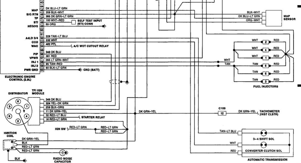

You can do an injector balance test if you want to check them. You would need a fuel pressure guage and a way to pulse each Injector, watching for the fuel pressure to drop the same amount on each Injector. You can buy a tool online for about $40 that does this.

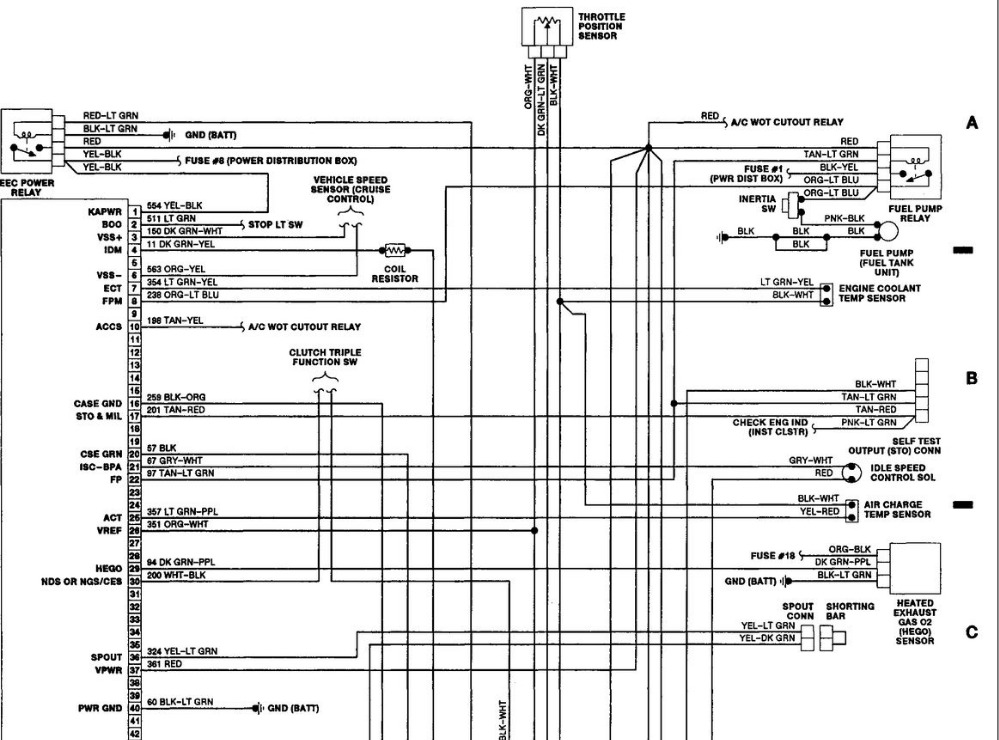

I have a fuel pressure gauge --what kind of tool are you talking about?? I saw one of SC,s video done on a GM with a fuel pump test plug and a tool -- mine does not have a test plug-but I could use the key on -off. I saw a schematic on another problem answer but can't seem to find it again--I need the color codes.
I also have another slight problem--the person who owned this before tore loose the main harness that contains all the injector and other sensor wires and is just laying on the hot lower manifold--I need to see something to show me where this was routed and to what ??
