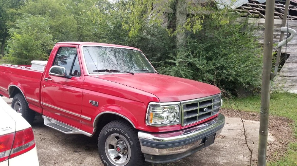

Hello everyone.
I wanted to share the issue I'm having with my truck and get your expert feedback. I've been working on diagnosing an idle/misfire issue with my F-150 for about 2 months now.
i left this truck sitting all summer at my family's house while I was Hiking the Appalachian Trail. when I came back I drove it around for a few weeks until one morning it shit the bed on my way to work.
I've sent it to multiple shops at this point and they have all turned me away saying they don't have time for my issue; out of a mix of frustration and desperation, I decided to try something different. I used Claude (an AI assistant) to help walk through the diagnostic process.
I want to be clear - I'm genuinely looking for help solving this issue, but I also thought the community might be interested in seeing how AI can assist with automotive diagnostics. It's not meant to replace professional expertise, but rather to show how it can help organize our thinking and create structured diagnostic approaches.
Here's a picture of the truck along with a summation of the diagnostic process Claude helped me work through:
Keep in mind that I had Claude generate the following info. i tried to proofread it so it didn't read weird, but I'm not a technician so if there is anything wrong please correct it!

A little confusing but I agree. Low to no reference voltage is absolutely your problem.
Before you replace that PCM:
1. a shorted sensor that shares that 5v ref can pull it all down (TPS, AC psi sensor, MAP, EGR psi sensor or position sensor)
2. All powers and grounds must be verified at the PCM. Key on, backprobe and measure voltage. Should see battery voltage on the feeds and less than 50mv on the grounds
3. If the above is good. Replace the PCM. This is a common failure now as the capacitors on the PCM board are all leaking now and destroying the boards. This did not happen on these back in the day. This is a relatively newer type of failure on these older EECIV Fords

Paul, thank you for the reply and information! I've been a fan of your's since I was a stupid 19 YO working in a parts shop!
Anyway, for an update on the truck.
I ordered some wire probing leads for my multi-meter. went ahead and tested for a short on each sensor exactly as you said.
having not found a shorted sensor I went ahead and backprobed the PCM.
I wasn't sure what pins to check so I uploaded a picture of the wiring diagram for my truck out of my old Hanes manual in Claude's context window.
-note- I had it pretend it was a weathered Ford tech from the 90's, for fun
anyway; here is what it determined I needed to do to test the PCM:

Update: the new computer arrived, and the truck now runs fantastic. actually better than before.
The implications for AI having a place in this industry are pretty scary. I'm below journeyman level...amateur. I just had AI walk me through step by step; exactly what to test and why and it was correct then in the final diagnosis it was accurate.
