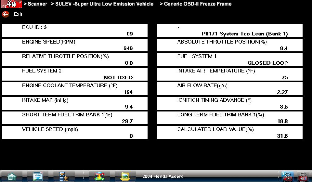

Hello,
I'm new to the forum and new to auto diagnostics in general and am looking for a little advice.
2004 Honda Accord 2.4L AT - Check engine light on, code P0171 - Fuel Metering Too Lean -
Drives perfect with no apparent symptoms other than the light. No misfires or hesitation. Has a minor pulsing vibration at idle but otherwise stable.
Performed a smoke test and found no vacuum leaks. Valves lash was recently adjusted and is within spec. ECT is normal and always between 190-210F in closed loop. IAT reading is normal as well. I don't think its a fuel delivery issue because the car shows no power loss and drives great.
STFT is positive 20ish %.
LTFT is positive 18ish %
Raising the RPMs seems to lower the STFT single digit number but soon returns high after RPMs stabilize. LTFT drops a couple points but always remains in the high teens.
MAF numbers seem to be responding normally. I am new to AF sensors but they seems to adjust normally when i create lean condition/rich condition. Lambda is always close to 1.0 but the fuel trims remain high.
I provided some screen shots of testing I performed. I can provide additional screenshots if needed on request. I'm not sure where to look next and any advice would be greatly appreciated.

Thanks for your reply.
The STFT lowers when raising the throttle only temporarily. After holding it steady at 2500 rpms it climbs right back to high numbers. The LTFT stays high always.
I checked the Purge valve and its not leaking or open. At idle, I disconnected the hose that runs from the purge valve to the TB and sealed off the open TB port with my finger. STFT went down only a few points but remained high around 20%.
Did a similar test with PCV. Closed off the hose and trim did not normalize.
Saw no leaks near the brake booster during smoke test.

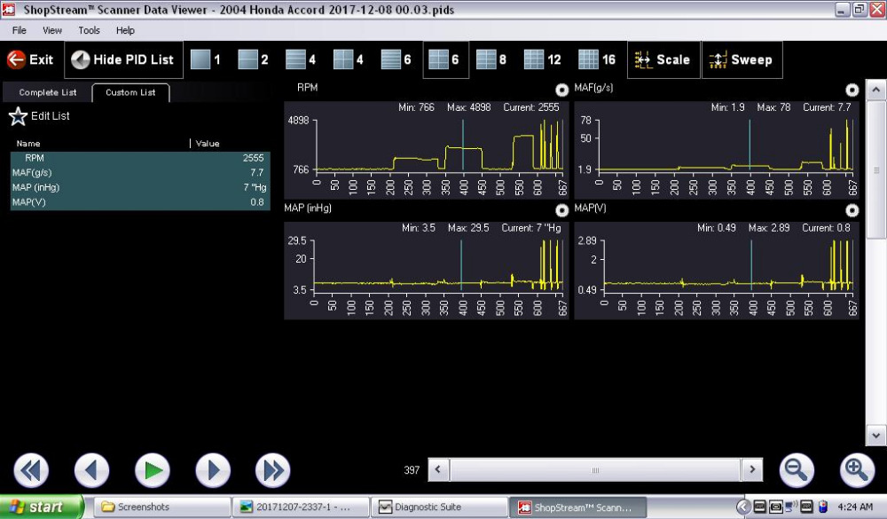

Never mind I see it in the first post I missed it first time through. Can you get maf voltage on the graph and see if it makes it over 4.0 v on a wide open throttle run ? I see were reading 1.9g/s at idle I normally expect to see 2.5 g/s but that can vary slightly the next step is to check peak voltage

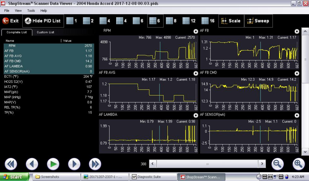

Is it normal for an AF sensor to remain at lambda when the fuel trims are pegged lean?

Actually I looked and there is no data PID for MAF voltage available, only g/s.
What you are seeing with the MAF at 1.9g/s on the min scale was only momentary. It most likely happened when I pulled a vaccum hose to induce a lean condition and the engine stumbled and almost stalled.
At idle its normally around 2.2-2.5g/s. 2500 rpm around 7.7g/s. 4500 rpm around 17-18g/s. According to the Honda FSM these numbers are all within spec.

Maf numbers look a little low to me. Did you clean the MAF sensor?
Is there an update program or "flash" for the engine management computer?

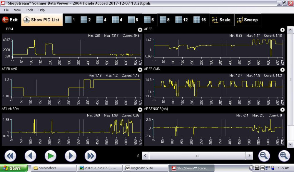

Does this car use wideband O2's on the upstream? One thing I have learned about these Hondas is that the O2's can get skewed over time and mileage. If this thing has over 125K on it I'd recommend replacing both O2 sensors with new Denso (the OEM) sensors. I realize this is a parts cannon approach but I found a similar scenario with my 2008 Odyssey.
I had higher than normal fuel trims (in the 15-20% range on both ST and LT) but not yet enough to set a lean code. The numbers didn't change with increasing RPM but I checked everywhere for vacuum leaks anyway and found nothing. MAF numbers showed good. I didn't check fuel pressure (Honda makes that difficult) but I could make the downstream O2's go rich on WOT so didn't suspect fuel delivery. Since it was my own, and I had 170K on the vehicle, I opted to replace both upstream A/F sensors with new NTK (the OEM) sensors. I initially saw an improvement on the fuel trims but when I checked the vehicle a few days later I found it back to around 10-15% on ST and LT fuel trims, still some improvement but not as much as I'd wanted.
I then opted to replace both downstream O2 sensors with new NTK's. After replacing both downstream sensors and doing a PCM reset with the scan tool I saw great improvement. After a week I was seeing slightly negative fuel trim numbers and the vehicle has been running perfect every since.
The odd part of it is the sensors passed every test that I knew of. I was able to make the downstreams go lean and rich as they should. However, after replacing all four everything was back to normal and the car runs like it did the day I drove it off the lot with 6 miles on it back in 2008.
The downstream sensors in these cars DO contribute to fuel trim so if they are skewed in any way, or if the upstreams are skewed, it will send bad data back to the PCM. Combine that with the increased difficulty of diagnosing wideband O2's that are used in the upstream position and it really threw me until I took the guess and put four new O2's in the car.
I know this is not real helpful from a diagnostic standpoint but if those O2's are original and have a lot of miles on them I've found it's a good idea to swap them out. I had an 09 Pilot come in w/155K on it, with increased fuel trim numbers and complaint of reduced fuel economy...replaced all four O2's on that rig and saw the same fix.
