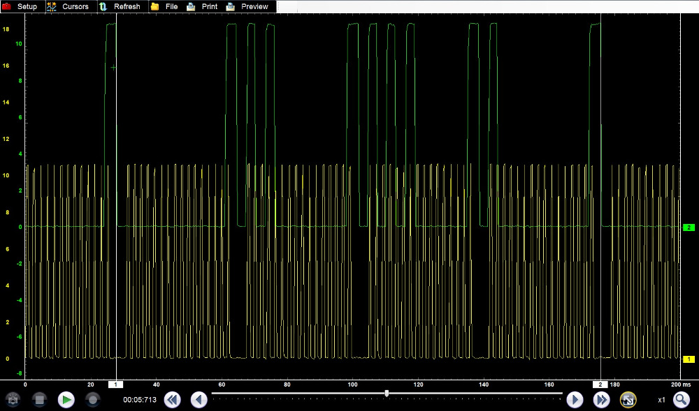

How many miles on this one? I ask because my first thought is a timing issue, especially when hot. I understand that the CMP isn't needed to start, but I do know that the ECM can get confused by timing or chain stretch problems, resulting in no spark/injection pulse. In the past, on the 1.8L engines, the trick was to disconnect the CMP and see if it'll start. I'm not positive that still applies to the 2.5L.
You could scope both the CKP and CMP and see what the timing looks like before digging further. I don't have a cranking capture to share, just an idling capture off an '06.
My other thought is with 'sync' issues between old (the CKP) and new (CMP) sensors. I've never witnessed this, but I've heard from other techs that intermixing sensors on the 2.5L and 3.5L engines can cause issues due to differences in sensor performance. Not enough to gamble on a new CKP, I know, especially because the CKP is the tough one to replace. :silly:

Thank you for the input and the KNOWN GOOD, Tyler!
This car IS up there in the miles. Closing in on 220,000, if I recall correctly. I will get it back in and check CMP/CKP correlation.

Side note, I always appreciated how Nissan built the firing order into the CMP waveform. :silly: One of those cam/crank setups that makes logical sense when viewed on a scope.
