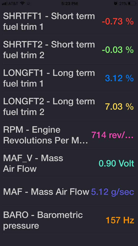

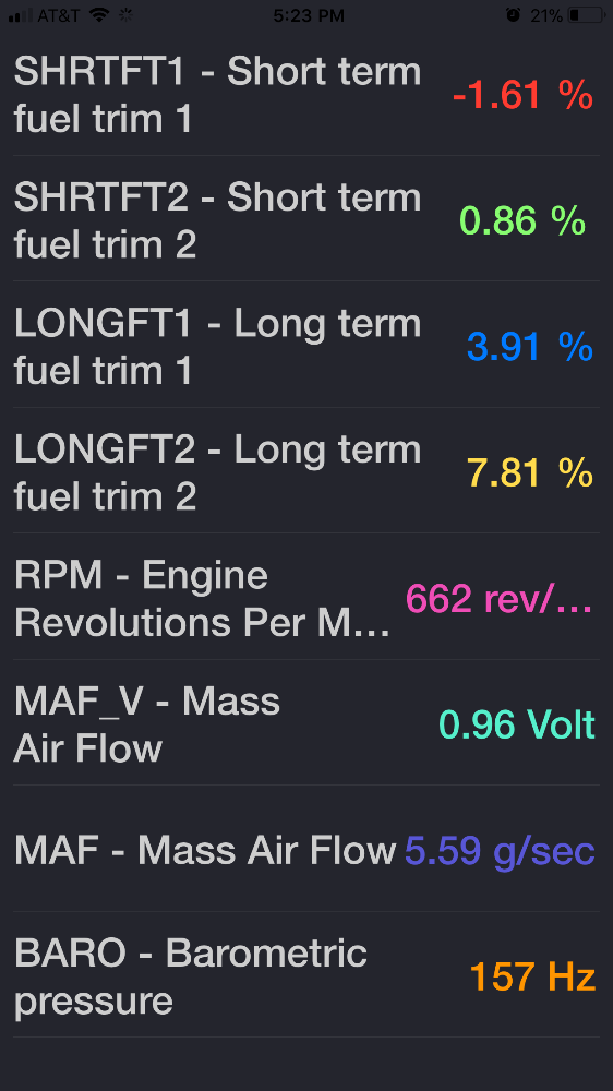

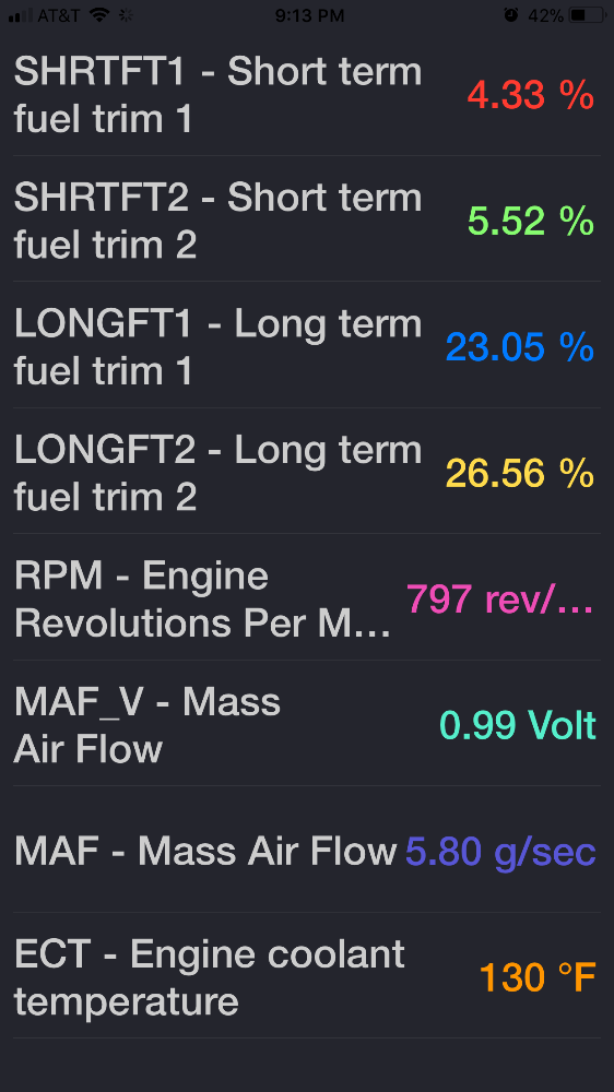

After six days of driving with a new MAF sensor from Ford and watching scan data I can confidently say its fixed! The Duralast MAF was under reporting. After all the testing methods I've done, the last being the injector balance test, MAF had to be the culprit skewing the fuel trims. Especially installing a new fuel pump just for the sole purpose of doing the injector balance test because of the previous bleed down issue. The injectors tested good and props to Paul for showing how to do the test from the computer since the manifold covers the injectors. I had to be $225 sure and it turned out to be correct. If there is one thing I learned is when it comes to electronics go OEM, not the Auitozone or Advance Auto parts kind.
The image below was Duralast sensor
New Ford MAF and 150 miles later engine idling
Engine D or R gear
Engine D or R gear

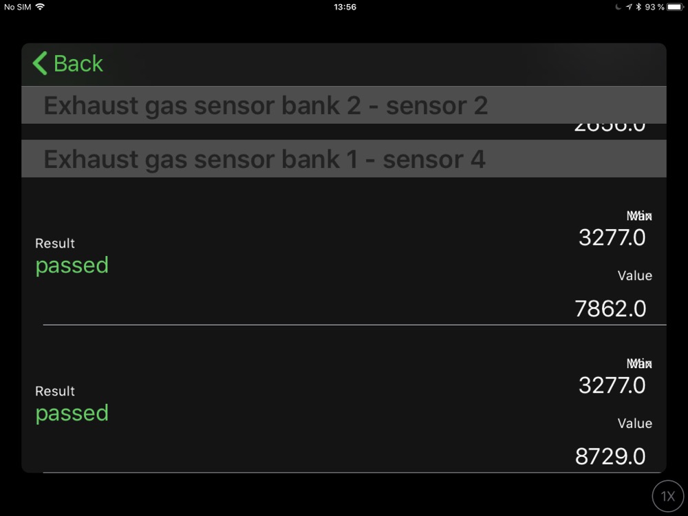

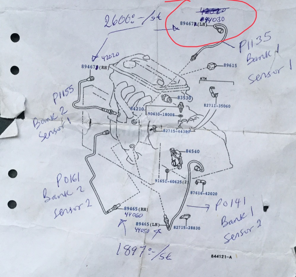

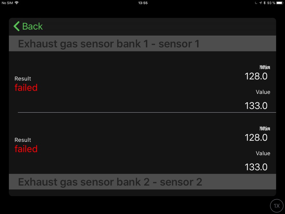

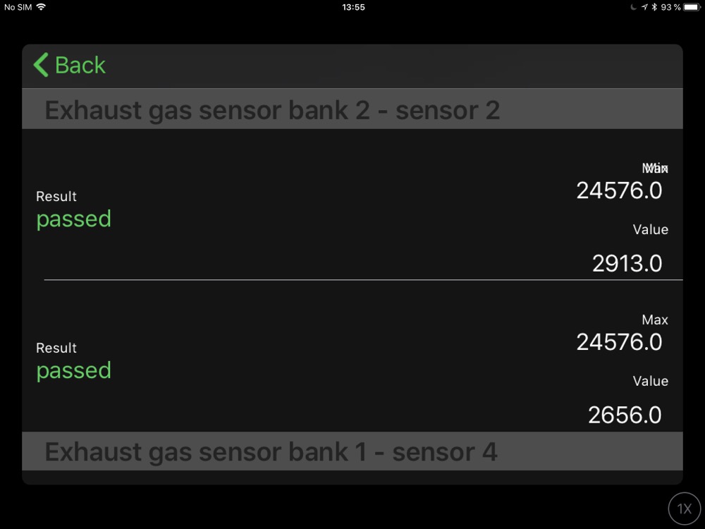

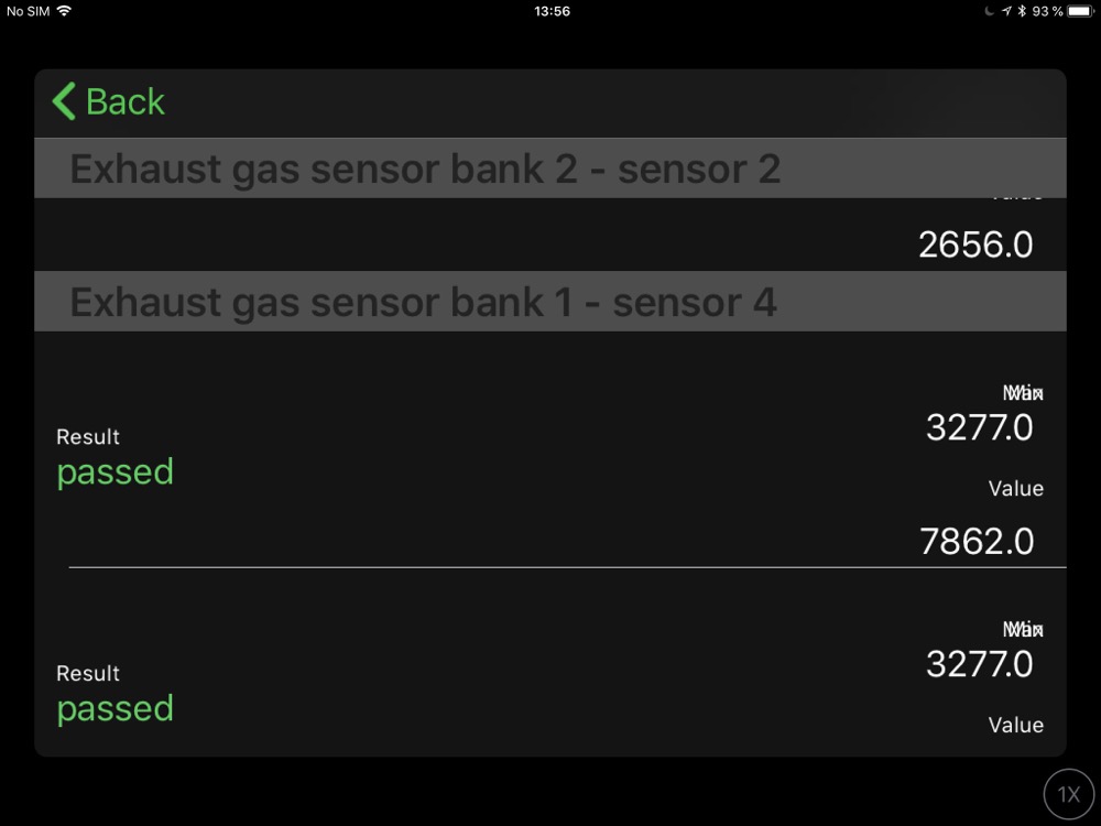

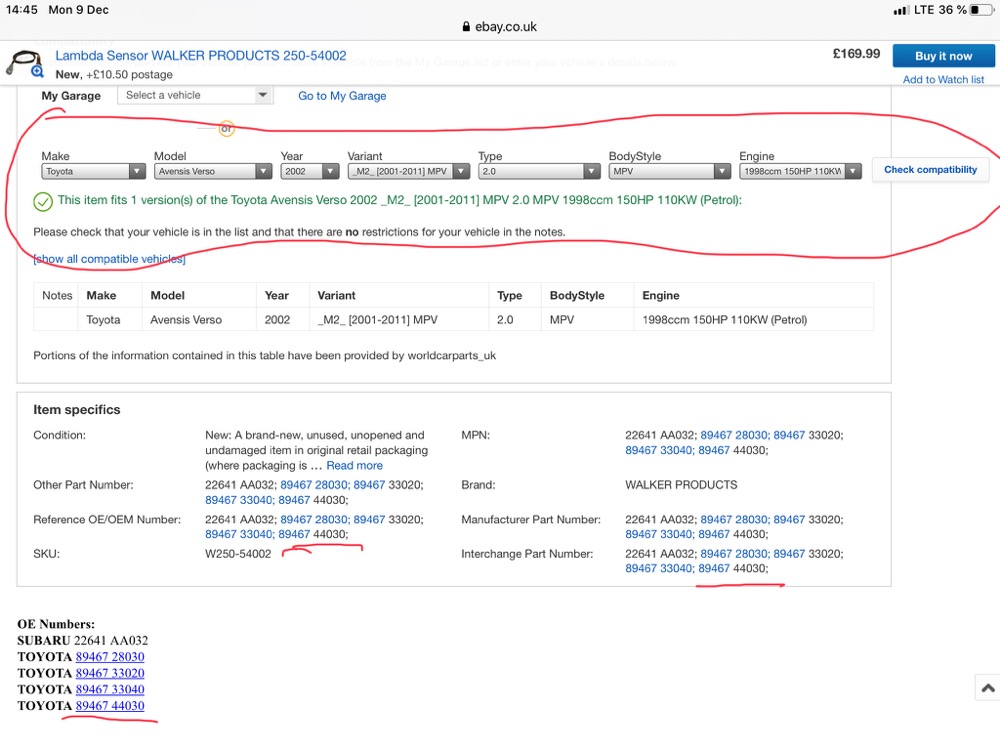

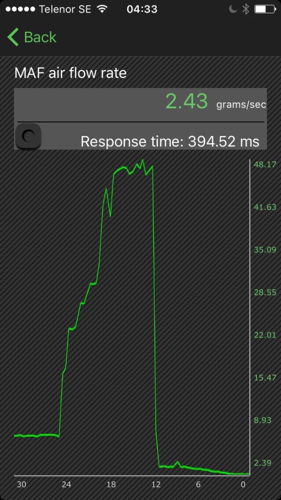

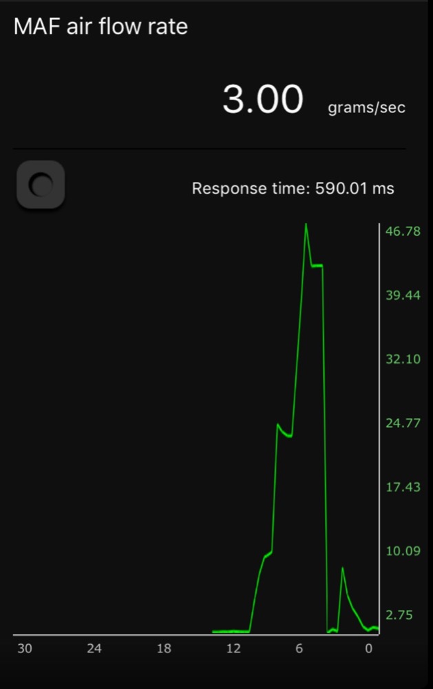

Guys I am suspecting this might be the problem with my car. I am somewhat convinced my car is suffering from air fuel improper mixture caused by either upstream oxygen sensor or MAF sensor, and Toyota company was billing me for new PCM and new CAT.
Toyota Avensis Verso 2002. When I bought this car newly I was advice by Tyler to clean the MAF, and that brought down the fuel trim significantly but unfortunately I still had drivability problems...when I fully press down the gas pedal, the car would not move or pick up fast as it should, almost like I am losing around 40% of the power of my engine capacity. This problem brought about CAT P0420&P0430 codes.
I have tried to swap my MAF with another Car’s MAF, I have used 3 aftermarket MAF also and same problem.
More background info about the car
The downstream oxygen sensors were correct, the upstream sensor on bank 2 sensor 1 was correct, but the previous owner wrongly used a Volvo sensor in the upstream bank 1 sensor 1 and then also all the 4 sensors wire were cut and re-taped which draws so much attention that the previous mechanic suspected the car’s problem was oxygen sensors related.
I bought brand new OEM upstream sensors bank 1 sensor 1 & bank 2 sensor 1. After some months I went back to the toyota dealership since the problem persisted and the guy checked their system again where they check for part numbers and cancel the part number previously written and sold to me on bank 1 sensor 1, and also Toyota seem to have different Ohms readings for the upstream sensors (1.1ohms) and (1.8ohms). It’s crazy that a big company like Toyota can engineer parts with so much confusion for its end users. They have Multiple ohms readings and multiple part numbers for the upstream sensors.
Bank 2 sensor 1 (89467-42020)
Bank 1 sensor 1 (89467-42010) **this particular one the Toyota dealership canceled it and later wrote (89467-44030) but right now I have 89467-42010 installed in the car.
I tried to check eBay.....pls see attached image
Now I need help to narrow down my problem
1. My MAF volumetric efficiency seem wack...see image showing around 48 grams/sec at WOT around 7,000RPM when it should be above 110grams/sec, and also this might be caused by a restricted exhaust.
2. See image of the OBD gas emission...note it only fails on bank 1 sensor 1 the one Toyota dealership changed the part number
3. Is my problem a MAF problem or that conflicting part number in my upstream sensor bank 1 sensor 1, what should be the right sensor and ohms readings...unfortunately this Verso is not listed in USA. Guys pls help a brother out, I don’t want to spend any more money that is not needed without knowing for sure what the underlying issue is or the correct failing part.
4. Can I do an exhaust restriction test correctly even with a bad MAF or bad upstream sensor, and what’s the bestway to do this test. I have taken out one upstream sensor before and drove without it to do the exhaust restriction test and it was same drivability problem.
****GOOD TO KNOW***** This car never had any CAT DTC’s before until immediately after I installed the upstream sensors from Toyota dealership, but the drivability loss of power problem was same before and after the installation of the new OEM upstream sensors.
