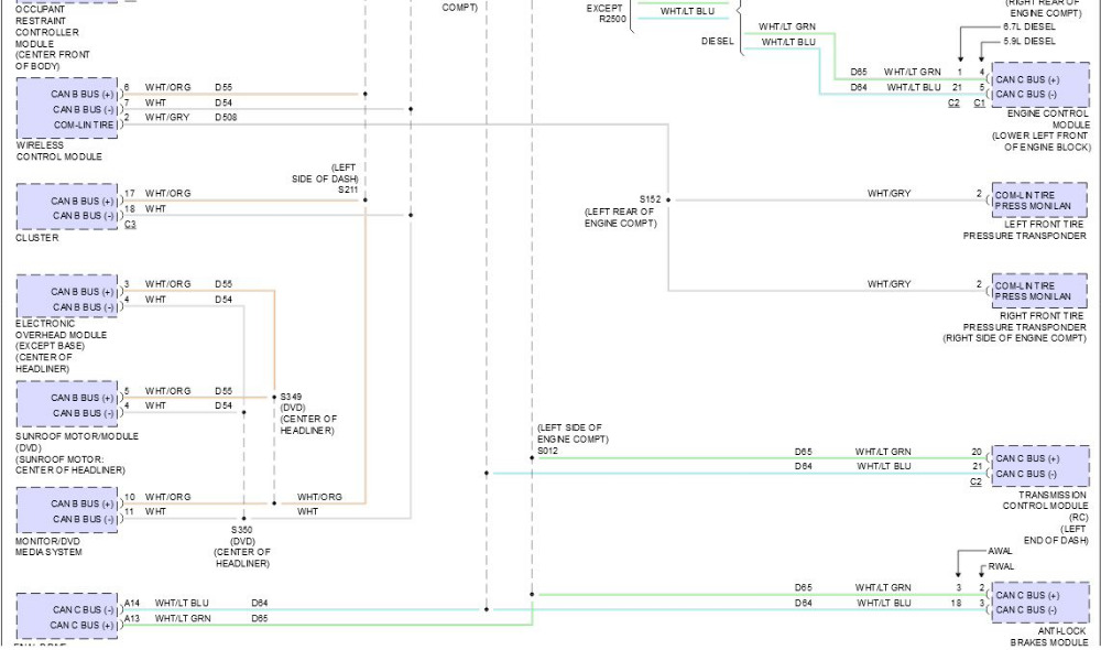

Hello to everyone, I am new to this forum and beginner fixing and diagnostics cars working hard to improve my skills and knowledge.
I have a customer complaining about no start, Stall on the hwy, turn the key off and On again no lights no start nothing completely dead.
Tow the truck to the Diesel Shop, sit there for a week and end up with: that they don't know what is wrong with the truck.
Tow the truck to my garage.
Work begins:
-Check the battery, completely dead, slow charge over the night, battery ok!
-Turn key ON, lights came on, gauges and lights pre-test pass, notice... ! that the mileage was showing but no shifting selection for the transmission was showing, first think it came up in my mind: no communication of TCM (Transmission Control Module) with BCM,IPM,TIMP,FCM(Body Control Module, Integrated Power Module, Total Integrated Module, Front Control Module) all of them they call it different or with cluster.
-Check the codes for the first time. Tool used: Lunch x431 Pro
4 Modules Have Codes. 10 Codes Total. All of them Lost Communication with modules ABS, TCM, ECM,BCM(IPM,FCM,TIPM) or Battery LOW or HIGH Voltage U0101,U0100,B210E,B210D,B2213,U0141.
Check Detailed list, the PDF file Attached Below "Diagnostic Report"
Notice that the fuse 30, 15A for ABS Module missing
Instal new fuse.
-Erased the codes and Quick Scan again:
2 Modules have codes: 5 Codes Total
ABS-Module
C2206 Vehicle Configuration Mismatch
C2202 Original VIN Mismatch/Missing
U0100 Lost Communication With ECM/PCM
U0141 Lost Communication With IPM(FCM/TIPM)
BCM-Module

-Check for voltage pin3 CanC+ ABS harness side
~2.6V I do not remember exact voltage I believe 2.57V
-Check for voltage pin18 CanC- ABS harness side
~2.5V I do not -//- -//- I believe 2.46V

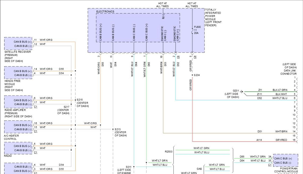

-Check for resistance circuit D65 CanC+, between Pin1-3 (TIMP Connector C6 Brown Color-ABS) and between Pin 9-18 (TIMP Connector C6 Brawn -ABS)
no resistance.
ECM-Module
-Check for reference or 5V at any ECM Outputs I chose crankshaft sensor Pin 1 since I was under the truck.
5V Present meaning the ECM is getting power and ground but anyway I checked ECM for power and ground.
-Check for powers Connector C2 Pin.49,50,60 ECM
Power O.K.
-Check for Grounds ECM Connector C2 Pin.47,48,57
Ground O.K.
-Check for resistance circuit D65 and D64 Bettwen TIMP-ECM C6-C2 Pin.1-1 and 9-21
No Resistance
-Check for voltage
ECM C2
CanC+ Pin. 1 ~2.6 V
CanC- Pin. 21 ~2.5V
Tool Used Snap On Vantage PRO
Also, I run graphing voltage meter for Circuit D65, D64 and D51, D52
D64 Bettwen TIMP C6 Pin 9 and ECM C2 Pin 21
Graphs was exactly the same for each side of circuit
D65 TIMP-ECM C6-C2 Pin 1-1

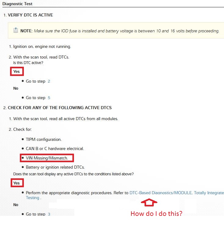

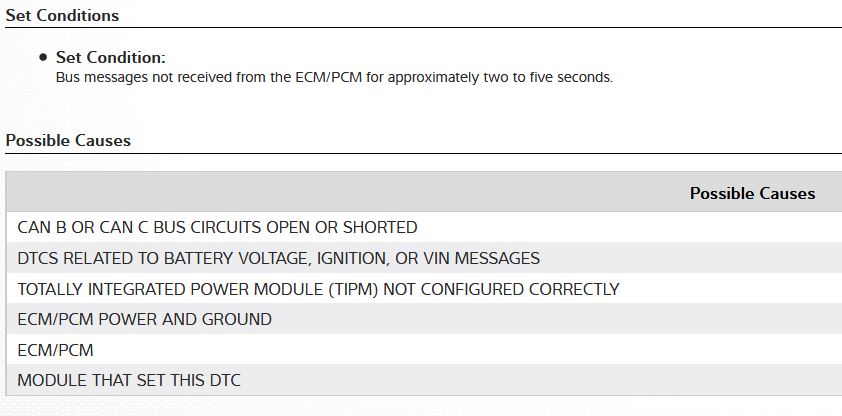

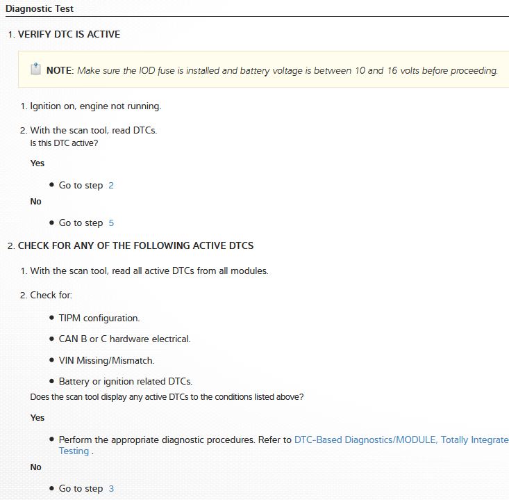

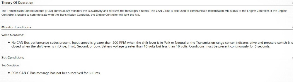

Oh, boy! You've got a good one! Loss of communication problems can be a pain in the @ss, all by themselves. The fact that someone else was there before you adds an EXTRA element of unknown.
I offer this for anyone that wants to input:

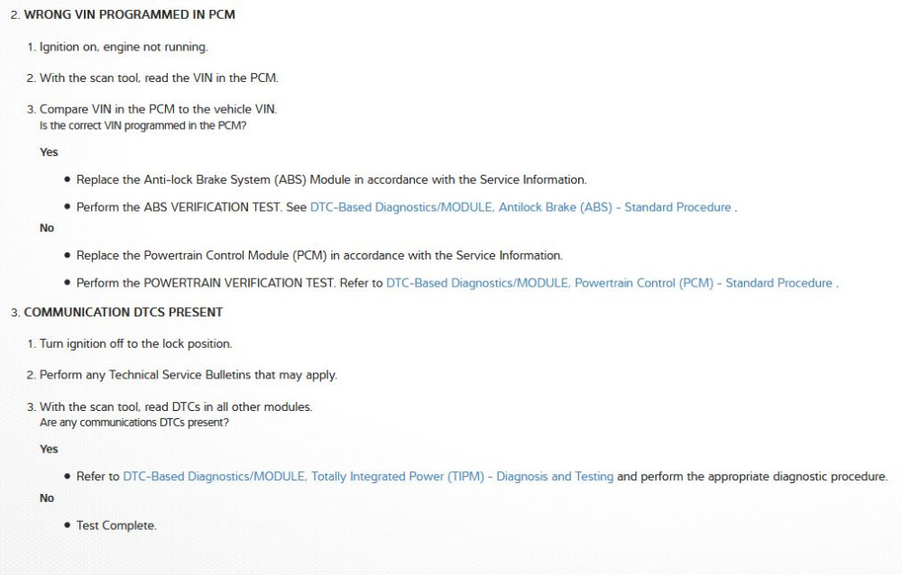

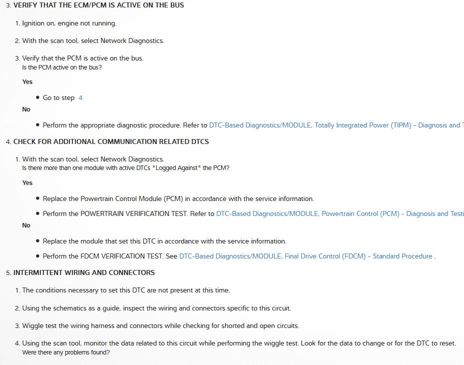

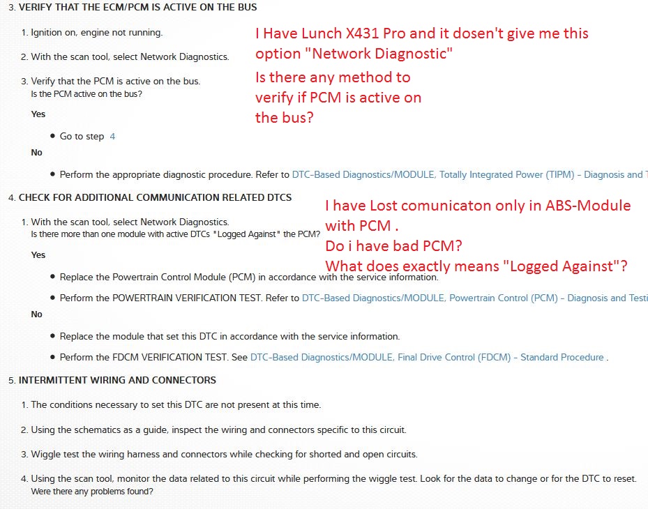

Ah yeah, gotta love it when someone else has had their hands all over a vehicle before you. :silly:
I'd argue that your TIPM is OK as far as network communication, as we know that the Diagnostic CAN C works (because you can get codes), and that you can talk to other modules on the CAN C bus. You could try communicating with the TCM for scan data to confirm this.
That 'Network Diagnostic' function is gonna be something specific to the WiTech factory scanner, so don't sweat that.
The way to tell if the PCM is active on the bus is to try to communicate with it directly. If you can't get codes or scan data out of it, then it's not active on the bus.
I know that you checked for a 5V reference, but would you be willing to try something? Disconnect the fan clutch, near the left headlight, and recheck for communication with the ECM. It's very common for the speed sensor within the clutch to short and pull the ECM down with it. If that doesn't work, thanks for indulging me!

I assume, "Logged Against" is referring to control modules that are "complaining about". For example, you ABS module has set a U0100. Also, your BCM has set a U0100. Or, possibly, it could be referring to other modules that are requesting the MIL light to be illuminated.
I'm, really, not sure.

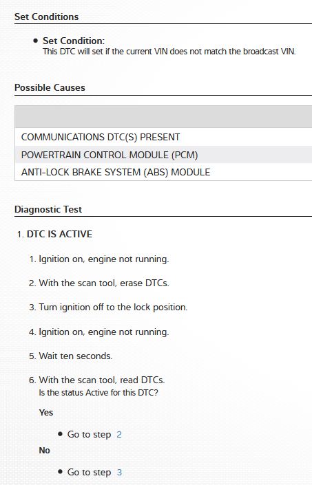

Update. So I finally pulled the trigger on a used ECM from a salvage yard. Installed the ECM and edited the VIN and transferred the security code via the immobilizer module ( skim/skreem). Truck fired right up. While waiting on the module to get delivered I finally found what I was experiencing. Here is the link.
The guy in the vid reflashed the software where as I swapped modules. Result is the same. I am also using a Launch scan tool.
Hope this helps someone out.

I've been following this thread with interest as I have been dealing with a 2007.5 Ram with the 6.7 Cummins that also had a no start, no crank issue and without communication to the PCM. Long story but I also replaced the PCM to get the truck running. I was curious if you could step through how you used the Launch scan tool for transferring the secret code to the PCM you replaced. I've got a P0633 "SKIM secret key not programmed in PCM) that I was hoping to get rid of. Thanks!

To transfer the security pin code, you actually need to know the code. Once pin is inputted you will be able to transfer security info to ECM. I forget which has the option under special functions/options section. It should be either WCM, TIPM(BCM), or Skim-Skreem.
