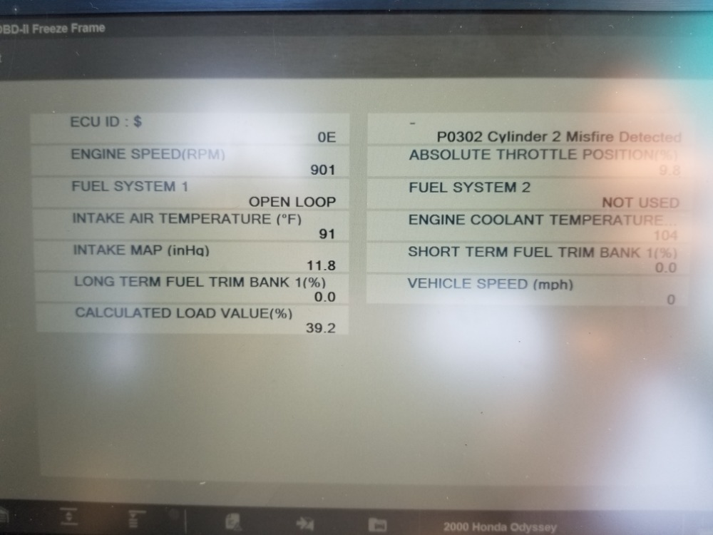

7 years 7 months ago - 7 years 7 months ago #22600 by Dtnel
Here's a freeze frame screenshot from when it initially occurred I'm thinking.
Maybe the #2 is where I need to look first.
Sent from my SM-G955U using Tapatalk
Last edit: 7 years 7 months ago by Dtnel. Reason: Added freeze frame data
7 years 7 months ago #22601 by Tyler
Dtnel wrote: The engine has a P0302, P0304, P0305. Sounds like a rock crusher.
:ohmy: Can you be more specific about the noise?
If it's dead misfiring at idle, then you stand a good chance of narrowing down the offending cylinder(s).

7 years 7 months ago #22607 by Dtnel
That's the route I'm feeling I'm going have to go. Going to pull coils for offended cylinders, check plugs. If plugs are good I'll swap a known good coil with a bad one and see if code moves.
I know how to check resistance in general but haven't did it on coils. I think the component tester should have the method is my guess given the scan tool has the component tester built in. Just need to get back in it as I was busy doing much other stuff this summer mainly volunteer coaching Girls Fastpitch Softball which I'm doing at the school level now as our schools aren't sanctioned for softball so it's all volunteers.
Plugs, Coil, Power to coils, EGR possibly? will be the things I check and anything else I think I can find, oh and compression on all cylinders so I can document the readings in case something happens my thought is cover my butt because if given the mileage someone says you replaced this but now my engine blew and decides to try to sue me.
